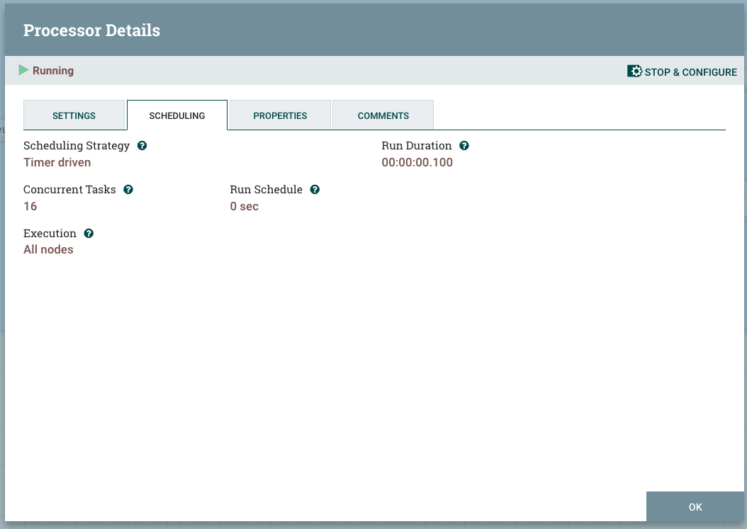

Threads
The default processor runs on a single thread, processing just one flow file at a time. If you use concurrent processing, the number of concurrent tasks that it can do can be adjusted. Set the number of threads for the process group by changing the processor Concurrent Tasks value (under Processor configuration or SCHEDULING tab).
When the processor can process flow files at the same rate as they come, the Concurrent Tasks value is ideal, preventing large pileups of flow files in the processor's wait queue.
If a CPU can multitask, increasing the threads available to the processor increases the processor throughput. The transformation processor (as in NLP) and the Bulk update processor are two such examples. You can assign more threads to the processor, or set the Concurrent Tasks variable to be higher than one. Increasing the threads of the processor will result in improvement of the processor throughput. The following screenshot represents an NLP Processor which is set to sixteen concurrent tasks, equal to the number of virtual CPUs (vCPUs) that are available on the node.
This update is not useful for all processors. Most processors come with an default configuration that takes this variable into account and does not need to be altered. When performance testing reveals a bottleneck in front of the processors, the default configuration may benefit from further tuning. Because such balancing may not always be feasible, the recommended best practice is to focus on reducing the flow file pileup in the waiting queue.
Additional threads increase the processor bandwidth by the factor of the number of threads, if the processor is doing computational processing (that is, you can experience linear scaling). In the case of the I/O operations, the processor will experience some improvement that would start to diminish after certain level of threads is set (such as nonlinear scalability that would end in saturation).
In the case of the NLP Processor, the processor is purely computational, and the thread limit is considered to be the same number of vCPUs that are available for the NiFi Pod.

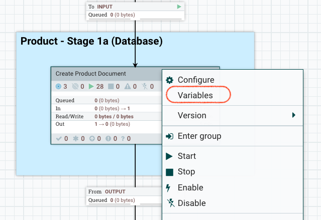

Bucket size
Bucket size (scroll.bucket.size) is another parameter you can change to improve a processor bandwidth. It changes the size of the flowfile that is processed. By increasing the bucket size you are increasing the size of data that will be processed by a single processor as a group.
Bucket size changes are a bit more difficult to implement. The location of the variable is on the second level parameters of the processor group.
For example, for DataBaseProductStage1a:
The top level appears like this:
Drill down one level, right-click on Create Product Document and select variables.

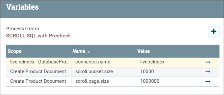

The Bucket Size is optimal when you see that the flow file is easily processed through the system (including Elasticsearch upload). Increasing the size (number of documents in the flow file) increases the throughput. However, when increased to very high size, the throughput tapers off and gradually decreases. Simultaneously, the resources requirements of the system (NiFi and Elasticsearch) increase, leading to lower throughput.
The Variables window opens. Here you can change the bucket size value.
Scroll page size (scroll.page.size)
scroll.page.size
The scroll.page.size parameter contains the number of rows fetched from database by the SQL. SQL runs several times (once with each page turn) if the retrieved row count is smaller than the total row count in the table.
When the time it takes to process the data is evenly matched with the time it takes for the next SQL scroll to receive its data, the scroll settings are optimal. This improvement eliminates needless processing and I/O time. Additional factors to consider include the memory space available in NiFi to hold the result set while parsing and splitting this into flowfiles, and the total number of flow files that would be created in NiFi at once. If the scroll page size is larger, you should expect an impact on NiFi operations. When you reach this limit, you can increase the resources allocated to NiFi, or limit the scroll page size to reduce the impact to performance.
When retrieving data from Elasticsearch, the scroll.page.size and scroll.bucket.size variables are also utilised. The SCROLL Elasticsearch processor, for example, defines the following variables:
  • The scroll.page.size is the number of documents that are fetched from Elasticsearch. If the number is too small, NiFi must make more connections to Elasticsearch.
  • The scroll.bucket.size is the number of documents included from the fetched data that are processed in each bucket. The bucket.size determines the size of the flow files (and the number of documents that are contained within each file).
