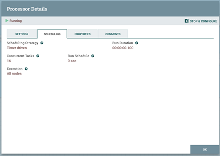

In NiFi, each processor has the capacity to process flowfiles in parallel mode. To do this, either allocate more threads to the CPU or increase the concurrent jobs variable above 1. The NLP processor in the following snapshot is configured to 16 concurrent tasks, which corresponds to the number of vCPUs available on the node.
The processor throughput will be improved by increasing the threads on the CPU. Additional threads would increase the Processor bandwidth by the factor of the number of threads, if the processor is doing computational processing (i.e. we can experience linear scaling).
In case of the I/O operations, the Processor will experience some improvement that would start to diminish after certain level of threads is set (i.e., nonlinear scalability that would end in saturation).

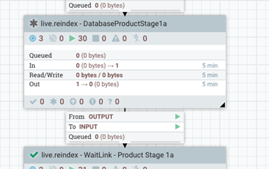

- The top level looks like this:

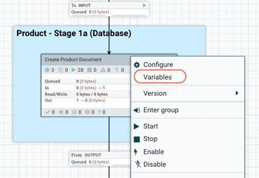

- Drill one level down, right-click, and choose "variables":

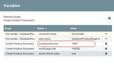

- And change the bucket size value:

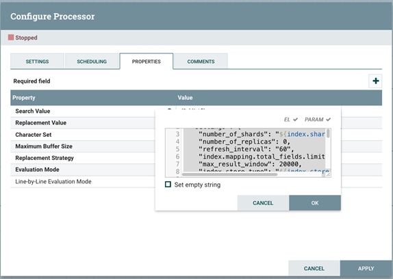

Elastic refreshes indices every second by default, but only on indices that have had one or more search requests in the previous thirty seconds. This period is set to ten seconds by default by the commerce index schema. However, if it is viable, disable it and set the period to -1 or a much longer time (for example, to a sixty second refresh interval).
To set up a custom value, follow the workflow
