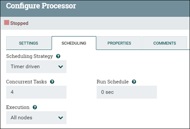

Processor thread count (Concurrent Tasks)
The default processor runs a single thread at a time, processing one flow file at a time. If concurrent processing is desired, the number of concurrent tasks that it can do can be adjusted. Set the number of threads for the process group by changing the processor Concurrent Tasks value (under Processor configuration or SCHEDULING tab).
Throughput can be improved if a CPU is able to multitask by increasing the number of threads it employs. Two such examples are the transformation processor (as in NLP) and the Bulk update processor (sends data to Elasticsearch). This update does not help every processor. Most processors come with an default configuration that takes this variable into account and does not need to be altered. When performance testing reveals a bottleneck in front of the processors, the default configuration may benefit from further tuning.
When the processor can process flow files at the same rate as they come, the Concurrent Tasks value is ideal, preventing large pileups of flow files in the processor's wait queue. Because such a balance may not always be feasible, the best configuration focuses on reducing the flow file pileup in the waiting queue.
