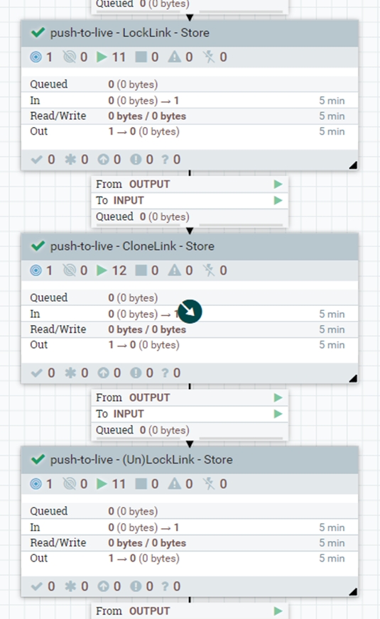

Clone Indices
  • This process group blocks the write operation on the auth index.
  • This process group releases blocked write operations from the target index.
  • This process group unblocks the write operation on the auth index.

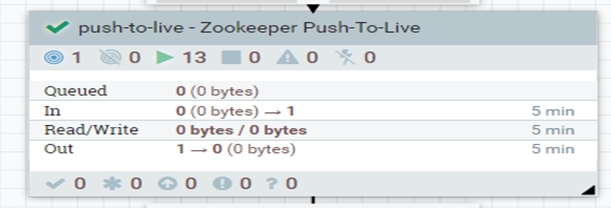

Push Zookeeper auth node to Live environment
This process group clones the Zookeeper node from auth to Live environment.

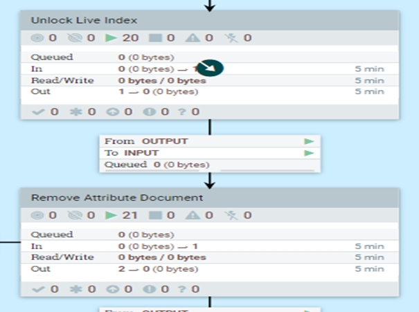

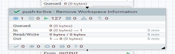

This process group removes the workspace document from the Live index.
  • This process group removes workspace specific document from Live index.

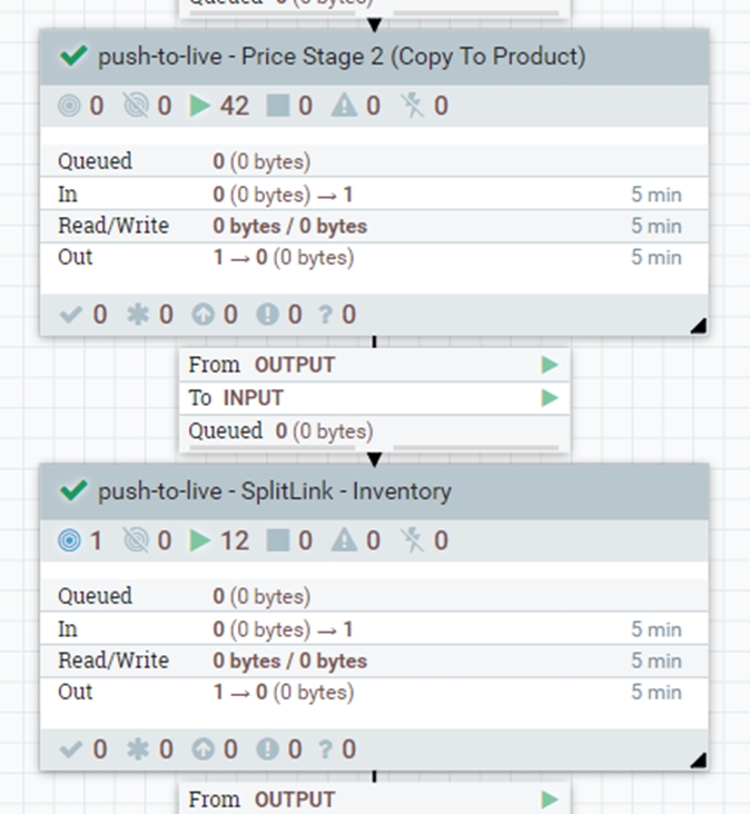

Price and Inventory
  • This process group copies the calculated price for product.
  • This process group triggers the NRT pipeline to populate the inventory of product.

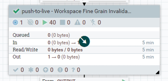

Send Fine Grain Invalidations
This process group sends invalidation for objects which were changed in the workspace context.
