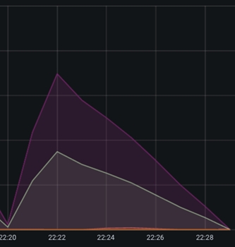

The transfer operation from NiFi to Elasticsearch is an example of a suboptimal segment that you can readily detect. This operation is usually handled by the bulk update processor, which shows up in Grafana as a rapid growth in the number of incoming documents, which then peaks, followed by a slowdown, shallow decline in the number of documents due to the transfer speed. As you can see, it looks like this:
Due to the slowdown transfer speed to Elasticsearch, you can see a shallow depletion of the documents in the queue. You can increase this speed by opening more connections to Elasticsearch and configuring more threads for the Bulk Update Processor to increase throughput.

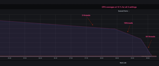

When the total number of threads is raised, the following graph represents what happens on the system:
When the Bulk Update Processor is configured with only three threads, the initial configuration shows a very shallow depletion of the documents. When configured with 16 threads, the ramp-down angle increases significantly, and when configured with 64 threads, it improves even more. The important distinction is that increasing the number of threads in this processor increases the number of HTTP connections opened from NiFi to Elasticsearch, while the resulting CPU utilisation remains almost unchanged.

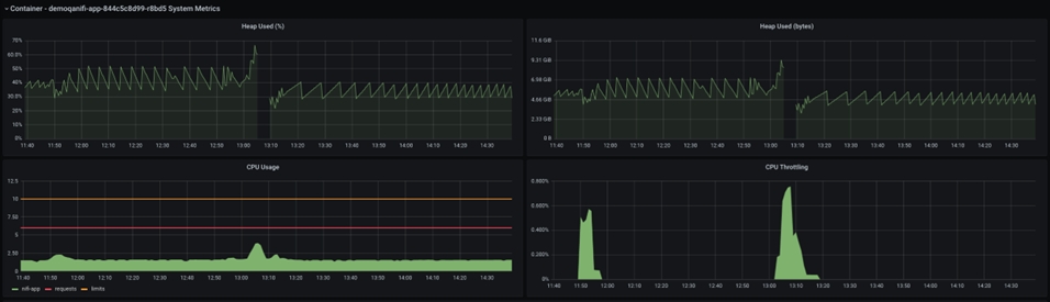

The Java heap size is seen in the graph above. The brief pause in the middle of the graph reflects the NiFi pod crashing and restarting. If you observe the CPU before the crash, you can see that the CPU utilisation spikes, but the heap size never reaches 100%, instead staying around 70%, which is a reasonable heap size.

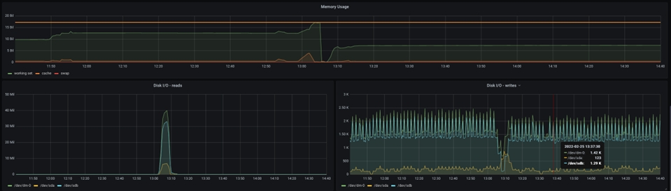

However, the below graph shows a totally different picture:
The total memory assigned to the Pod can be seen here, and you can see that the requested Memory is reaching the maximum allocated memory at the time of the NiFi JVM's crash. As a result, more Memory must be allocated to accommodate larger bucket size.

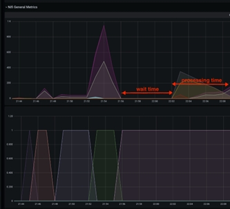

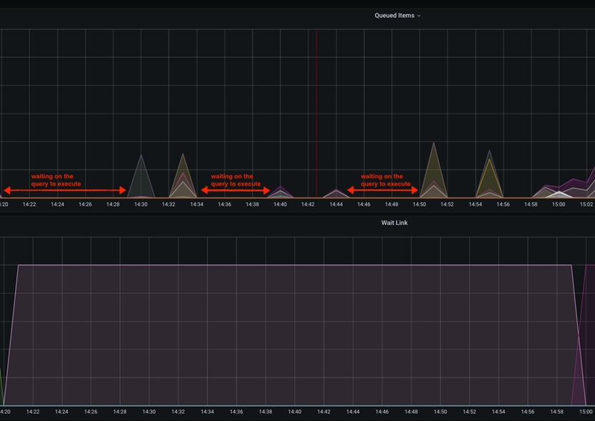

In this particular case, the slowdown are going to be visible within the Grafana graphs as idle time between the queued item’s peaks. This happens when the scroll.size parameter is configured to be relatively low compared to the total size of the database table that is being accessed. The scroll.size should ideally match the processing time, where the database query time should be equal to the NiFi processing time of the extracted data. However, in special cases where the SQL runs longer then the NiFi processing, you could observe this as short peaks in the queried items graph, spaced apart by flat/idle line.
This idle time between the fetches of the database data could be mitigated by increasing the scroll.page.size value to higher number. For example if the database has total of 1 M catalog items, and the scroll.page.size is set to 100000 items, the whole process involves 10 iterations. This indicates that the items in the queue have 10 spikes, with idle time intervals. You can reduce the wait time by 50% by increasing scroll.page.size to 200000, thereby reducing the cycles to 5 cycles. You should set scroll.page.size to 1M so that the whole data can be retrieved in one cycle and only one idle period for the processing phase is observed.The following graph shows one such case:
