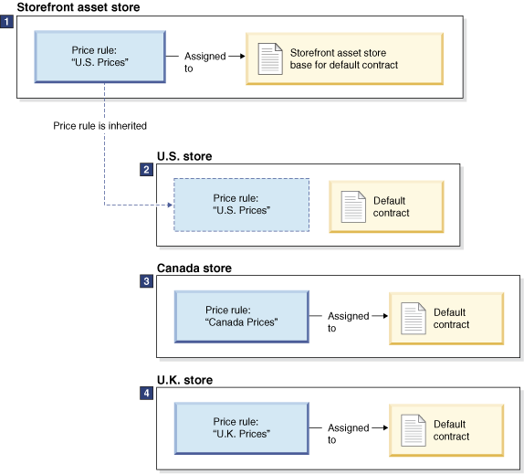

To achieve her pricing goals, the pricing manager creates a series of price rules and assigns them to store contracts as required, as shown in the following diagram:
Extended sites using price rules
  • 1 Storefront Asset Store
    The pricing manager creates a simple price rule called U.S. Prices and assigns it to the storefront asset store base for default contract. Any extended site stores that refer to this contract and do not have their own price rule will inherit this U.S. Prices price rule. This price rule uses data from an existing U.S. Cost price list, marks up the price by 20%, and then rounds up the price to the nearest .99 cents.
    The U.S. Prices price rule looks like this:
    Price rule for storefront asset store
  • 2 U.S. Store
    The U.S. store inherits the U.S. Prices price rule from the storefront asset store. This is because the U.S. store default contract:
    • Refers to the storefront asset store base for default contract.
    • Does not have its own price rule assigned.
    When customers view catalog entries on the U.S. store, the U.S. Prices price rule sets the prices they see.
  • 3 Canada Store
    The pricing manager needs to charge more for products on the Canada store. This means the default contract for the Canada store must be assigned its own price rule, rather than inheriting the U.S. Prices price rule from the storefront asset store. To calculate Canadian prices, the pricing manager wants to use the price output from the U.S. Prices price rule as a starting point. To do so, she can nest the U.S. Prices price rule within a new Canada Prices price rule. This way, any changes she makes to the U.S. Prices price rule will automatically apply to the Canada Prices price rule. She can then perform additional calculations in the Canada Prices price rule to mark up the price further.

  • 4 U.K. Store
    The pricing manager wants to manage prices for the U.K. store in a separate price list, U.K. Offer Price. To do so, she creates a price rule that displays the price from the U.K. Offer Price price list as is. She then assigns the U.K. Prices price rule to the default contract for the U.K. store. When customers view catalog entries on the U.K. store, the U.K. Prices price rule sets the prices they see.
