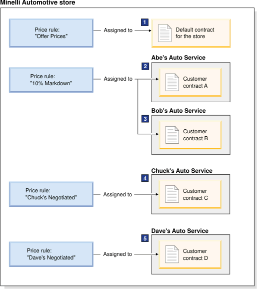

To achieve his pricing goals, the pricing manager creates a series of price rules and assigns them to the default contract for the store, and to various customer contracts, as shown in the following diagram:
B2B site using price rules
  • 1 Default contract for the store
    For the store's default contract, the pricing manager creates and assigns a simple price rule called Offer Prices. On the storefront, this price rule displays the price from the Offer Price list as is. Guest and unregistered customers see these prices.

  • 2 Abe's Auto Service
    To provide Abe's buyers with 10% off the Offer Price list for everything in the catalog, the pricing manager creates a new price rule. He knows he can reuse this price rule for other customers, so he gives the price rule a generic name: 10% Markdown. He assigns the price rule to Abe's contract. As a result, buyers from Abe's Auto Service see prices calculated from this price rule on the storefront.

  • 3 Bob's Auto Service
    To provide Bob's buyers with the same prices as Abe's buyers, the pricing manager assigns the 10% Markdown price rule to Bob's contract. This is the same price rule assigned to Abe's contract. As a result, buyers from Bob's Auto Service see prices calculated from the 10% Markdown price rule on the storefront.
  • 4 Chuck's Auto Service
    The pricing manager must provide Chuck's buyers with 15% off the Offer Price list with one exception: tires. For tires, the pricing manager has negotiated special prices that he maintains in a separate price list called Chuck's Tire Pricing. The pricing manager creates a new price rule called Chuck's Negotiated and assigns it to Chuck's contract. This price rule must set pricing differently, depending on whether the buyer is viewing:

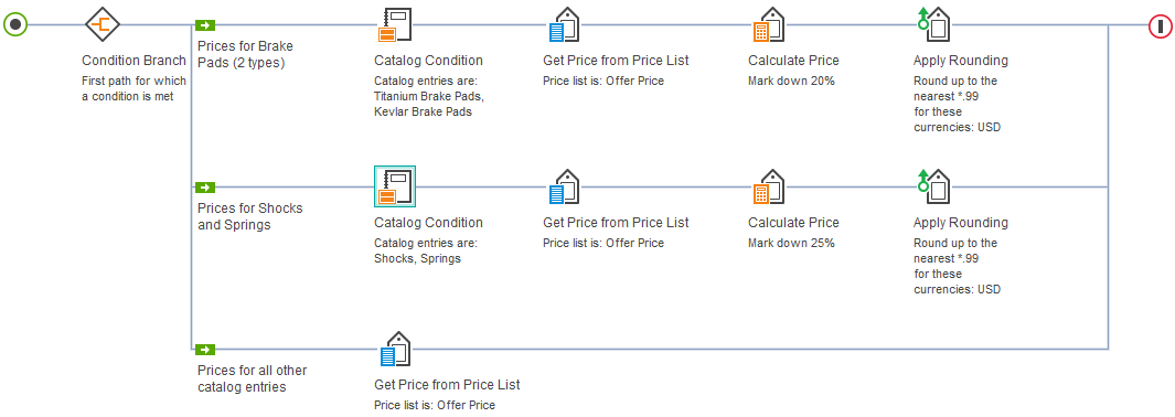

  • 5 Dave's Auto Service
    To manage pricing for Dave's Auto Service, the price manager creates a new price rule called Dave's Negotiated and assigns it to Dave's contract. Dave has negotiated pricing for certain parts of the catalog, but not for others:
    • For Titanium Brake Pads or Kevlar Brake Pads, Dave gets 20% off the Offer Price list.
    • For catalog entries from either the Shocks or the Springs category, Dave gets 25% off the Offer Price list.
    • For all other catalog entries in the catalog, Dave gets the price from the Offer Price list.
    To address these three conditions, the pricing manager uses a Condition Branch in the price rule to create three paths:
    • The first path sets prices for the two brake pad catalog entries.
    • The second path sets prices for the Shocks and Springs categories.
    • The third path sets prices for all other catalog entries in the catalog.
    The Dave's Negotiated price rule looks like this:
    "Dave's Negotiated" price rule
