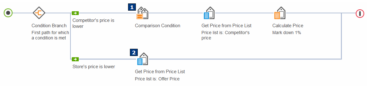

Consider the following example price rule, which compares prices in two price lists. The pricing manager maintains the store's prices in the Offer Price list, and his competitor's prices in a Competitor's Price list. For each catalog entry that the price rule handles:
  1. If the Competitor's Price is lower than the store's Offer Price, the pricing manager wants to sell the catalog entry at the Competitor's Price marked down by 1%.
  2. If the store's Offer Price is lower, the pricing manager wants to sell the catalog entry at that price.
To set prices differently for these two conditions, this price rule requires a Condition Branch with two paths:
Figure 1.
Example 1: A price rule using the Comparison Condition
When a customer views a catalog entry on the storefront, the price rule works like this:
  • 1 The price rule compares the values defined in the Comparison Condition element on path 1:
    • If the condition requirement is met, then the price rule uses the actions on path 1 to set the price of the catalog entry. In this example, if the value from the Competitor's Price list is lower than the value from the stores's Offer Price list, then the price of the catalog entry is the value from the Competitor's Price list marked down by 1%.
    • If the condition requirement is not met, the price rule ignores path 1 and continues to path 2.
  • 2 On path 2, there is no Comparison Condition element. Therefore, this path sets the price of all other catalog entries that this price rule handles. In this example, the price is pulled from the Offer Price list.
