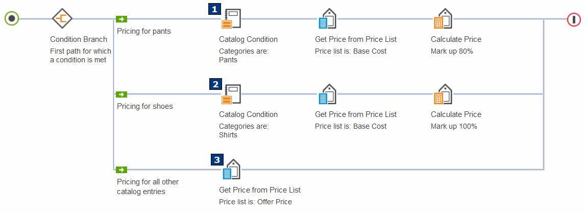

Consider the following example price rule for an office supply store. In this price rule, the pricing manager wants to:
  1. Price pants by marking up prices from a Base Cost price list by 80%
  2. Price shirts by marking up prices from the same Base Cost price list by 100%
  3. Price all other catalog entries in the catalog by using the Offer Price list
To set prices differently for these three catalog conditions, this price rule requires a Condition Branch with three paths:
Example 1: A price rule that uses the Catalog Condition
When a customer views a catalog entry on the storefront, the price rule works like the following process:
  • 1 The price rule checks the catalog entry against the Catalog Condition element on path 1:
    • If the catalog entry meets the condition, then the price rule uses the actions on path 1 to determine the price of the catalog entry. In this example, if the catalog entry is a pant, then its price is the Base Cost marked up by 80%.
    • If the catalog entry does not meet the condition, the price rule ignores path 1 and continues to path 2.
  • 2 The price rule checks the catalog entry against the Catalog Condition element on path 2:
    • If the catalog entry meets the condition, then the price rule uses the actions on path 2 to determine the price of the catalog entry. In this example, if the catalog entry is a shirt, then its price is the Base Cost marked up by 100%.
    • If the catalog entry does not meet the condition, the price rule ignores path 2 and continues to path 3, the bottom path.
  • 3 On path 3, there is no Catalog Condition element. Therefore, this path sets prices for all other catalog entries that this price rule handles. In this example, if the catalog entry is anything other than a pant or a shirt, then its price is the Offer Price.

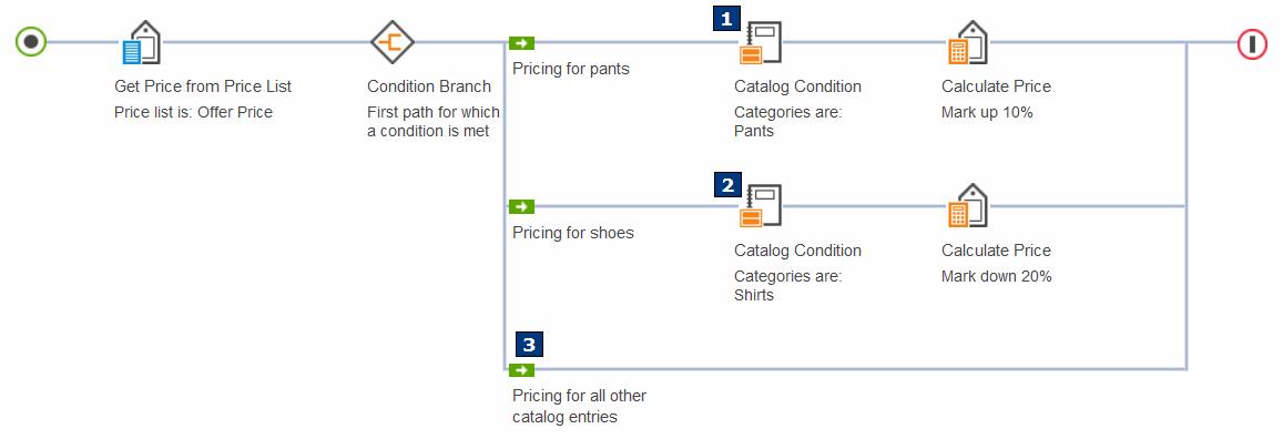

    Some paths might not require an action. Consider the following example of a valid price rule. Here, the Get Price from Price List action is placed to the left of the Condition Branch. This is because all prices in the price rule are based on the same Offer Price list; then the three paths determine what to do with the Offer Price:
    Example 2: A price rule using the Catalog Condition
    In this price rule, the actions on each path can either adjust the Offer Price, or use the Offer Price as is. Since the intent of the bottom path (3) is to use the Offer Price as is, this path does not require any additional actions.
