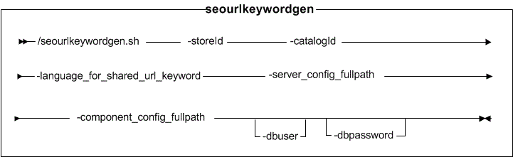

Ejemplo
utilities_root/bin/seourlkeywordgen.sh 10101 10101 -1
/WC_eardir/xml/config/wc-server.xml WC_eardir/xml/config/com.ibm.commerce.infrastructure/wc-admin-component.xml
dbuser dbpassword
