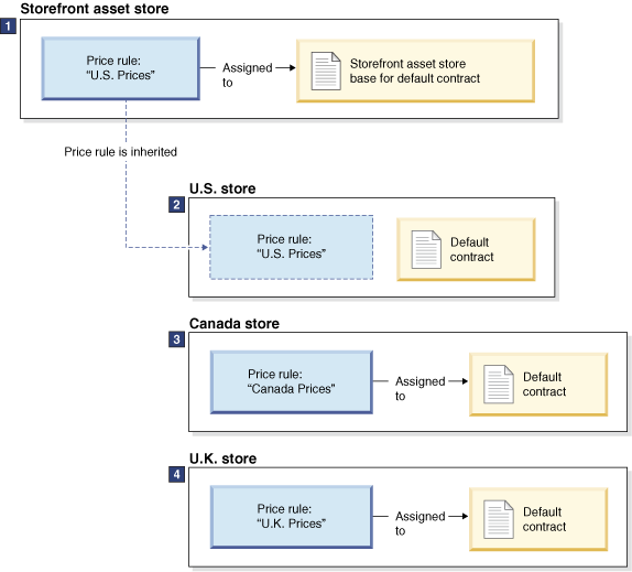

- 1 Storefront Asset Store

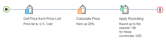

The pricing manager creates a simple price rule called U.S. Prices and assigns it to the storefront asset store base for default contract. Any extended site stores that refer to this contract and do not have their own price rule will inherit this U.S. Prices price rule. This price rule uses data from an existing U.S. Cost price list, marks up the price by 20%, and then rounds up the price to the nearest .99 cents.
The U.S. Prices price rule looks like this:
- 2 U.S. StoreThe U.S. store inherits the U.S. Prices price rule from the storefront asset store. This is because the U.S. store default contract:
- Refers to the storefront asset store base for default contract.
- Does not have its own price rule assigned.
- 3 Canada Store

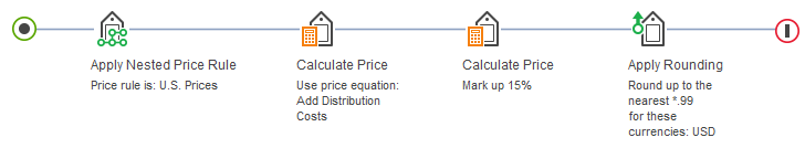

The pricing manager needs to charge more for products on the Canada store. This means the default contract for the Canada store must be assigned its own price rule, rather than inheriting the U.S. Prices price rule from the storefront asset store. To calculate Canadian prices, the pricing manager wants to use the price output from the U.S. Prices price rule as a starting point. To do so, she can nest the U.S. Prices price rule within a new Canada Prices price rule. This way, any changes she makes to the U.S. Prices price rule will automatically apply to the Canada Prices price rule. She can then perform additional calculations in the Canada Prices price rule to mark up the price further.
The Canada Prices price rule looks like this:
The actions used in this price rule work like this:Apply Nested Price Rule Calculates a price using the U.S. Prices price rule. This price is passed in as input to the next action in the price rule. Calculate Price Adds the amount from a Distribution Cost price list to the price passed in from the U.S. Prices price rule. The pricing manager maintains this Distribution Cost price list to track the extra costs of selling electronics in Canada. The Calculate Price action references the following dependent price equation that the pricing manager created:
Calculate Price Marks up the price output from the previous action by 15%. Apply Rounding Rounds up the calculated price so that the price ends with ".99" Note: Notice that the U.S. Prices price rule that is nested on this path also contains an Apply Rounding action. In this case, to avoid rounding the same price multiple times, WebSphere Commerce does not apply the Apply Rounding action in the nested price rule.
- 4 U.K. Store
The pricing manager wants to manage prices for the U.K. store in a separate price list, U.K. Offer Price. To do so, she creates a price rule that displays the price from the U.K. Offer Price price list as is. She then assigns the U.K. Prices price rule to the default contract for the U.K. store. When customers view catalog entries on the U.K. store, the U.K. Prices price rule sets the prices they see.
