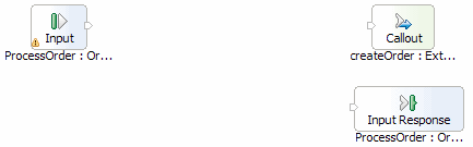

- In the Operation connections section of the Mediation Flow Editor, navigate to the ExtOMSSimMediationModule view.
Select . At the bottom of the view, the empty mediation flow diagram for Request:
ProcessOrder is displayed:

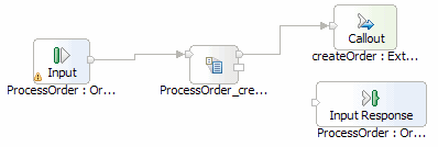

- In the mediation flow diagram, right-click a blank spot and select . An XSL Transformation primitive named XSLTransformation1 is added to the mediation flow diagram.
- Select the Properties tab.
- In the Properties view, change the name of the XSL Transformation primitive to ProcessOrder_createOrderRequest.
Navigate your mouse cursor over the out terminal of the ProcessOrder :
OrderServicesPortType input node and drag it to the in terminal of the
ProcessOrder_createOrderRequest primitive. A connection between the out
terminal of the ProcessOrder : OrderServicesPortType input node and the in
terminal of the ProcessOrder_createOrderRequest XSL Transformation primitive connection is
created.
Repeat the connection process in step 6 to connect the following terminals:
Terminal connections to create From To ProcessOrder_createOrderRequest – out createOrder : ExtOMSSimPartner – in

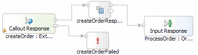

- In the Mediation Flow Editor, select the Response: ProcessOrder tab to open its empty mediation flow diagram.
- In the Properties view, change the name of the XSL Transformation primitive to createOrderResponse_AcknowledgeOrder.
Terminal connections to create From To createOrder : ExtOMSSimPartner – out createOrderResponse_AcknowledgeOrder – in createOrderResponse_AcknowledgeOrder – out ProcessOrder : OrderServicesPortType – in
- Double-click the ProcessOrder_createOrderRequest XSL Transformation primitive to create the XML Map and click Finish. This opens the XML Map Editor.
- In the XML Map, repeat the connection process in steps 9 through 18 to create a custom transformation between the body elements using the custom XSL file.
- In the Response: ProcessOrder mediation flow diagram, right-click a blank spot and select .
- Change the name of the Fail primitive to createOrderFailed.
Connect the fail terminal of the createOrder : ExtOMSSimPartner callout
response node to the in terminal of the ProcessOrder : OrderServicesPortType
input response node:
