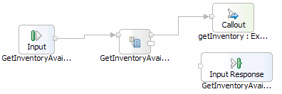

- In the mediation flow diagram for Request: GetInventoryAvailability, add an XSL Transformation primitive named GetInventoryAvailability_getInventoryRequest.
Connect the following terminals:
Terminal connections to create From To GetInventoryAvailability : InventoryServicesPortType – out GetInventoryAvailability_getInventoryRequest – in GetInventoryAvailability_getInventoryRequest – out getInventory : ExtOMSSimPartner – in
- Create the XML Map for the GetInventoryAvailability_getInventoryRequest XSL Transformation primitive.
In the XML Map, create a custom transformation between the body elements using the custom XSL file.
- Select the BodyToBody template and select body as the value of the body parameter.
- Select .
- Close the XML Map Editor.

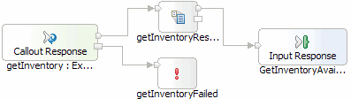

- In the mediation flow diagram for Response: GetInventoryAvailability, add an XSL Transformation primitive named getInventoryResponse_ShowInventoryAvailability.
Add a Fail primitive named getInventoryFailed and connect the following
terminals:
Terminal connections to create From To getInventory : ExtOMSSimPartner – out getInventoryResponse_ShowInventoryAvailability – in getInventoryResponse_ShowInventoryAvailability – out GetInventoryAvailability : InventoryServicesPortType – in getInventory : ExtOMSSimPartner – fail getInventoryFailed – in
- Create the XML Map for the getInventoryResponse_ShowInventoryAvailability XSL Transformation primitive.
- Select .
