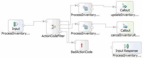

- In the mediation flow diagram for Request: ProcessInventoryRequirement, right-click a blank spot and select Add > Message Filter to add a Message Filter primitive.
- Change the name of the Message Filter primitive to ActionCodeFilter.
- In the Properties view, select the Terminal tab.
- Select the match1 output terminal and change the terminal name to ReserveInventory.

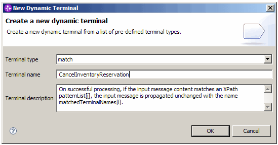

- Right-click Output terminal and select Add Output Terminal.
- Change the terminal name to CancelInventoryReservation and
click OK:
- Add the following primitives:
Primitive names and types to add Name Type ProcessInventoryRequirement_updateInventoryReservationsRequest XSL Transformation ProcessInventoryRequirement_cancelInventoryReservationsRequest XSL Transformation BadActionCode Fail - Connect the following terminals:
Terminal connections to create From To ProcessInventoryRequirement : InventoryServicesPortType – out ActionCodeFilter – in ActionCodeFilter – ReserveInventory ProcessInventoryRequirement_updateInventoryReservationsRequest – in ActionCodeFilter – CancelInventoryReservation ProcessInventoryRequirement_cancelInventoryReservationsRequest – in ActionCodeFilter – default BadActionCode – in ActionCodeFilter – fail BadActionCode – in ProcessInventoryRequirement_updateInventoryReservationsRequest – out updateInventoryReservations : ExtOMSSimPartner – in ProcessInventoryRequirement_cancelInventoryReservationsRequest – out cancelInventoryReservations : ExtOMSSimPartner – in
- Select the ActionCodeFilter Message Filter primitive.
- In the Properties view, select the Details tab and click Add.
- Enter the following patterns and terminal names and click Finish after
entering each pattern and terminal name:
Patterns and terminal names to enter Pattern Terminal name /body/ProcessInventoryRequirement/DataArea/Process/ActionCriteria[1]/ActionExpression[1]/@actionCode='ReserveInventory' ReserveInventory /body/ProcessInventoryRequirement/DataArea/Process/ActionCriteria[1]/ActionExpression[1]/@actionCode='CancelInventoryReservation' CancelInventoryReservation - Create the XML Map for the ProcessInventoryRequirement_cancelInventoryReservationsRequest XSL Transformation primitive.
- In the XML Map, create a custom transformation between
the body elements using the custom ExtOMSSimMediationModule > xslt > custom > ProcessInventoryRequirement_cancelInventoryReservationsRequest.xsl XSL file.
- Select the BodyToBody template and select body as the value of the body parameter.
- Select File > Save.
- Close the XML Map Editor.

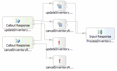

- In the mediation flow diagram for Response: ProcessInventoryRequirement,
add the following primitives:
Primitive names and types to add Name Type updateInventoryReservationsResponse_AcknowledgeInventoryRequirement XSL Transformation cancelInventoryReservationsResponse_AcknowledgeInventoryRequirement XSL Transformation updateInventoryReservationsFailed Fail cancelInventoryReservationsFailed Fail - Connect the following terminals:
Terminal connections to create From To updateInventoryReservations : ExtOMSSimPartner – out updateInventoryReservationsResponse_AcknowledgeInventoryRequirement – in cancelInventoryReservations : ExtOMSSimPartner – out cancelInventoryReservationsResponse_AcknowledgeInventoryRequirement – in updateInventoryReservationsResponse_AcknowledgeInventoryRequirement – out ProcessInventoryRequirement : InventoryServicesPortType – in cancelInventoryReservationsResponse_AcknowledgeInventoryRequirement – out ProcessInventoryRequirement : InventoryServicesPortType – in
- Create the XML Map for the updateInventoryReservationsResponse_AcknowledgeInventoryRequirement XSL Transformation primitive.
the body elements using the custom ExtOMSSimMediationModule > xslt > custom > updateInventoryReservationsResponse_AcknowledgeInventoryRequirement.xsl XSL file.
- Create the XML Map for the cancelInventoryReservationsResponse_AcknowledgeInventoryRequirement primitive.
the body elements using the custom ExtOMSSimMediationModule > xslt > custom > cancelInventoryReservationsResponse_AcknowledgeInventoryRequirement.xsl XSL file.
