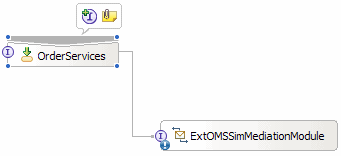

- In the ExtOMSSimMediationModule Assembly Diagram view, right-click a blank spot in the assembly diagram and select Add > Export. An export named Export1 is added to the assembly diagram.
- Select the export and select the Properties tab.
- In the Properties view, change the name of the export to OrderServices.
- In the assembly diagram, right-click the export and select Add Interface.
- Select OrderServicesPortType and click OK.
- Navigate your mouse cursor over the export's border where its connector and the Add wire tooltip are visible. Drag the connector to ExtOMSSimMediationModule.
- Click OK to confirm the action.
A connection between the export and ExtOMSSimMediationModule is created.
