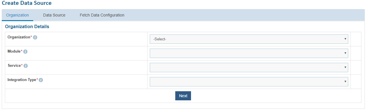

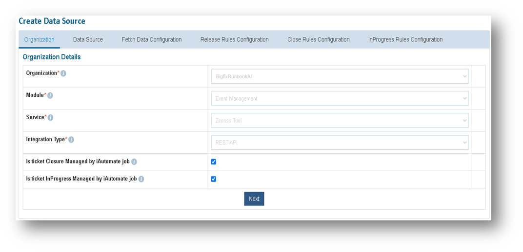

- On the Organization tab,
- Select the Organization Name from the dropdown.
- Select the Module as Event Management, since we are configuring this data source for pulling the event data.
- Select the Service as Zenoss Tool as we are configuring the data source for Zenoss
- Select the Integration Type as REST, since we will be integrating through REST APIs.
- Check Is ticket Closure Managed by BigFix Runbook AI job if you want BigFix Runbook AI to manage the issue closure updates instead of the RBA tool. In this scenario, an additional tab Close Rules Configuration will be activated for providing further details, steps for which are mentioned later.
- Check “Is ticket InProgress Managed by BigFix Runbook AI job” if you want BigFix Runbook AI to manage the issue’s in progress status updates instead of the RBA tool. In this scenario, an additional tab “InProgress Rules Configuration” will be activated for providing further details, steps for which are mentioned later.
- Click Next.

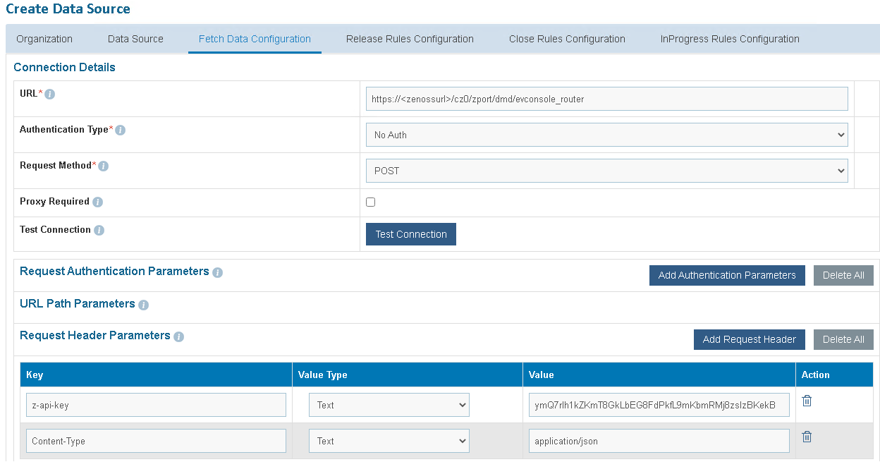

- On the Fetch Data Configuration tab, type in the details as per the environment.
- In the Connection Details section, enter the following details:
- URL – Type the URL which contains the placeholders that display the parameters based on the applied clause such as the number of records to be fetched, query type, date on which the data is fetched, and the order by and so on. It is dependent on the URL or API provided by the tool.
- Sample URL - https://<zenossURL>/cz0/zport/dmd/evconsole_router
- Authentication Type - Select one of the Authentication Types from NoAuth / Basic / Windows
- Selection of Basic / Windows requires you to enter -
- User Id
- Password
- Request Method - Select Request Method as POST from the drop-down.
- Proxy Required - Check Proxy Required, if the environment needs access to content from data sources outside the firewall.
- Click on Test Connection to check accessibility of URL from service. Testing the connection is not mandatory, you can still create Data source.
- Request Header Parameters – Please enter the request header parameters as required.

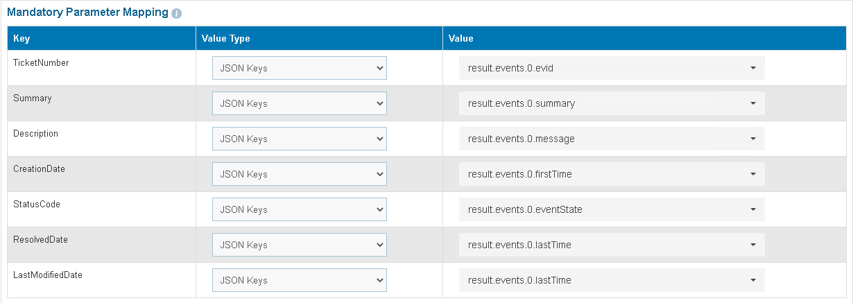

- After entering the response, click Extract Keys to add the parameters in the Mandatory Parameter Mapping section.
- Mandatory Parameter Mapping – Please map the mandatory parameters to the respective values as mentioned in the screenshot below:
| Key | Value Type | Value |
| TicketNumber | JSON.Keys | result.0.evid |
| Summary | JSON.Keys | result.events.0.summary |
| Description | JSON.Keys | result.events.0.message |
| CreationDate | JSON.Keys | result.events.0.firstTime |
| StatusCode | JSON.Keys | result.events.0.eventState |
| ResolvedDate | JSON.Keys | result.events.0.lastTime |
| LastModifiedDate | JSON.Keys | result.events.0.lastTime |

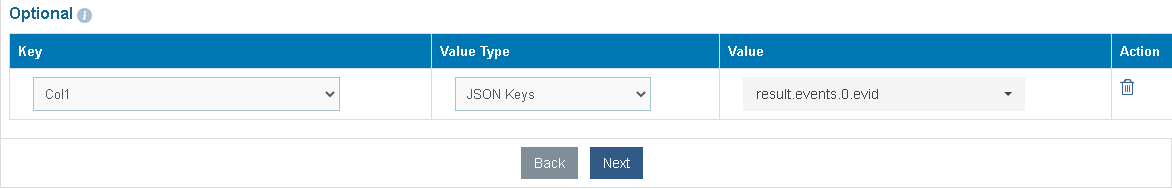

- If you need to add Optional parameters, click Add Response Parameter to add more parameters. For our purpose, we will be adding a couple of extra parameters, as mentioned below, as we need them in the later section.
| Col1 | JSON.Keys | result.0.evid |
- Click Next to proceed to Release Rules Configuration.

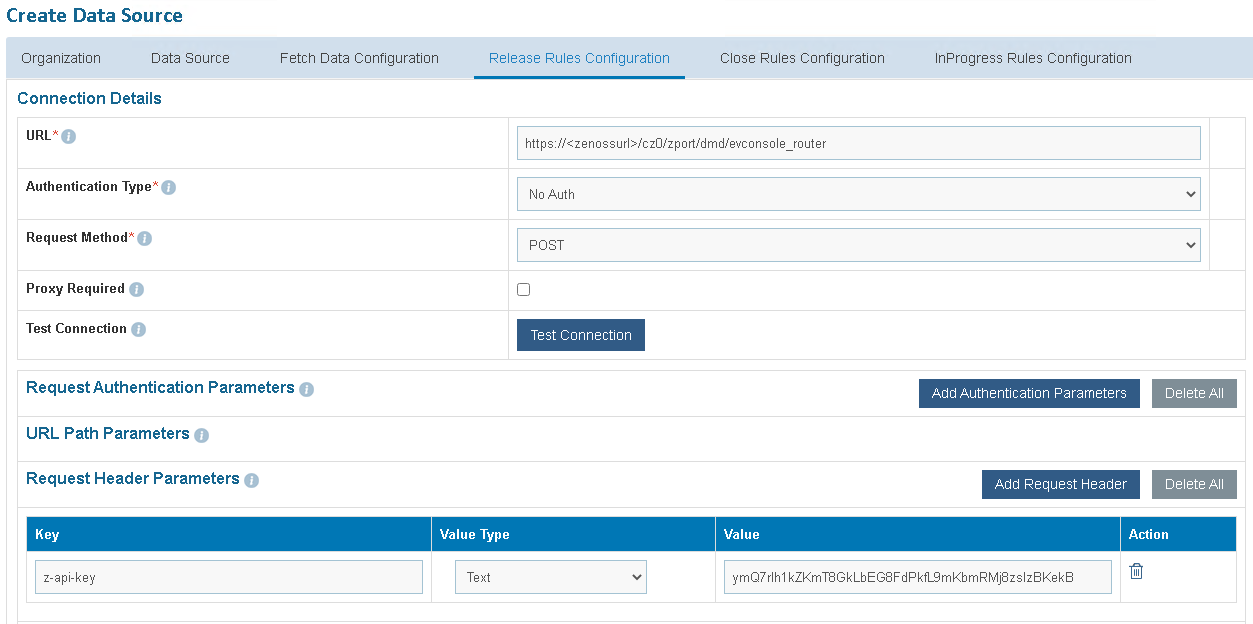

- On Release Rules Configuration tab, type in the details as per the requirement.
- URL – Type the URL of the selected service type to release the ticket. It contains the placeholders that display the parameters based on the applied clause and is dependent on the URL or API provided by the tool.
- Sample URL - https://<zenossurl>/cz0/zport/dmd/evconsole_router
- Authentication Type – Please enter the information in line with the Authentication type configured for fetching data configuration previously.
- Request Method – Select Request Method as POST from the drop-down.
- Proxy Required – Check Proxy Required, if the environment needs access to content from data sources outside the firewall.

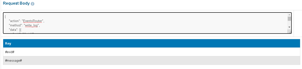

- Request Body – In this section, please enter the request body in JSON format. A sample request is mentioned below.
Request Body –
"action": "EventsRouter",
"method": "write_log",
"data": [{
"evid": "#evid#",
"message": "#message#"
}],"tid":2

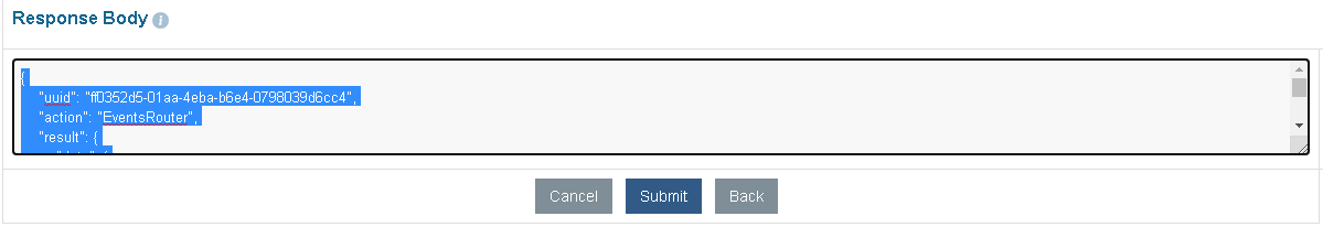

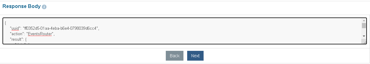

- Response Body – In this section, please enter the response body in JSON format. A sample response is mentioned below.
Response Body –
"uuid": "0fc0b53f-8fba-4aa1-a561-1fef7ecc53fb",
"result": {
"success": true
"tid": 2,
"type": "rpc",

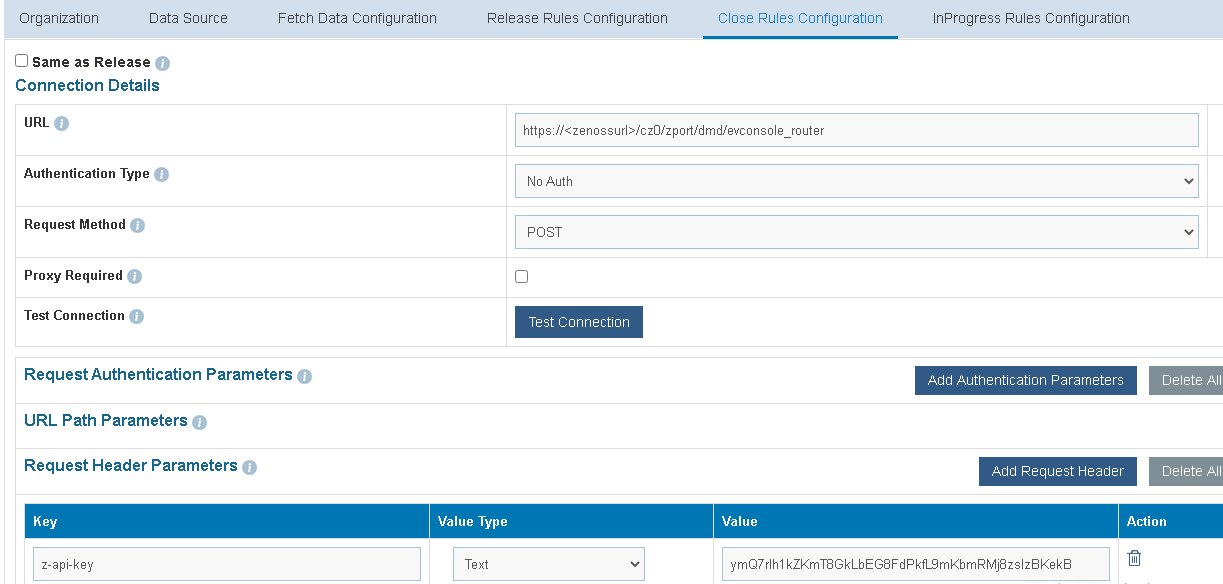

- On Close Rules Configuration tab, type in the details as per the requirement. Check Same as Release if similar configurations as mentioned in “Release Rules Configuration” are required, else proceed ahead.

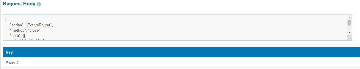

Request Body –
"method": "close",
"data": [{
"evids": "#evids#"
}],"tid":2
Response Body –
"uuid": "ff0352d5-01aa-4eba-b6e4-0798039d6cc4",
"result": {
"data": {
"updated": 31,
"total": 3670
"success": true
"tid": 2,
"type": "rpc",
"method": "acknowledge"

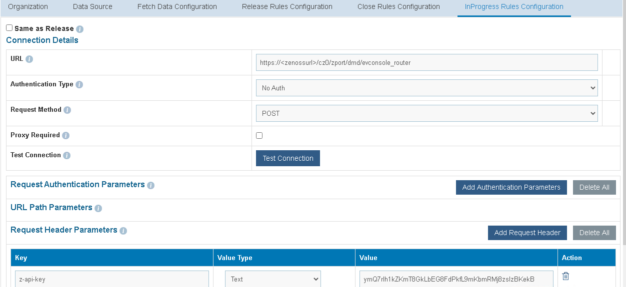

- On InProgress Rules Configuration tab, type in the details as per the requirement. Check Same as Release if similar configurations as mentioned in “Release Rules Configuration” are required, else proceed ahead.

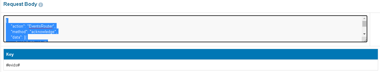

Request Body –
"method": "acknowledge",
"data": [{
"evids": "#evids#"
}],"tid":2
