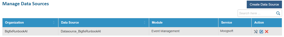

To create a data source, perform the following steps:
  • On the main menu bar, click ActionsManage Data Sources.
  • The Create Data Source page appears with the following tabs:

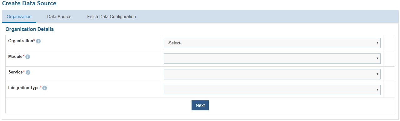

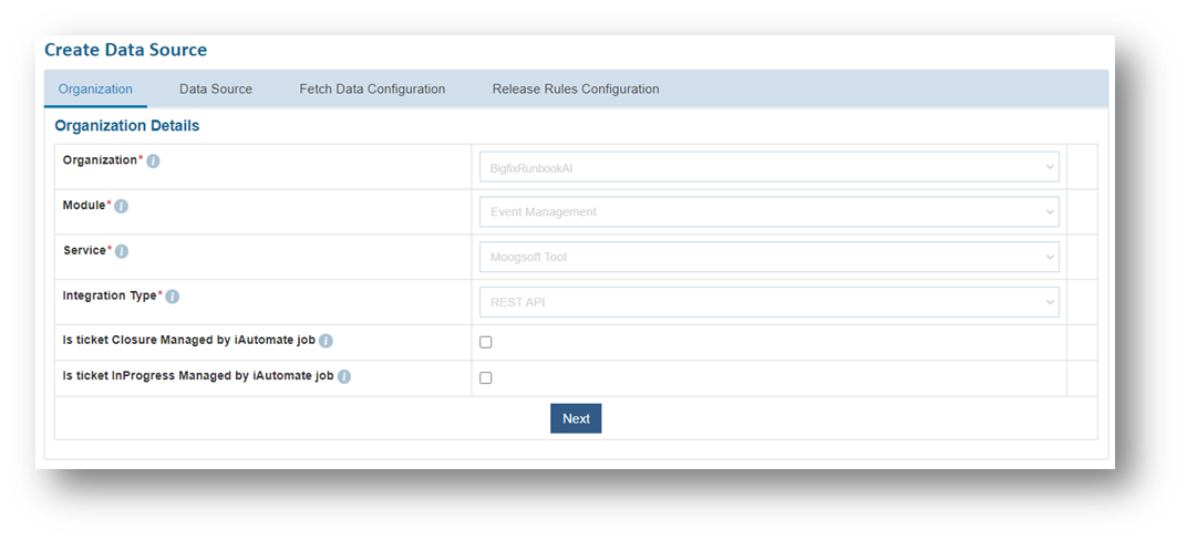

  • On the Organization tab,
  • Select the Organization Name from the dropdown.
  • Select the Module as Event Management, since we are configuring this data source for pulling the event data.
  • Select the Service as Moogsoft Tool as we are configuring the data source for Moogsoft
  • Select the Integration Type as REST, since we will be integrating through REST APIs.
  • Check Is ticket Closure Managed by BigFix Runbook AI job if you want BigFix Runbook AI to manage the ticket closure updates instead of the RBA tool. In this scenario, an additional tab Close Rules Configuration will be activated for providing further details, steps for which are mentioned later.
  • Check “Is ticket InProgress Managed by BigFix Runbook AI job” if you want BigFix Runbook AI to manage the ticket’s in progress status updates instead of the RBA tool. In this scenario, an additional tab “InProgress Rules Configuration” will be activated for providing further details, steps for which are mentioned later.
  • Click Next.
Figure 2. Figure 305 – Create Data Source (cont.)

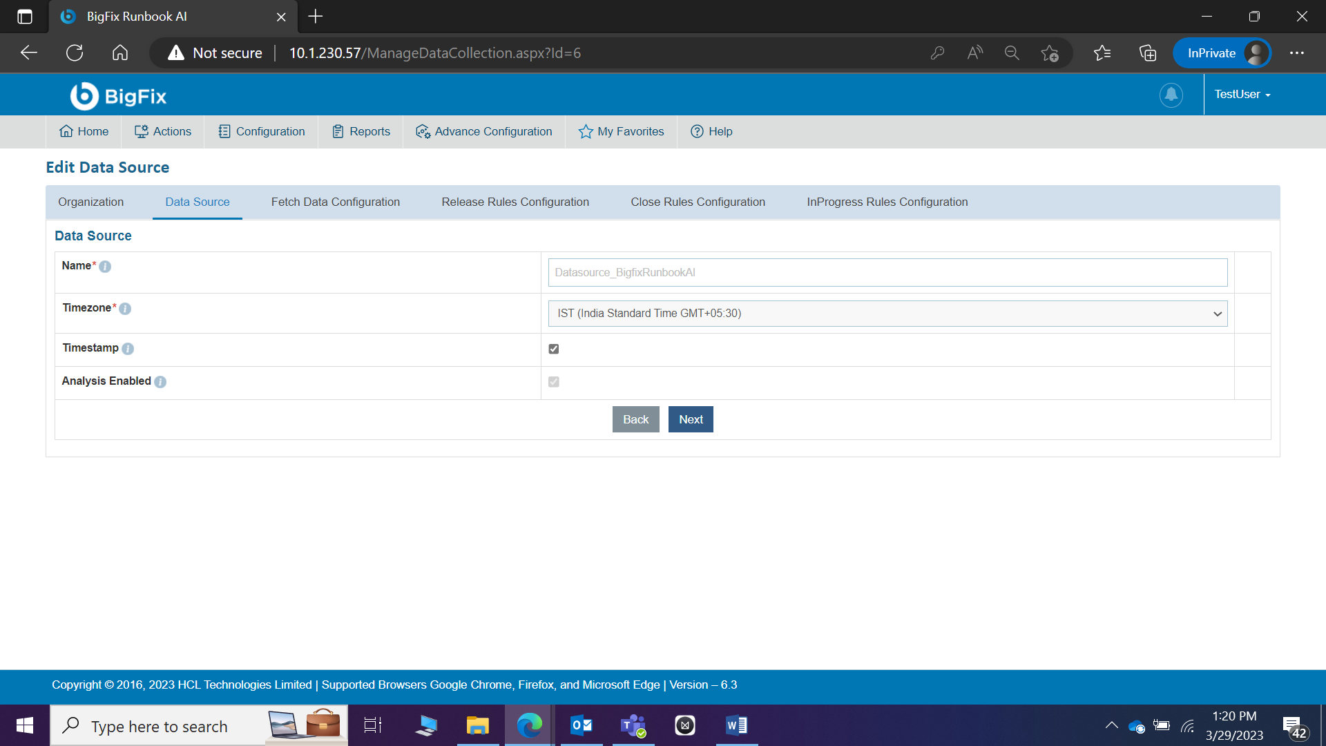

  • On the Data Source tab,
  • Type the new data source in the Name field.
  • Select the Timezone to specify the time zone of the selected data source.
  • Select Timestamp to view the present data with date and time.
  • Select Analysis Enabled? if user wants to analyze the data retrieved from the data source.
  • Click Next.

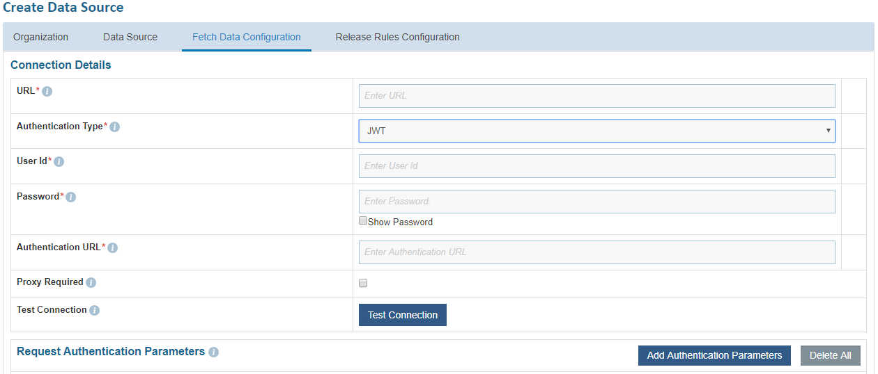

  • On the Fetch Data Configuration tab, type in the details as per the environment.
  • In the Connection Details section, enter the following details:
  • URL – Type the URL which contains the placeholders that display the parameters based on the applied clause such as the number of records to be fetched, query type, date on which the data is fetched, and the order by and so on. It is dependent on the URL or API provided by the tool.
  • Sample URL - https://URL.service-now.com/api/now/v1/table/incident?sysparm_fields=#Columns#&sysparm_query=sys_updated_on>=#StartDate#^sys_updated_on<=#EndDate#^ORDERBYsys_updated_on
  • Authentication Type – Select one of the Authentication Types from Basic / Windows, JWT, OAuth 2.0
  • Selection of Basic / Windows requires you to enter -
  • User Id
  • Password
  • Selection of JWT / OAuth 2.0 requires you to enter -
  • User Id
  • Password
  • Authentication URL
  • Proxy Required – Check Proxy Required, if the environment needs access to content from data sources outside the firewall.
  • Click on Test Connection to check accessibility of URL from service. Testing the connection is not mandatory, you can still create Data source.

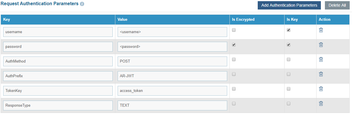

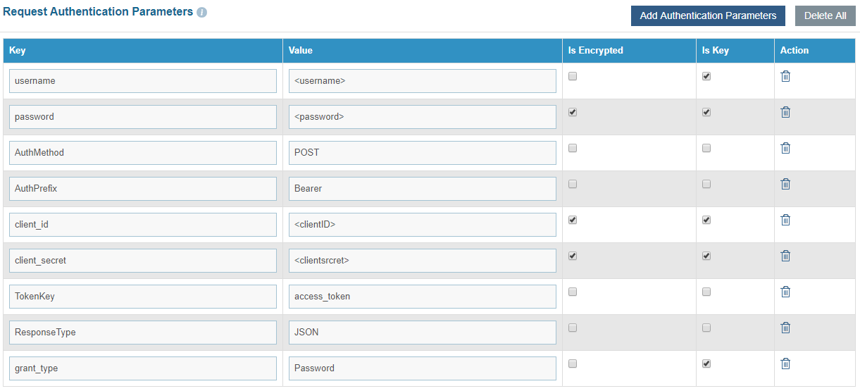

  • Request Authentication Parameters – If the user has additional parameters, click Add Authentication Parameters under the Request Authentication Parameters tab.
  • Based on the Authentication Type, add the parameters mentioned in the below table.
Table 1. Table 60– Sample Authentication Parameters
Authentication Type Key Value Is Encrypted? Is Key?
JWT username <username> NO YES
JWT password <password> YES YES
JWT AuthMethod POST NO NO
JWT AuthPrefix AR-JWT NO NO
JWT TokenKey access_token NO NO
JWT ResponseType TEXT NO NO
OAuth2.0 username <username NO YES
OAuth2.0 password <password> YES YES
OAuth2.0 AuthMethod POST NO NO
OAuth2.0 AuthPrefix Bearer NO NO
OAuth2.0 client_id <clientID> YES YES
OAuth2.0 client_secret <clientsecret> YES YES
OAuth2.0 TokenKey access_token NO NO
OAuth2.0 ResponseType JSON NO NO
OAuth2.0 grant_type Password NO YES
Figure 5. Figure 308 – Create Data Source (Request Authentication Parameters for JWT)
Figure 6. Figure 309 – Create Data Source (Request Authentication Parameters for OAuth2.0)

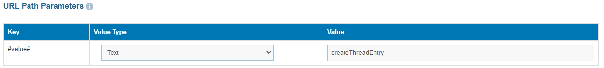

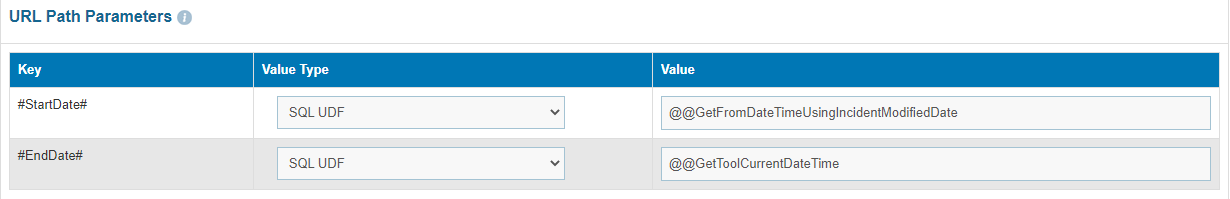

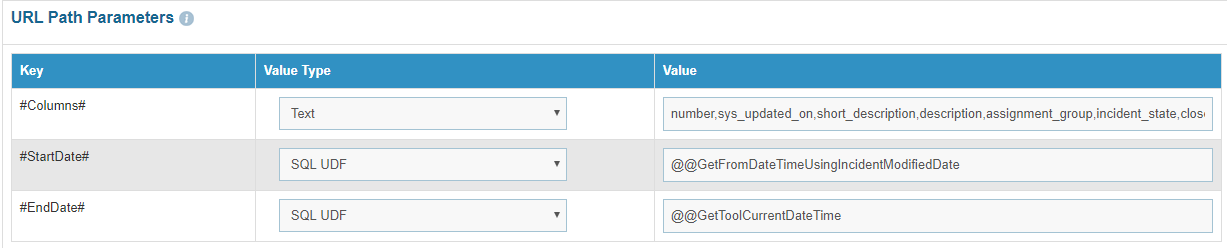

  • URL Path Parameters – Based on the URL entered earlier, please map the values to the URL Path Parameters. E.g., for the URL entered earlier, please populate the below inputs:
Key: #Columns#
ValueType: Text
Value:
number,sys_updated_on,short_description,description,assignment_group,incident_state,closed_at,category,dv_assigned_to,sys_id
Note – These columns are mandatory. User can add more columns if more data is required to be fetched from ITSM tool.
Key: #StartDate#
ValueType: SQL UDF
VALUE: @@GetFromDateTimeUsingIncidentModifiedDate
Key: #EndDate#
ValueType: SQL UDF
VALUE: @@GetToolCurrentDateTime
Figure 7. Figure 310– URL Path Parameters

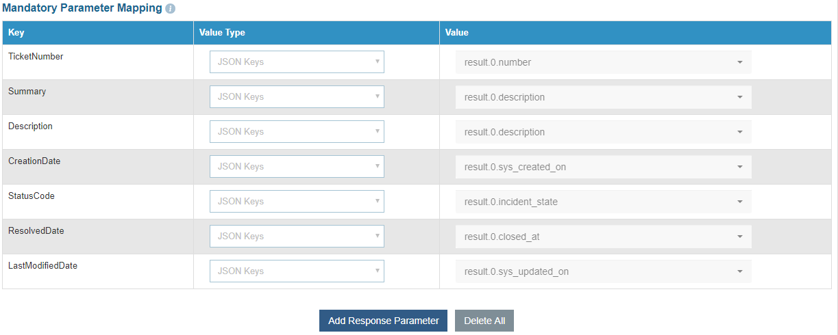

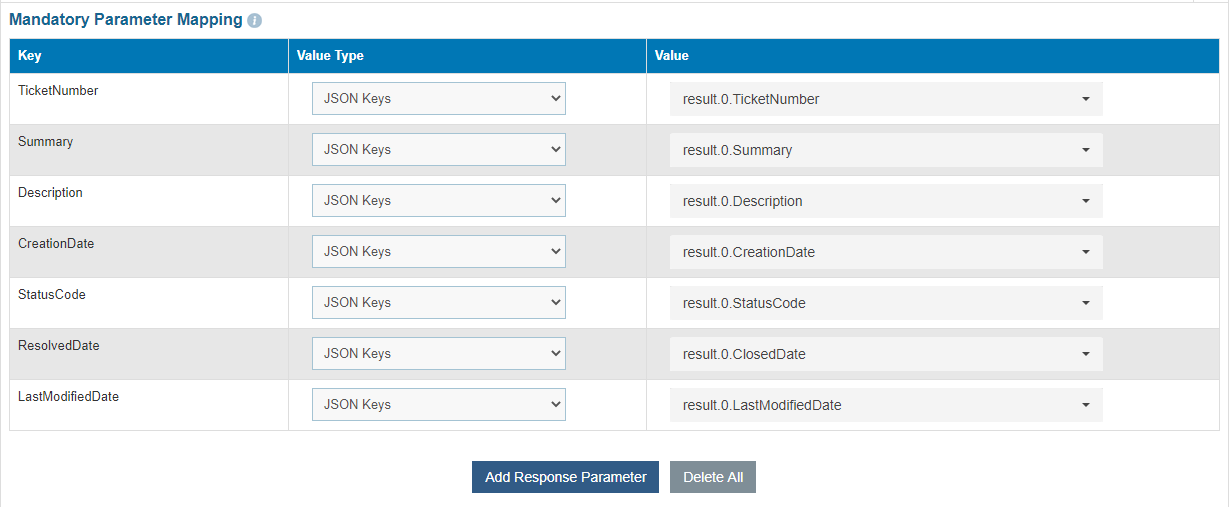

  • Mandatory Parameter Mapping – Please map the mandatory parameters to the respective values as mentioned in the screenshot below.
Table 2. Table 61– Sample Mandatory Parameter Mapping
Key Value Type Value
TicketNumber JSON.Keys result.0.number
Summary JSON.Keys result.0.short_description
Description JSON.Keys result.0.description
CreationDate JSON.Keys result.0.sys_created_on
StatusCode JSON.Keys result.0.incident_state
ResolvedDate JSON.Keys result.0.closed_at
LastModifiedDate JSON.Keys result.0.sys_updated_on
Figure 8. Figure 311 – Mandatory Parameter Mapping

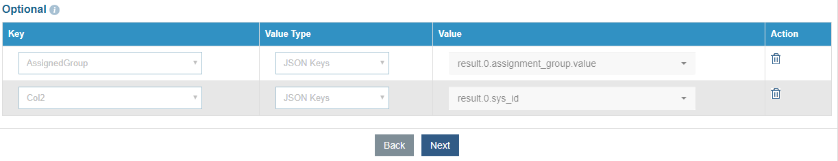

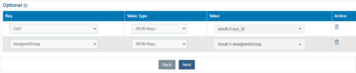

  • If you need to add Optional parameters, click Add Response Parameter to add more parameters. For our purpose, we will be adding a couple of extra parameters, as mentioned below, as we need them in the later section.
Table 3. Table 62– Sample Optional Parameters
AssignedGroup JSON.Keys result.0.assignment_group.value
Col1 JSON.Keys result.0.sys_id
Figure 9. Figure 312 – Optional Parameter Mapping

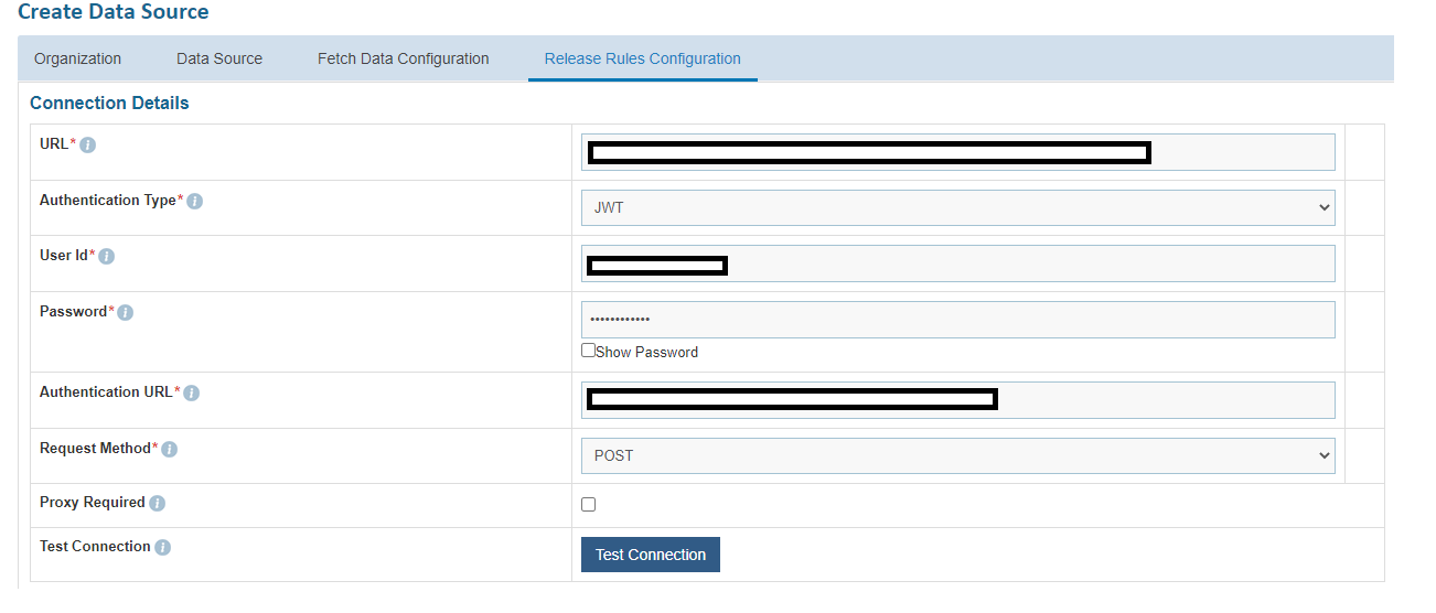

  • On Release Rules Configuration tab, type in the details as per the requirement.
  • URL – Type the URL of the selected service type to release the ticket. It contains the placeholders that display the parameters based on the applied clause and is dependent on the URL or API provided by the tool.
  • Sample URL - https://<url>.service-now.com/api/now/table/incident/#incident#
  • Authentication Type – Please enter the information in line with the Authentication type configured for fetching data configuration previously.
  • Request Method – Select Request Method as PUT from the drop-down.

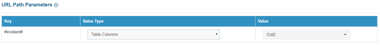

  • URL Path Parameters – Based on the URL entered earlier, please map the values to the URL Path Parameters. E.g., for the URL entered earlier, please populate the below inputs.
Key: #incident#
ValueType: Table Columns
Value:
Select from dropdown that mapped to sys_id from previous screen “Col2”

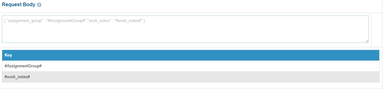

  • Request Body – In this section, please enter the request body in JSON format. A sample request is mentioned below.
Request Body –
{ "assignment_group" : "#AssignmentGroup#","work_notes" : "#work_notes#" }
Figure 12. Figure 315 – Release Rules Configuration (Request Body)

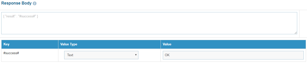

  • Response Body – In this section, please enter the response body in JSON format. A sample response is mentioned below.
Response Body –
{ "result" : "#success#" }
Figure 13. Figure 316 – Release Rules Configuration (Response Body)
  • Response Key Value mapping can be done as per the below table.
Table 63– Sample Response Key Value Mapping
#success# Text OK

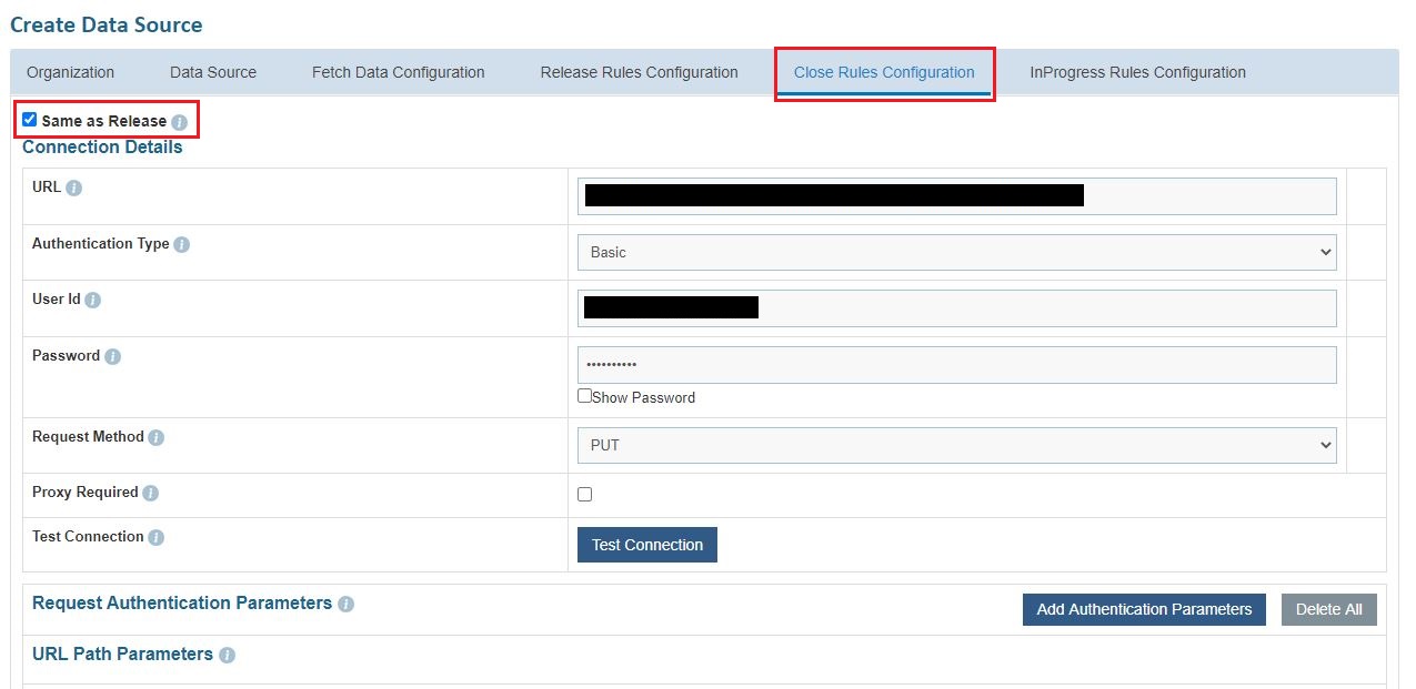

  • On Close Rules Configuration tab, type in the details as per the requirement. Check Same as Release if similar configurations as mentioned in “Release Rules Configuration” are required, else proceed ahead
Figure 14. Figure 317 – Close Rules Configuration (Connection Details)

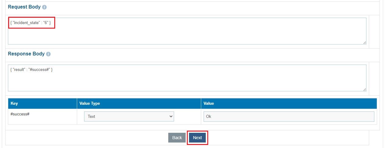

Request Body –
{ "incident_state" : "6"} If you also want to add worknotes while Close ticket, use json {"incident_state":"6", "work_notes": "#Notes#"}
Figure 16. Figure 319 – Close Rules Configuration (Request Body)
C:\Users\vashistg\Desktop\iAutomate Documents\InProgress-Close Documentation\3.InProgress-Close.JPG
Response Body –
Figure 17. Figure 320 – Close Rules Configuration (Response Body)

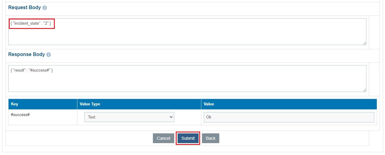

  • Request Header Parameters – Please enter the request header parameters as required.
Request Body –
{"incident_state" : "2"} If you also want to add worknotes while inprogress ticket, use json {"incident_state":"2", "work_notes": "#Notes#"}
Response Body –
Figure 21. Figure 324 – InProgress Rules Configuration (Response Body)
Table 5. Table 65– Sample Response Key Value Mapping
#success# Text OK
  • Click Submit to add the data source.

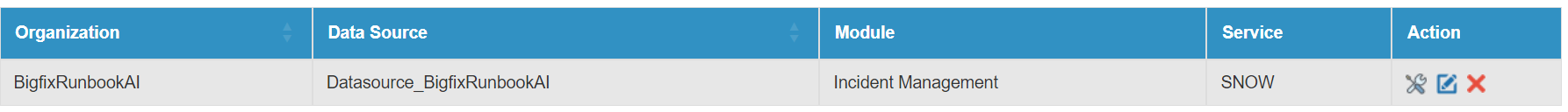

  • In order to bring the tickets within BigFix Runbook AI scope, a specific queue needs to be configured in the ITSM tool and same has to be configured in BigFix Runbook AI. This is achieved through Manage the Entry Criteria. Please perform the below steps –
  • Go to Actions tab and click Manage Data Sources.
  • On the Data Sources tab, click next to the data source user wants to manage. Manage Entry Criteria screen appears.
Figure 22. Figure 325 – Manage Entry Criteria
  • On the main menu bar, click Actions TabManage Data Source.
  • Organization
  • Data Source
  • Fetch Data Configuration
  • Release Rules Configuration
  • Close Rules Configuration (Optional – applicable only when the issue closure status update is managed by BigFix Runbook AI directly instead of RBA tool)
  • InProgress Rules Configuration (Optional – applicable only when the issue’s in progress status updates is managed by BigFix Runbook AI directly instead of RBA tool)
Figure 24. Figure 327 – Create Data Source
Release Rules Configuration is only applicable for the following Module types- Incident Management, Change Request Task and Service Request Task. This tab will not be activated for other module types.
  • Click Next.
Figure 25. Figure 328 – Create Data Source (cont.)
  • Select Analysis Enabled if user wants to analyze the data retrieved from the data source.
  • Click Next.
  • Sample URL - http://<IP>:<PORT>/iAutomateAPI/Request/GetIncidentTicketData/11?start_date>=#startdate#&end_date<=#enddate#
  • User Id
  • Password
  • User Id
  • Password
Figure 27. Figure 330 – Create Data Source (Connection Details)
Table 6. Table 66– Sample Authentication Parameters
Figure 28. Figure 331 – Create Data Source (Request Authentication Parameters for JWT)
Figure 29. Figure 332 – Create Data Source (Request Authentication Parameters for OAuth2.0)
Key: #StartDate#
ValueType: SQL UDF
Key: #EndDate#
ValueType: SQL UDF
Figure 30. Figure 333– URL Path Parameters
Table 7. Table 67– Sample Mandatory Parameter Mapping
TicketNumber JSON.Keys result.0.TicketNumber
Summary JSON.Keys result.0.Summary
Description JSON.Keys result.0.Description
CreationDate JSON.Keys result.0.CreationDate
StatusCode JSON.Keys result.0.StatusCode
ResolvedDate JSON.Keys result.0.ClosedDate
LastModifiedDate JSON.Keys result.0.LastModifiedDate
Figure 31. Figure 334 – Mandatory Parameter Mapping
Table 8. Table 68– Sample Optional Parameters
AssignedGroup JSON.Keys result.0. AssignedGroup
Figure 32. Figure 335 – Optional Parameter Mapping
  • Sample URL - https://<URL>/graze/v1/#value#
Figure 33. Figure 336 – Release Rules Configuration (Connection Details)
Key: #value#
ValueType: Text
Value: createThreadEntry
Figure 34. Figure 337 – Release Rules Configuration (URL Path Parameters)

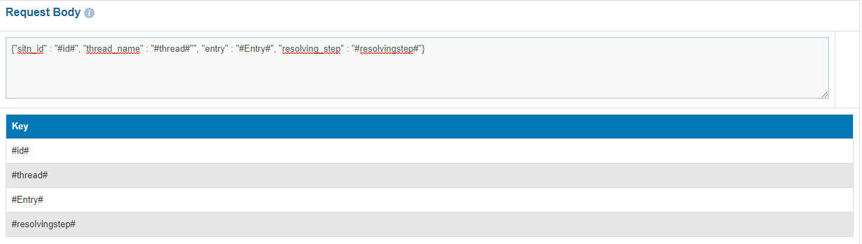

Request Body –
{"sitn_id" : "#id#", "thread_name" : "#thread#"", "entry" : "#Entry#", "resolving_step" : "#resolvingstep#"}
Figure 35. Figure 338 – Release Rules Configuration (Request Body)

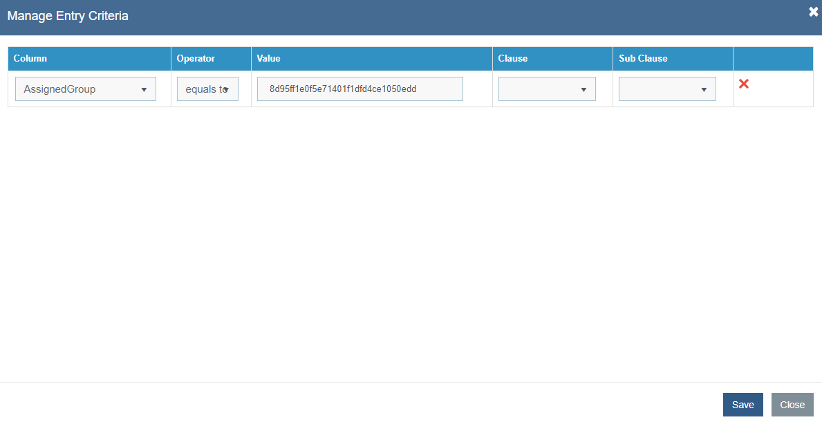

  • In order to bring the tickets within BigFix Runbook AI scope, a specific queue needs to be configured in the Event Management tool and same has to be configured in BigFix Runbook AI. This is achieved through Manage the Entry Criteria. Please perform the below steps:
Figure 37. Figure 340 – Manage Entry Criteria
  • Select ‘AssignedGroup’ for the Column field and ‘equals to’ for the Operator field.
  • Enter the sys_id of the assignment group in Moogsoft in the Value field.
  • Clause and Sub-Clause fields can also be added based on requirement.
Figure 38. Figure 341 – Manage Entry Criteria (cont.)
  • Click Save.
