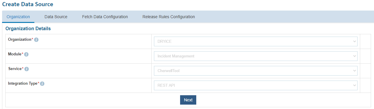

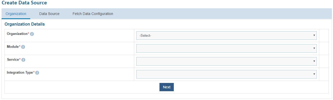

- On the Organization tab,
- Select the Organization Name from the dropdown.
- Select the Module as Incident Management, since we are configuring this data source for pulling the incident tickets.
- Select the Service as Cherwell Tool as we are configuring the data source for Cherwell
- Select the Integration Type as REST, since we will be integrating through REST APIs.
- Click Next.

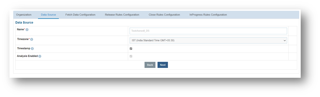

- On the Data Source tab,
- Type the new data source in the Name field.
- Select the Timezone to specify the time zone of the selected data source.
- Select Timestamp to view the present data with date and time.
- Select Analysis Enabled? if user wants to analyze the data retrieved from the data source.
- Click Next.

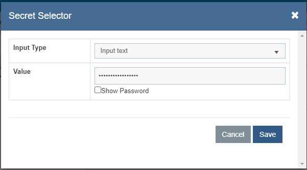

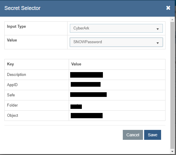

- Password For password, click on icon next to it. If the password is available in plaintext then select Input type as Input Text and enter the password in Value field. Else if it is available in any Key Vault such as CyberArk then select Input Type as CyberArk and then select any of the configured details from the value field.

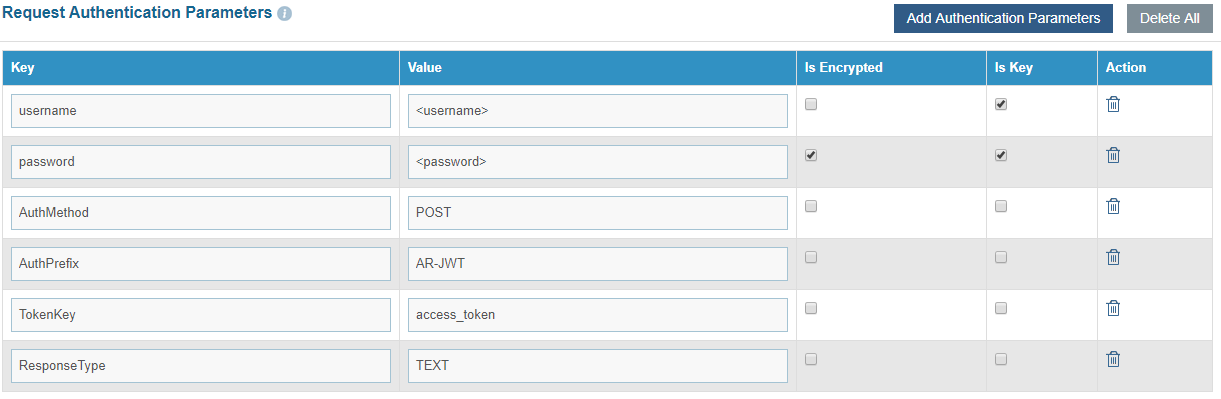

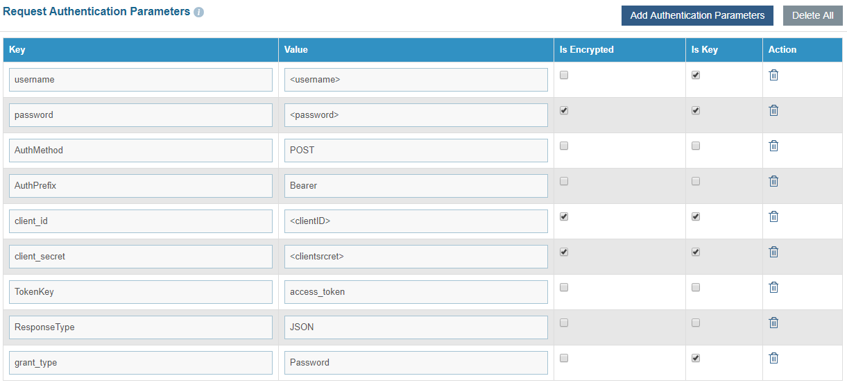

- Request Authentication Parameters – If the user has additional parameters, click Add Authentication Parameters under the Request Authentication Parameters tab.
- Based on the Authentication Type, add the parameters mentioned in the below table.
| Authentication Type | Key | Value | Is Encrypted? | Is Key? |
| JWT | username | <username> | NO | YES |
| JWT | password | <password> | YES | YES |
| JWT | AuthMethod | POST | NO | NO |
| JWT | AuthPrefix | AR-JWT | NO | NO |
| JWT | TokenKey | access_token | NO | NO |
| JWT | ResponseType | TEXT | NO | NO |
| OAuth2.0 | username | <username | NO | YES |
| OAuth2.0 | password | <password> | YES | YES |
| OAuth2.0 | AuthMethod | POST | NO | NO |
| OAuth2.0 | AuthPrefix | Bearer | NO | NO |
| OAuth2.0 | client_id | <clientID> | YES | YES |
| OAuth2.0 | client_secret | <clientsecret> | YES | YES |
| OAuth2.0 | TokenKey | access_token | NO | NO |
| OAuth2.0 | ResponseType | JSON | NO | NO |
| OAuth2.0 | grant_type | Password | NO | YES |

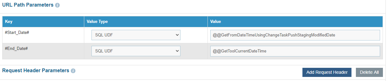

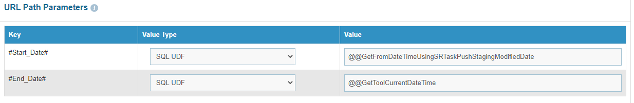

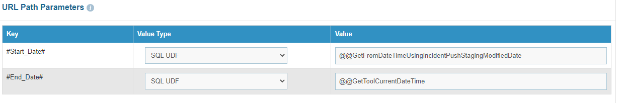

- URL Path Parameters – Based on the URL entered earlier, please map the values to the URL Path Parameters. E.g., for the URL entered earlier, please populate the below inputs:
Key: #StartDate#
ValueType: SQL UDF
VALUE: @@GetFromDateTimeUsingIncidentPushStagingModifiedDate
Key: #EndDate#
ValueType: SQL UDF
VALUE: @@GetToolCurrentDateTime

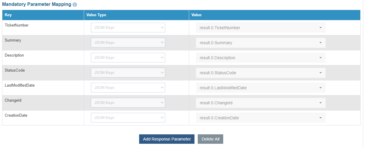

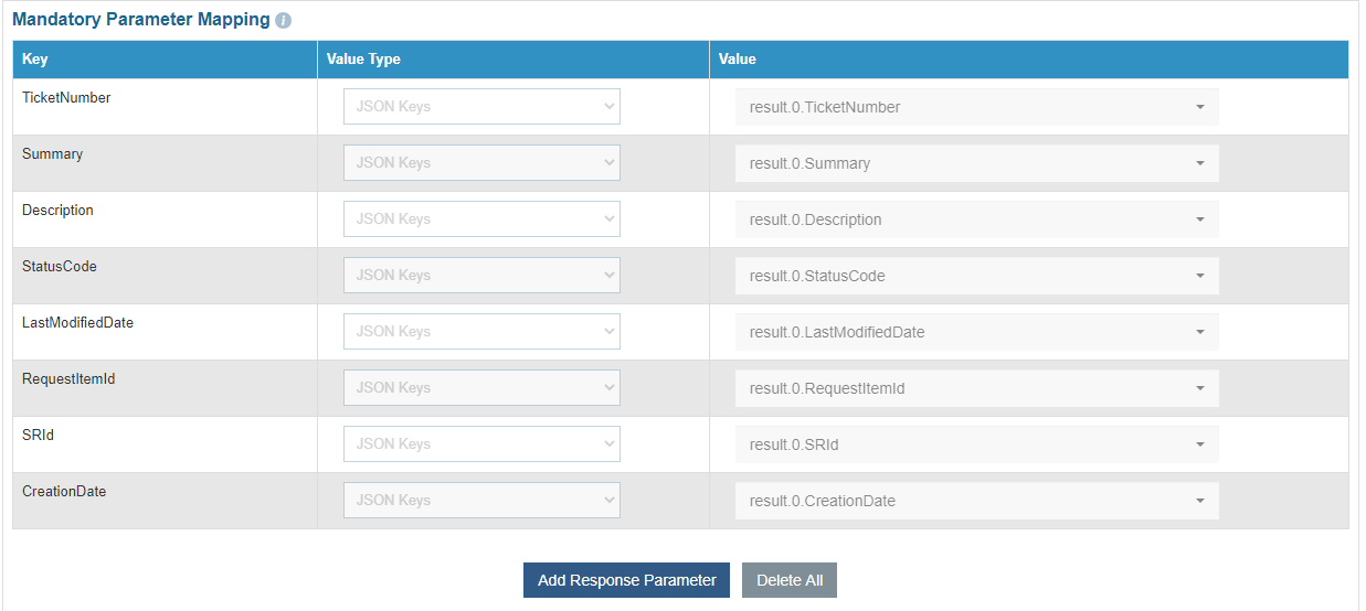

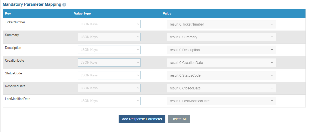

- Mandatory Parameter Mapping – Please map the mandatory parameters to the respective values as mentioned in the screenshot below:
| Key | Value Type | Value |
| TicketNumber | JSON.Keys | result.0.TicketNumber |
| Summary | JSON.Keys | result.0.Summary |
| Description | JSON.Keys | result.0.Description |
| CreationDate | JSON.Keys | result.0.CreationDate |
| StatusCode | JSON.Keys | result.0.StatusCode |
| ResolvedDate | JSON.Keys | result.0.ClosedDate |
| LastModifiedDate | JSON.Keys | result.0.LastModifiedDate |

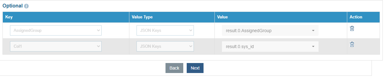

- If you need to add Optional parameters, click Add Response Parameter to add more parameters. For our purpose, we will be adding a couple of extra parameters, as mentioned below, as we need them in the later section.
| AssignedGroup | JSON.Keys | result.0.AssignedGroup |
| Col1 | JSON.Keys | result.0.sys_id |

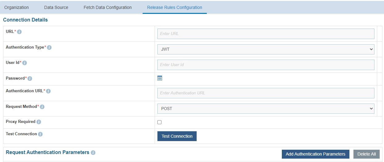

- On Release Rules Configuration tab, type in the details as per the requirement.
- In the Connection Details section, enter the following details:
- URL – Type the URL of the selected service type to release the ticket. It contains the placeholders that display the parameters based on the applied clause and is dependent on the URL or API provided by the tool.
- Sample URL - https://<url>.cherwellondemand.com/CherwellAPI/api/V1/savebusinessobjectbatch
- Authentication Type – Please enter the information in line with the Authentication type configured for fetching data configuration previously. For e.g., JWT.
- Request Method – Select Request Method as POST from the drop-down.
- Proxy Required – Check Proxy Required, if the environment needs access to content from data sources outside the firewall.
- Click on Test Connection to check accessibility of URL from service. Testing the connection is not mandatory, you can still create Data source.
- Password For password, click on icon next to it. If the password is available in plaintext, then select Input type as Input Text and enter the password in Value field. Else if it is available in any Key Vault such as CyberArk then select Input Type as CyberArk and then select any of the configured details from the value field.

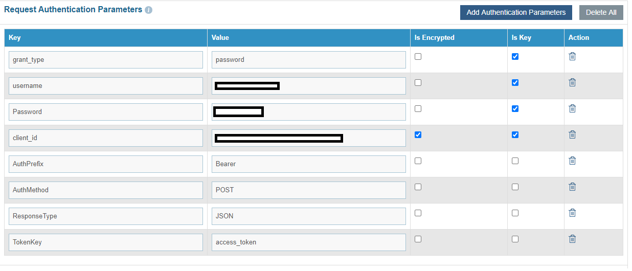

- Request Authentication Parameters - If the user has additional parameters, click Add Authentication Parameters under the Request Authentication Parameters tab.
| grant_type | password | N | Y |
| username | <username> | N | Y |
| Password | <password> | Y | Y |
| client_id | <client_id> | N | Y |
| AuthPrefix | Bearer | N | N |
| AuthMethod | POST | N | N |
| ResponseType | JSON | N | N |
| TokenKey | access_token | N | N |

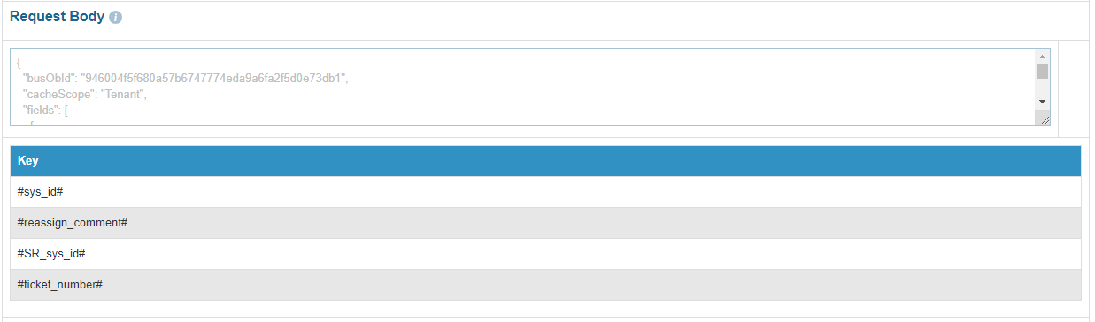

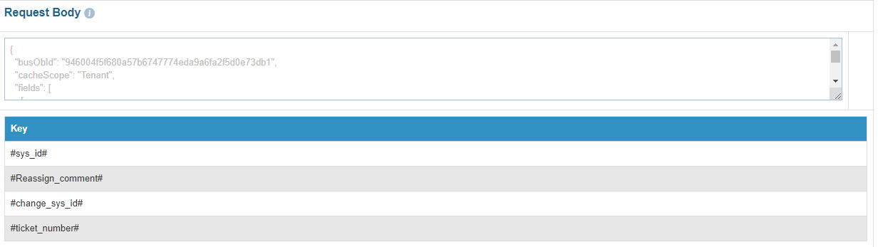

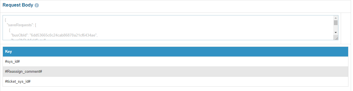

- Request Body - In this section, please enter the request body in JSON format. A sample request is mentioned below:
Request Body –
"saveRequests": [
"busObId": "6dd53665c0c24cab86870a21cf6434ae",
"busObPublicId": null,
"busObRecId": "#sys_id#",
"cacheKey": null,
"cacheScope": "Tenant",
"fields": [
"dirty": true,
"displayName": null,
"fieldId": "9339fc404e8d5299b7a7c64de79ab81a1c1ff4306c",
"html": null,
"name": null,
"value": "Service Desk"
"dirty": true,
"fieldId": "9339fc404e4c93350bf5be446fb13d693b0bb7f219",
"html": null,
"name": null,
"value": ""
"dirty": true,
"fieldId": "5eb3234ae1344c64a19819eda437f18d",
"html": null,
"name": null,
"value": "Assigned"
"persist": true
"busObId": "934d8181ba9d3a6a506d7643e1bc71f70fa9b47412",
"busObRecId": null,
"cacheKey": null,
"fields": [
"dirty": true,
"fieldId": "9341223bbcef1e2b8dfa6048a2bb4be1e94bad60ac",
"html": null,
"name": null,
"value": "#Reassign_comment#"
"dirty": true,
"fieldId": "9341222c4b89e253dd22b64d1fb16d0008bef6971f",
"html": null,
"name": null,
"value": "#ticket_sys_id#"
"persist": true
"stopOnError": true}

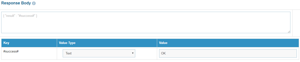

- Response Body – In this section, please enter the response body in JSON format. A sample request is mentioned below:
Response Body –
{ "result" : "#success#" }
- Response Key Value mapping can be done as per the below table.
| #success# | Text | OK |

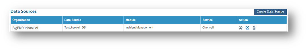

- Click Submit to add the data source.

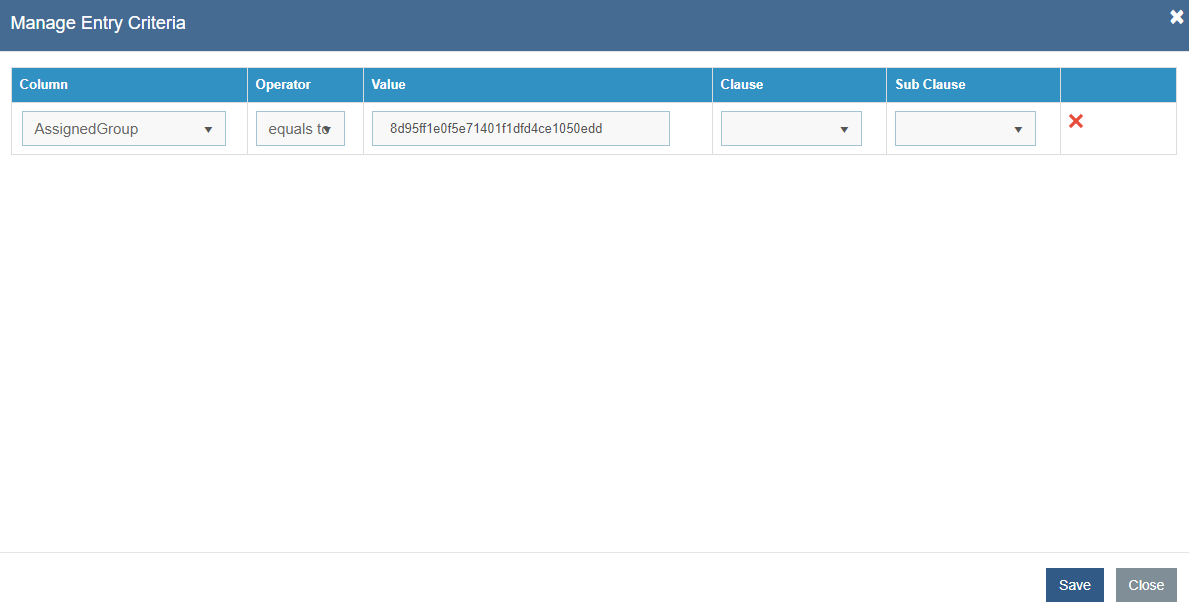

- In order to bring the tickets within BigFix Runbook AI scope, a specific queue needs to be configured in the ITSM tool and same has to be configured in BigFix Runbook AI. This is achieved through Manage the Entry Criteria. Please perform the below steps:

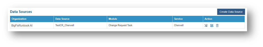

- Go to Action tab and click Manage Data Sources.
- On the Data Sources tab, click
next to the data source user
wants to manage. Manage Entry Criteria screen
appears.
- Select ‘AssignedGroup’ for the Column field and ‘equals to’ for the Operator field.
- Enter the sys_id of the assignment group in Cherwell in the Value field.
- Clause and Sub-Clause fields can also be added based on requirement.
- Click Save.

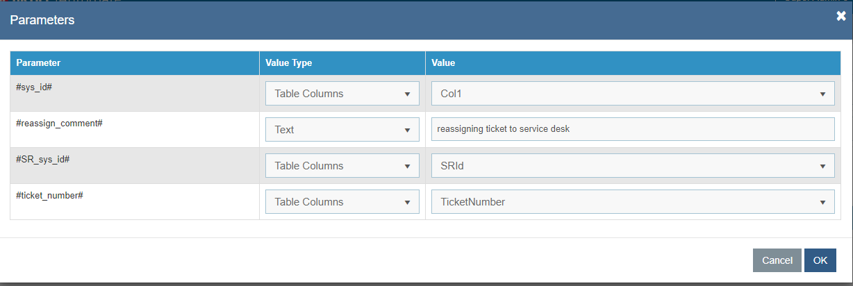

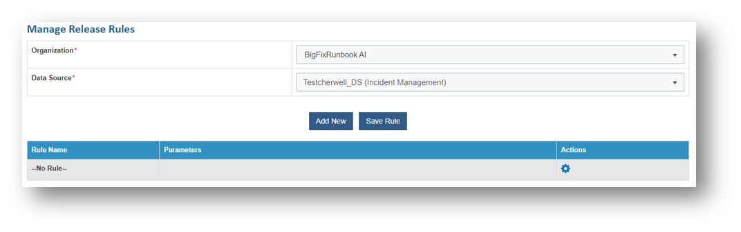

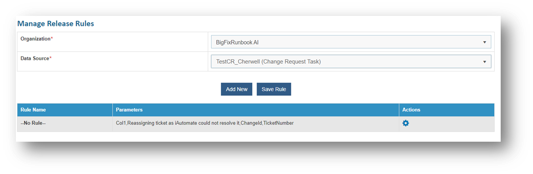

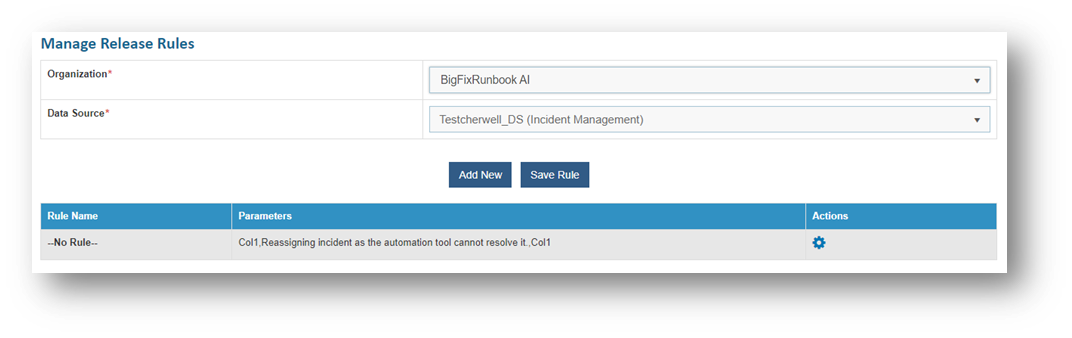

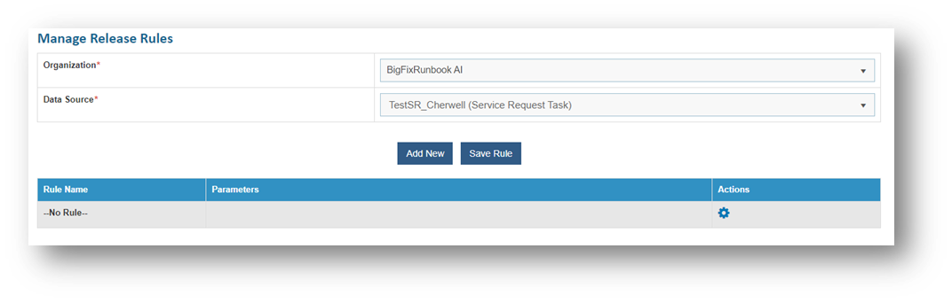

- To configure the Release rules for the data source created earlier, perform the below steps:
- Go to Action Tab Runbooks Manage Rules.
- Select the Organization and the data source created from Data Source dropdown.
- Click on
corresponding to
–No Rule—

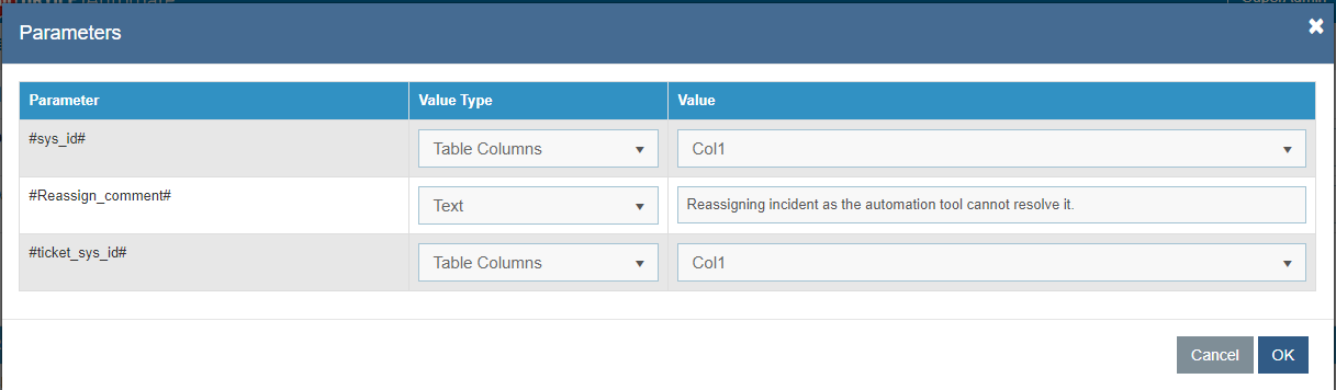

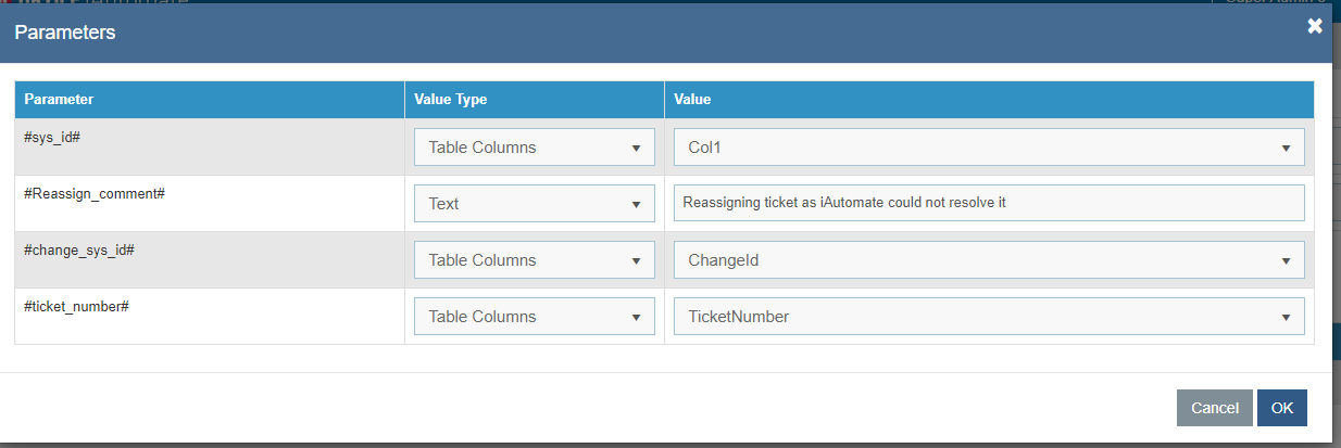

- Map the parameters #sys_id# to the column in which sys_id was mapped while performing the mandatory parameter mapping while data source creation.
- Mention the reason for releasing ticket in #reassign_comments#.
- Map #ticket_sys_id# again to the column in which sys_id was mapped while performing the mandatory parameter mapping while data source creation.
- Click OK.
- Click Save Rule.

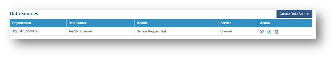

Service Request Task Management
To create a data source for Service Request Task Management, perform the following steps:
- On the main menu bar, click Actions tab Manage Data Sources.

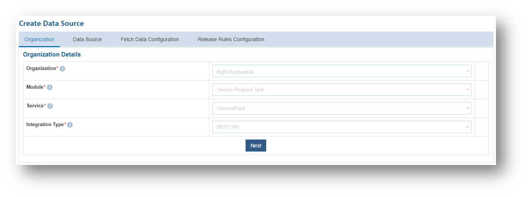

- In the Module field, select Service Request Task, since we are configuring this data source for pulling the service request task tickets.
- In the Service field, select Cherwell Tool as we are configuring the data source for Cherwell
- In the Integration Type field, select REST, since we will be integrating through REST APIs.
- Click Next.

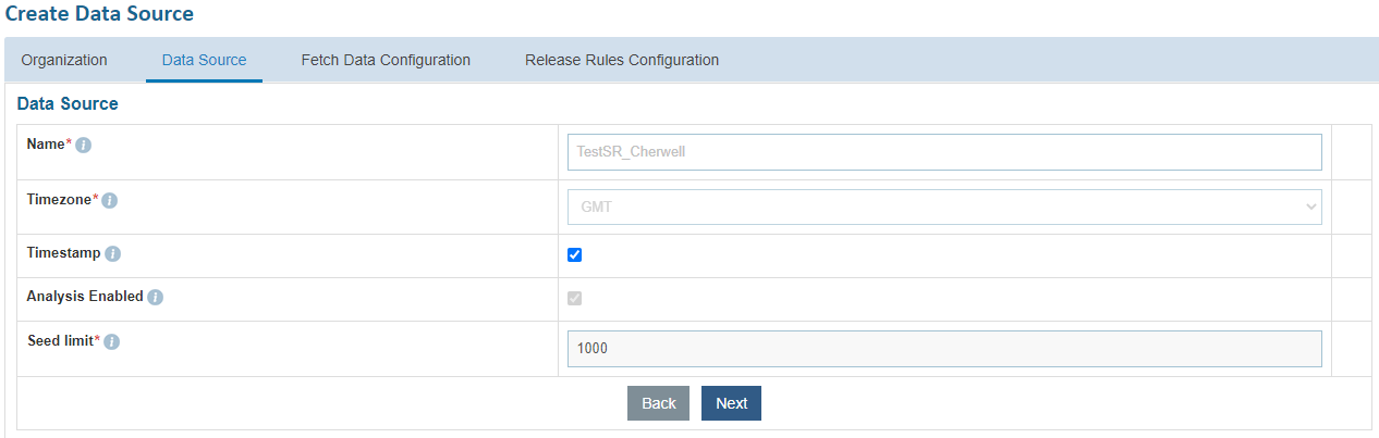

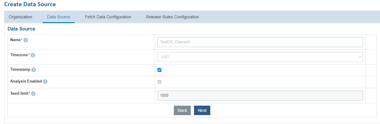

- Select Analysis Enabled if you want to analyze the data retrieved from the data source.
- Click Next.

- For Password, click on icon next to it. If the password is available in plaintext, then select Input type as Input Text and enter the password in Value field. Else if it is available in any Key Vault such as CyberArk then select Input Type as CyberArk and then select any of the configured details from the value field.
Key: #StartDate#
ValueType: SQL UDF
VALUE: @@GetFromDateTimeUsingSRTaskPushStagingModifiedDate
Key: #EndDate#
ValueType: SQL UDF

- After entering the response, click Extract Keys to add the parameters in the Mandatory Parameter Mapping section.
| RequestItemId | JSON.Keys | result.0.RequestItemId |
| SRId | JSON.Keys | result.0.SRId |
- Sample URL - https://<url>. cherwellondemand.com/CherwellAPI/api/V1/savebusinessobjectbatch
Request Body –
"busObId": "946004f5f680a57b6747774eda9a6fa2f5d0e73db1",
"fields": [
"dirty": true,
"displayName": "Task RecID",
"fieldId": "946005353974025498ed1d4068936d72c8992d015c",
"value": "#sys_id#"
"dirty": true,
"displayName": "Parent RecID",
"fieldId": "9460053dd53d9888efddc34d3db0360cc5be25f567",
"value": "#SR_sys_id#"
"dirty": true,
"displayName": "Journal Details",
"fieldId": "946005008899c5f5c31caa43c99083519668f0ff33",
"value": "#reassign_comment#"
"dirty": true,
"displayName": "Ticket Number",
"fieldId": "94602e208e8947bff420df4016b30962152556d5e2",
"value": "#ticket_number#"
"dirty": true,
"displayName": "Assignment Team",
"fieldId": "946005013472134fdc1b0649a685d41a4c73f6e179",
"dirty": true,
"displayName": "Status",
"fieldId": "946004ff47672c8cda67da43a1945ce56f2f617855",
"value": "New"
"dirty": true,
"displayName": "Task Type",
"fieldId": "946004feb10853e55a192849c780773b2133028cc0",
"value": "SR Task"
"dirty": true,
"displayName": "Reassigning",
"fieldId": "946005a199ecde0a9cf0b748bb94e4040c2007540f",
"value": "True"
"persist": true
- Response Body – In this section, please enter the response body in JSON format. A sample request is mentioned below.
Response Body –
- Go to Actions tab and click Manage Data Sources.
appears.
- Click Save.
- Go to Actions Tab Runbooks and click Manage Rules.
- Click on
corresponding to
–No Rule—. - Map the parameters #sys_id# to the column in which sys_id was mapped while performing the mandatory parameter mapping while data source creation.
- Map # SR_sys_id # again to the column in which SRId was mapped while performing the mandatory parameter mapping while data source creation.
- Click OK.
- Click Save Rule.
- The Create Data Source page appears with the following tabs:
- Select the Module as Change Request Task since we are configuring this data source for pulling the change request task tickets.
- Click Next.
- Click Next.

- URL Path Parameters – Based on the URL entered earlier, please map the values to the URL Path Parameters. E.g., for the URL entered earlier, please populate the below inputs.
Key: #StartDate#
ValueType: SQL UDF
VALUE: @@GetFromDateTimeUsingChangeTaskPushStagingModifiedDate
Key: #EndDate#
ValueType: SQL UDF

- Mandatory Parameter Mapping – Please map the mandatory parameters to the respective values as mentioned in the screenshot below.
| ChangeId | JSON.Keys | result.0.ChangeId |
Request Body –
"fields": [
"dirty": true,
"value": "#sys_id#"
"dirty": true,
"dirty": true,
"value": "#change_sys_id#"
"dirty": true,
"dirty": true,
"value": "GBP Change Management"
"dirty": true,
"value": "Acknowledged"
"dirty": true,
"value": "Change Task"
"dirty": true,
"value": "True"
"persist": true
Response Body –
appears.
- Click Save.

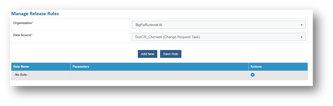

- Go to Actions tab Runbooks and click Manage Rules.
- Click on
corresponding to
- Map #change_sys_id # again to the column in which ChangeId was mapped while performing the mandatory parameter mapping while data source creation.
- Click OK.
- Click Save Rule.
