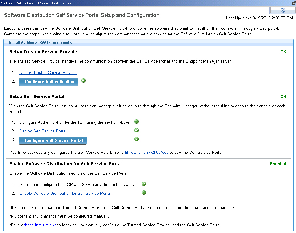

The Software Distribution Self Service Portal Setup and Configuration wizard provides an easy, step-by-step guided process to configure the required components. This wizard checks and notifies you of the status of each of the required steps.
Figure 1: Software Distribution Self Service Portal Setup and Configuration wizard

  1. From the Systems Lifecycle domain, click Software Distribution > Setup > Software Distribution Self Service Portal Setup.
  2. Click Activate to activate the necessary analyses to view the dashboard.

  5. Click Enable Software Distribution for Self Service Portal, if you have not already done so.
The wizard shows that you completed all the required steps as shown in the following screen capture:
Figure 5: Successfully installed and configured the software distribution Self Service Portal.
