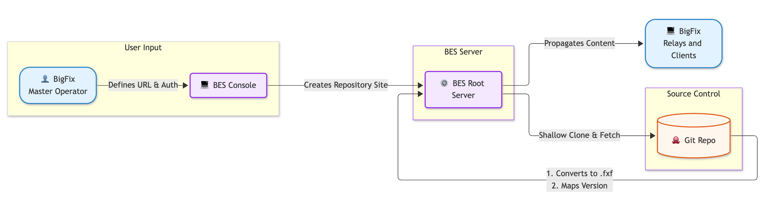

In BigFix 11.0.7, the BigFix Server treats the Git repository as the source of truth for a new site type called External Repository Site:
  • A new External Site type recognized by a repository-specific gather URL.
  • Repository URL and branch define the source identity.
With this enhancement, the BigFix Server is responsible for clone/fetch, content export, version mapping, and publication.
The content flow is as follows:
  • Initial synchronization uses a shallow clone; later cycles reuse the local repository and perform incremental fetches.
  • The generated site behaves like traditionally published external content: signed listing first, then file hash validation.
  • A manual Gather operation triggers an immediate repository check; normal scheduling uses the configured polling period.
  • Repository SSH access and known_hosts verification protect synchronization.

After import, the BigFix Server checks the configured branch, performs an initial shallow clone, compiles and publishes the content, and the normal gather process imports it. Subsequent checks reuse the local repository and fetch changes. Use Gather in the BigFix Console to check immediately instead of waiting for the scheduled poll.
Check the site details for the current version and the expected repository URL and branch. In the BigFix Server log, look for Repository site cloned successfully on the first sync or Repository site updated successfully on later syncs. In GatherDB.log, confirm that the site version was imported successfully. A 404 response during the first sync can be temporary until publishing finishes.
