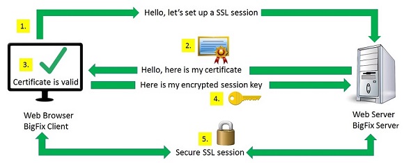

The first step that enables the client and server to communicate over SSL is an handshake procedure where the client authenticates the server. This phase of the communication is based on asymmetric encryption that uses two keys that the server must own:
  • A public key that is contained in a digital certificate and is used to encrypt the information
  • An associated private key that is used to decrypt the information
The digital certificate states that the public key is correctly associated to a server. Therefore the certificate is generally issued by an external Certificate Authority that digitally signs it. BigFix applications provide self-signed certificates (a certificate that is issued by the server itself), and you cannot verify the origin of these certificates through a trusted certificate authority. For this reason they are not intended for production environments.
After enabling SSL communication, anyone who connects to your BigFix server receives a certificate that contains your public key. If the client is a web browser, it has a list of trusted certificate authorities and checks that the certificate was issued by one of them. If it is valid, the web browser uses the public key that was contained in the certificate to encrypt a proposed shared key and sends the encrypted key over the web server where it decodes the shared key using its private key. Now both client and server have a copy of the same symmetric key which they use to encrypt all future communications. The following figure summarizes the steps for establishing a secure communication:
SSL secure communication
