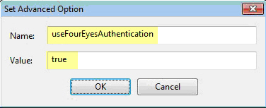

  2. When the tool dashboard opens, click the Advanced Options tab and Click Add.
  3. In the Name field, type “useFourEyesAuthentication”; in the Value field, type “true”; and then click OK.
  4. Click OK to exit the BigFix Administration Tool.
