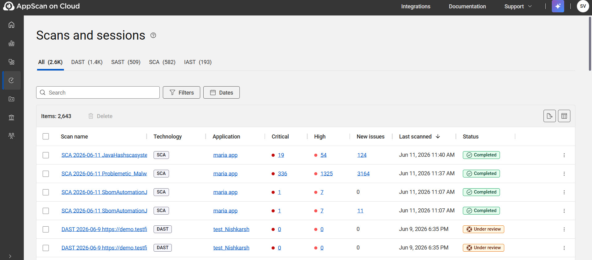

Scans and sessions
This view lists all scans and sessions in all your applications.

The main Scans page lists all scans in all your applications. To view scans for a specific application, select Applications > Application page > Scans and sessions.

Filters To filter a list of scans, click Filters, select the applicable filters and then click Apply. To remove all applied filters, click Clear all. Persistent filters keep your filtered view saved between sessions so you can continue where you left off. On the main Scans page or an application's Scans and sessions page, select Ownership and then Regular scans to show only nonpersonal scans, or Personal scans to show only personal scans.
Delete Select the rows and click Delete to delete one or more scans. For more information see, Bulk delete scans .
Export Exports the scan data to a CSV or JSON file. Note that the scan export is limited to 10,000 scans, even if there are more than 10,000 scans available.
Columns By default, columns are displayed based on the relevant technologies. You can add or remove columns as needed.
Scan name Click on the name to open the scan page, with full details of this scan. See Single scan view.
personal scan icon This icon appears at the right end of scans that were run as personal scans. To promote, click Vertical three-dot menu and select Promote scan
