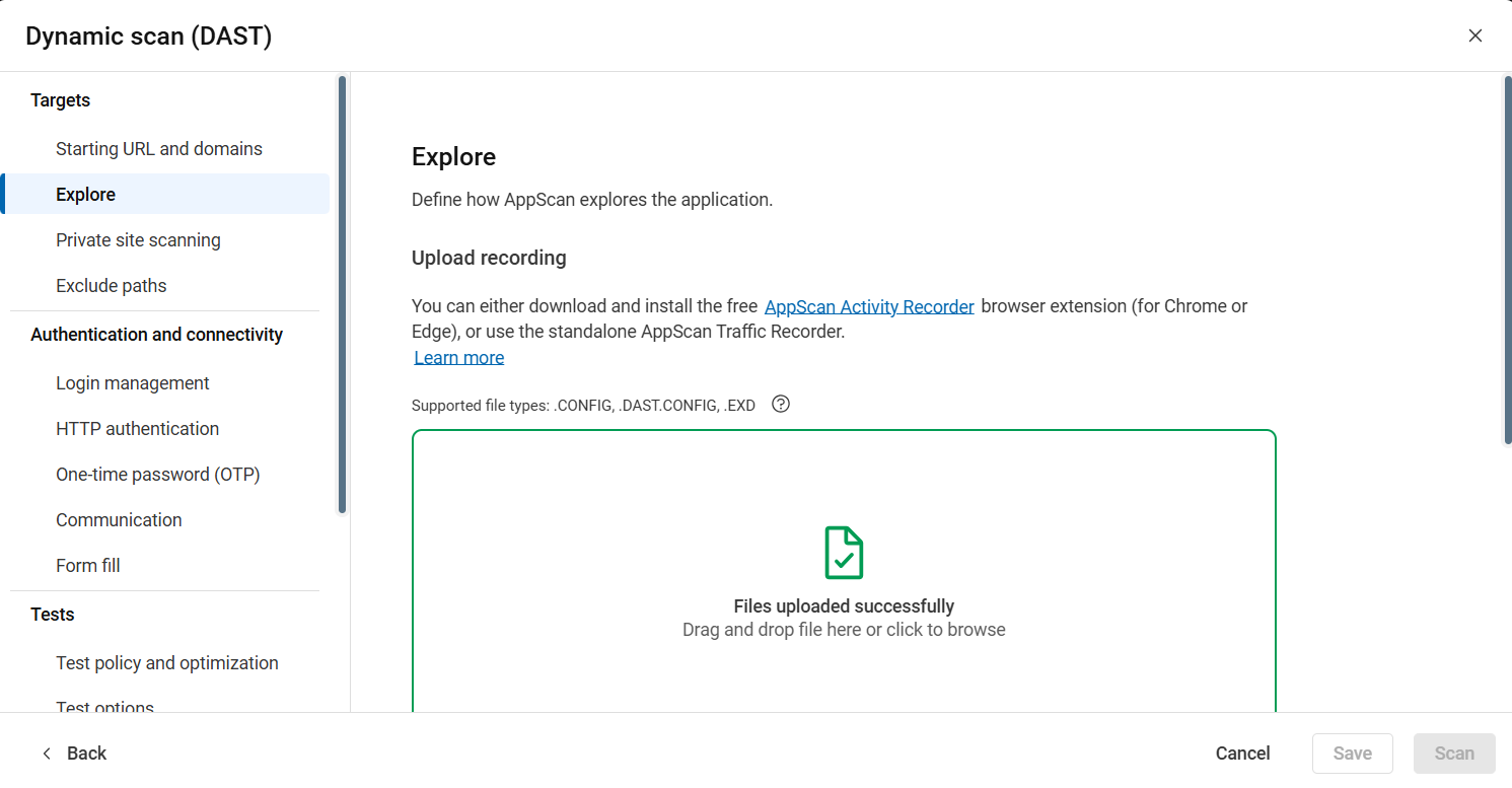

  4. Targets: Explore
    Use Recorded explore to check specific parts of your application. This helps ASoC find those areas, making sure they are tested in the DAST scan. It also gives ASoC the information needed to follow links in a certain order.
    Setting
    Options
    Upload recording
    Upload one or more DAST.CONFIG or .EXD traffic files. For details of how to record these, see Recording traffic.
    File settings
    If you need the requests in your traffic file to be sent in the exact order you recorded them, activate Multistep. This method significantly increases the duration of the scan, so only use it if necessary. To understand the difference between Multistep and regular Recorded explore, refer to Recorded explore.
    To activate Multistep:
    • For each uploaded recording, click the expand icon next to the file name and switch the Advanced: Activate "Multistep" option to On.
    Select how to use the file
    Use both recorded and automatic explore stages for comprehensive testing
    ASoC runs its own automatic explore stage to discover the application. It tests the application based on both these results and the traffic file you uploaded.
    Analyze and test only the recorded explored data
    ASoC treats the uploaded file as the Explore stage for the scan. It analyzes and creates tests for the recorded traffic only, and then tests it. There will be no automatic Explore stage.

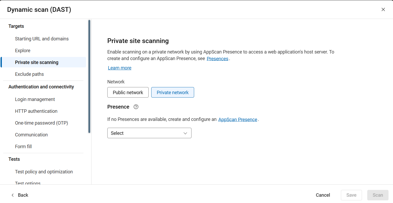

  5. Targets: Private site scanning
    Public site scanning is the default. If your site is not available on the Internet, click Private network. Select your presence from the list of connected presences.
    If you have not yet created an an AppScan Presence you can do so now by clicking the Presences link, and referring to Creating the AppScan Presence.

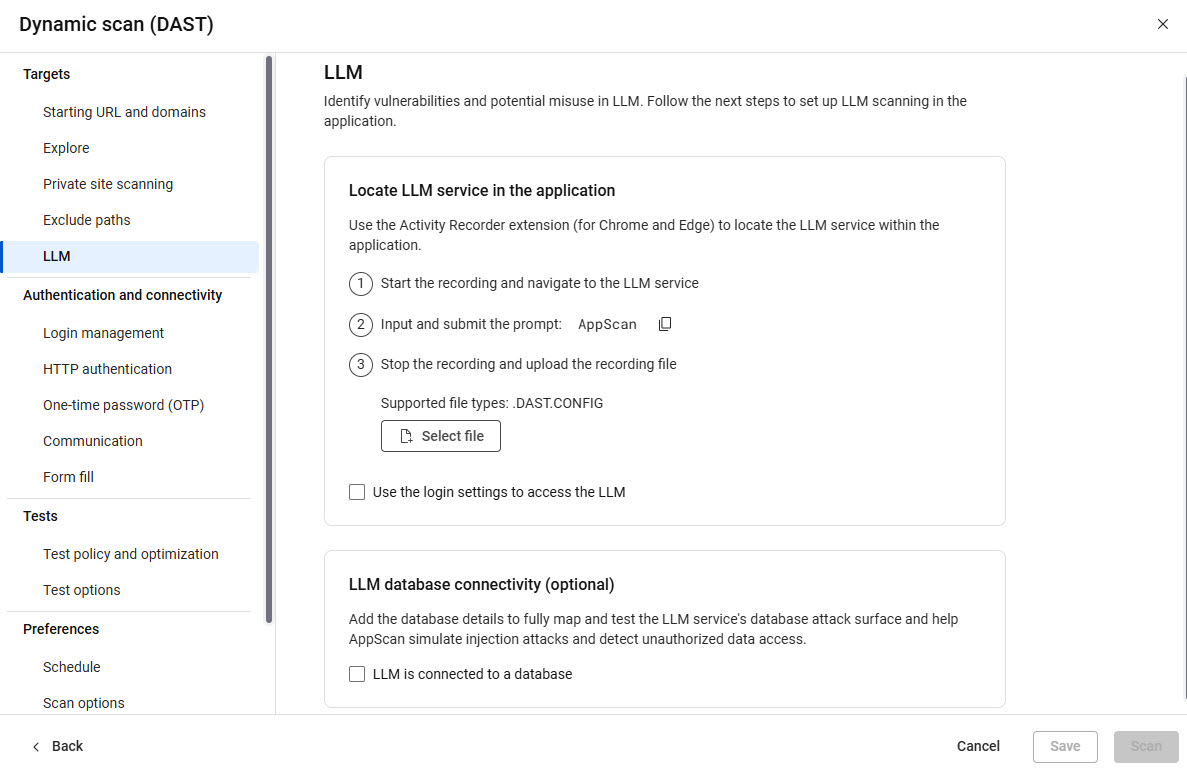

  7. Targets: LLM
    Dynamically test Large Language Model (LLM) features in your application to detect critical vulnerabilities such as sensitive information disclosure, prompt injection, and more.
    Scan configuration showing LLM configuration option
    Setting
    Options
    Locate LLM service in the application
    • Follow the on-screen steps. When the recording is ready, click Select file and upload the LLM recording. For more information, see Configure and run an AppScan LLM security scan.
    • Use the login settings to access LLM: Select this checkbox to have ASoC use the login management settings to access LLM.
    LLM database connectivity (optional) Select the LLM is connected to a database checkbox, then enter the name of the connected database table to fully map and test the LLM service’s database attack surface. AppScan uses this information to simulate injection attacks and identify vulnerabilities that could allow unauthorized data access.

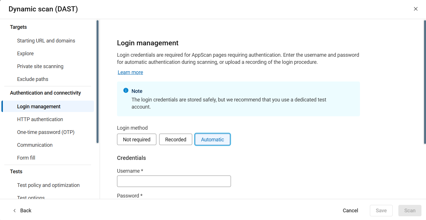

  8. Authentication and connectivity: Login management
    By default, login is not required. Leave this selection as is if no login/authorization is required.
    Setting
    Options
    Login
    Login required: Username and Password
    Select if ASoC is able to log in as needed using credentials but with no special procedure. You can also enter a third credential (optional). For example: PIN# = 1234. However, the use of a third credential requires intervention by the ASoC Support team, and the scan may take longer.
    CAPTCHA login is not supported by this login method. Upload a scan or template file configured in AppScan Standard instead. See CAPTCHA login requirements.
    Tip:
    ASoC recommends use of test credentials rather than the credentials of an actual user.
    Login Required: Recorded login
    If a special login procedure is needed, select this option to upload a recording of the procedure that ASoC must use whenever it logs in to the applications during the scan. You can record using the AppScan Activity Recorder (saved as a CONFIG file) or AppScan Standard (exported as a LOGIN file).
    Important:
    The recorded login sequence must contain the following requests:
    • Login/authorization request
    • An additional logged-in/authorized request. This "extra" request helps AppScan identify a successful authorization and maintain session when testing the application.
    For details about recording a CONFIG or LOGIN file see Recording traffic and Recording the login using AppScan Standard.

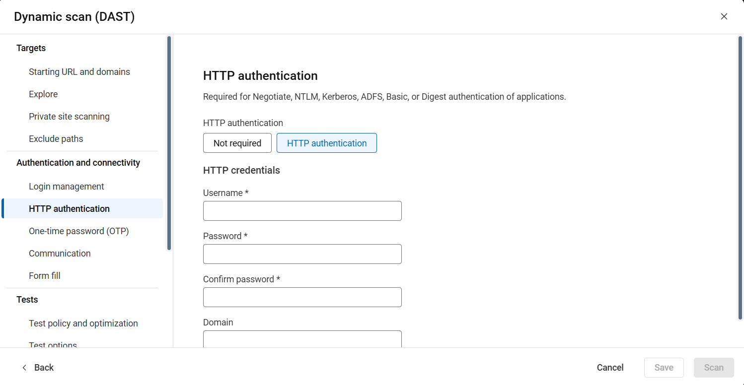

  9. Authentication and connectivity: HTTP authentication
    In addition to the login information, indicate whether the application requires HTTP authentication (Negotiate, NTLM, Kerberos, ADFS, Basic, or Digest). Enter the Username, Password, and Domain (optional) for ASoC to use during the scan.

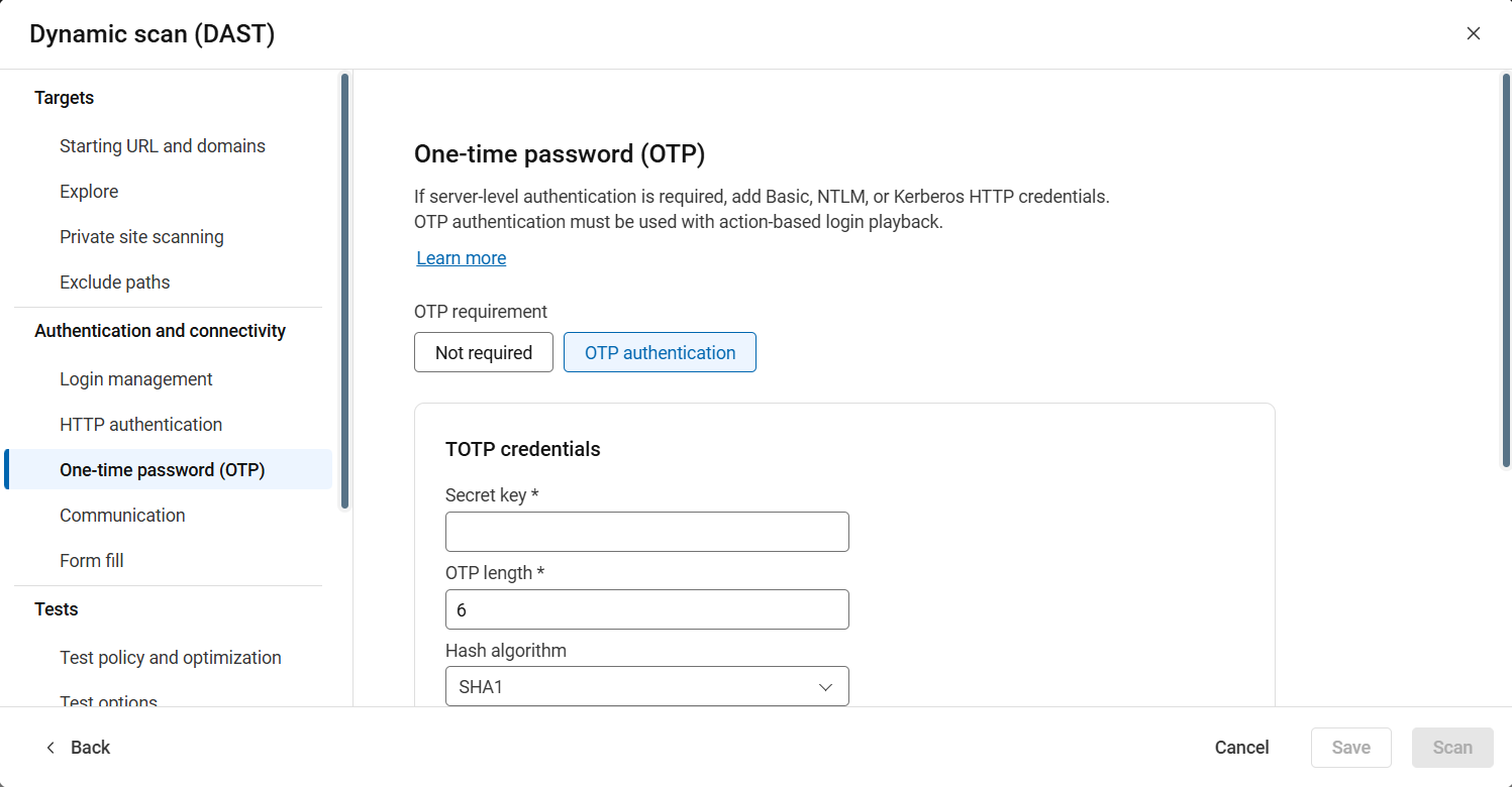

  10. Authentication and connectivity: One-time password
    If your site requires a time-based one time password for users to log in (MFA), select this check box and complete the first four fields in the dialog.
    Setting
    Options
    Use TOTP
    • Secret key
    • OTP length (number of digits)
    • Hash algorithm used (select from drop-down)
    • Time step (in seconds)
    TOTP is the only OTP supported in this wizard. For more OTP options you can configure a scan in AppScan Standard and upload to ASoC. When configuring a scan in AppScan Standard with OTP, you must use action-based login, not request-based login, see the AppScan Standard documentation for details.
    OTP HTTP parameters (optional)
    If you used "Login required: Recorded login" in the previous step, this last field is not usually required, as AppScan usually identifies the OTP headers itself, when validating the recorded login procedure at the start of the scan.
    If you used the Login required: Username and password, you must add the parameter here. If there is more than one, separate them with commas.
    Example of a possible OTP header: OTPvalue
    How do I identify the OTP HTTP-parameter?

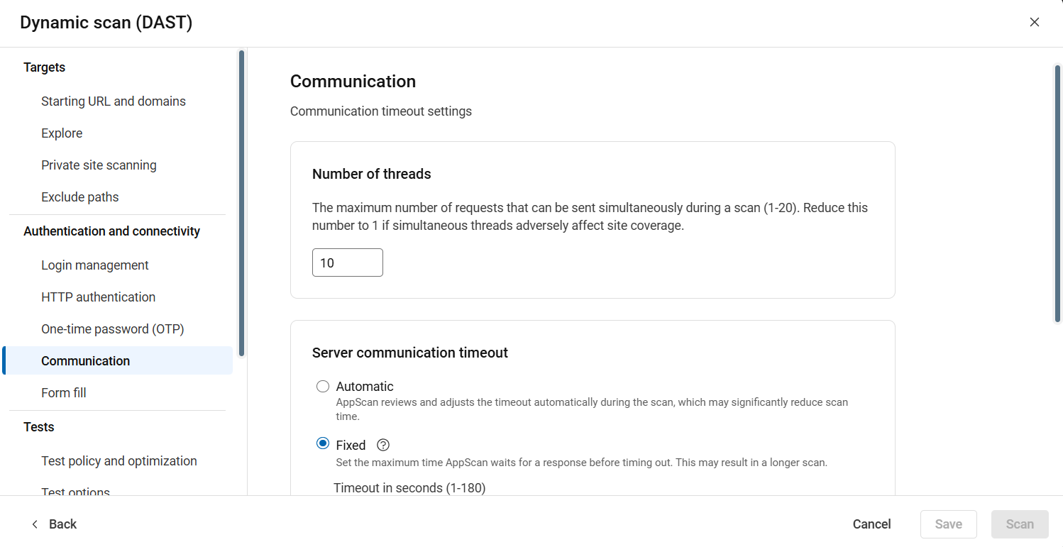

  11. Authentication and connectivity: Communication
    Set the maximum number of requests that ASoC can send to the site simultaneously.
    Setting
    Options
    Number of threads
    Reduce the limit if your site does not allow this amount; if your site does not allow simultaneous threads at all, reduce the limit to 1.
    Server communication timeout
    Adjust automatically during the scan
    Allow ASoC to decide how long to wait for any particular response before timing out. This can significantly reduce scan time.
    Fixed
    Set the maximum time ASoC waits for a response before timing out. Increase this setting if your site's responses are slow and ASoC is missing responses due to the short timeout.
    Max request rate
    By default, ASoC sends its requests to the site as fast as possible. If this limit will overload your network or server, you can reduce it.

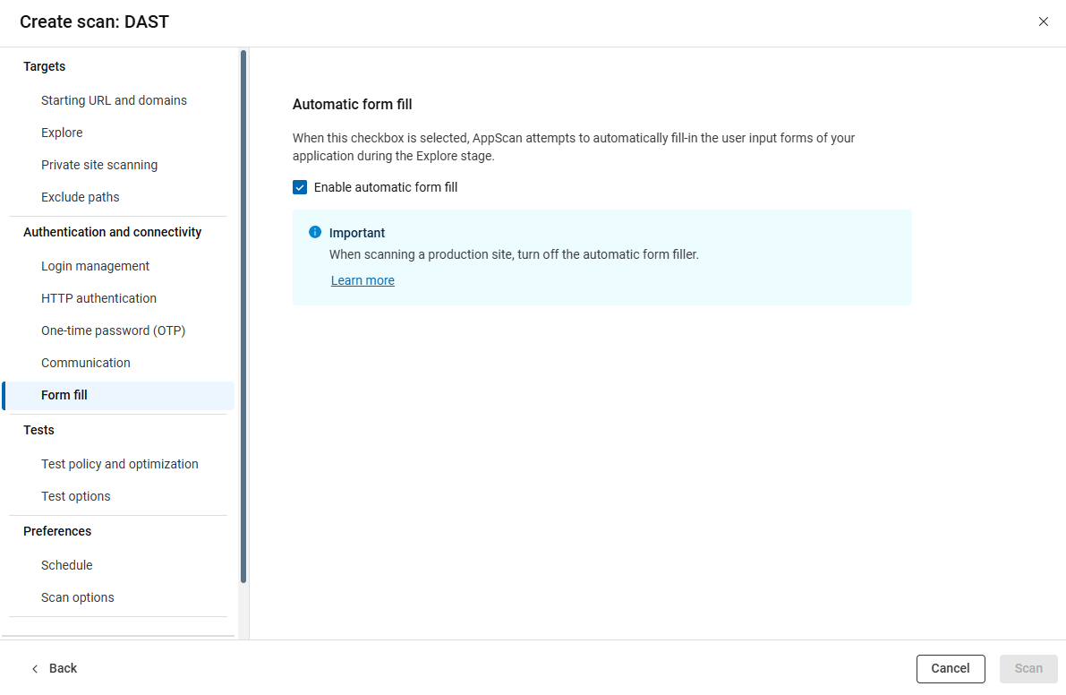

  12. Authentication and connectivity: Form fill
    Choose if ASoC should automatically fill in the user input forms during the explore stage of the scan.
    Setting
    Options
    Automatic form fill
    ASoC uses AppScan Standard's default form fill parameter values to fill and submit forms on the site.
    Important:
    If you are scanning a live production site, we recommended disable this function. For more details refer to What changes should I make when scanning a live production site?
    If you turn off automatic form fill and scan in AppScan on Cloud, it will remove all the information filled in the forms except for the login management data. AppScan will not fill in the forms automatically during scanning. When you import this scan into AppScan Standard, automatic form fill is enabled, but the form filling data, except for login management, will be empty.

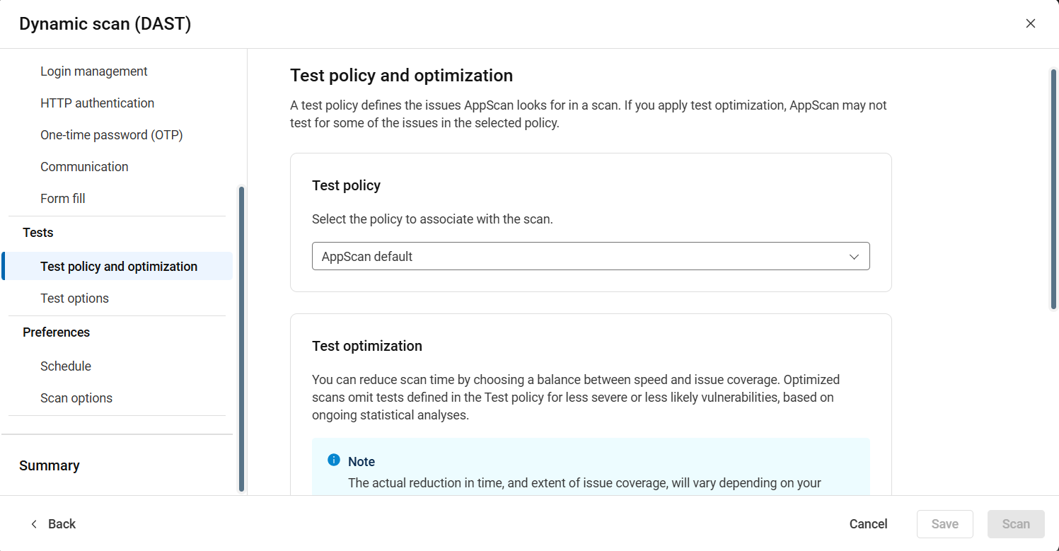

  13. Tests: Test policy and optimization
    Define the collection of tests that will be sent to the application during testing (the test policy), and apply optimization for faster scans at times in the product lifecycle when speed is more important to you than scan depth.
    Setting
    Options
    Test policy
    Select one of the five predefined test policies or a custom policy based on the level of coverage required. The default is Default that includes all tests except invasive and port listener tests. For details, see Test policies.
    Tip:
    Test policy is different from application compliance policy.
    Test optimization
    Select the level of tradeoff between scan speed and issue coverage for your needs. The slider offers four levels. The default is Fast. For details, see Test Optimization.

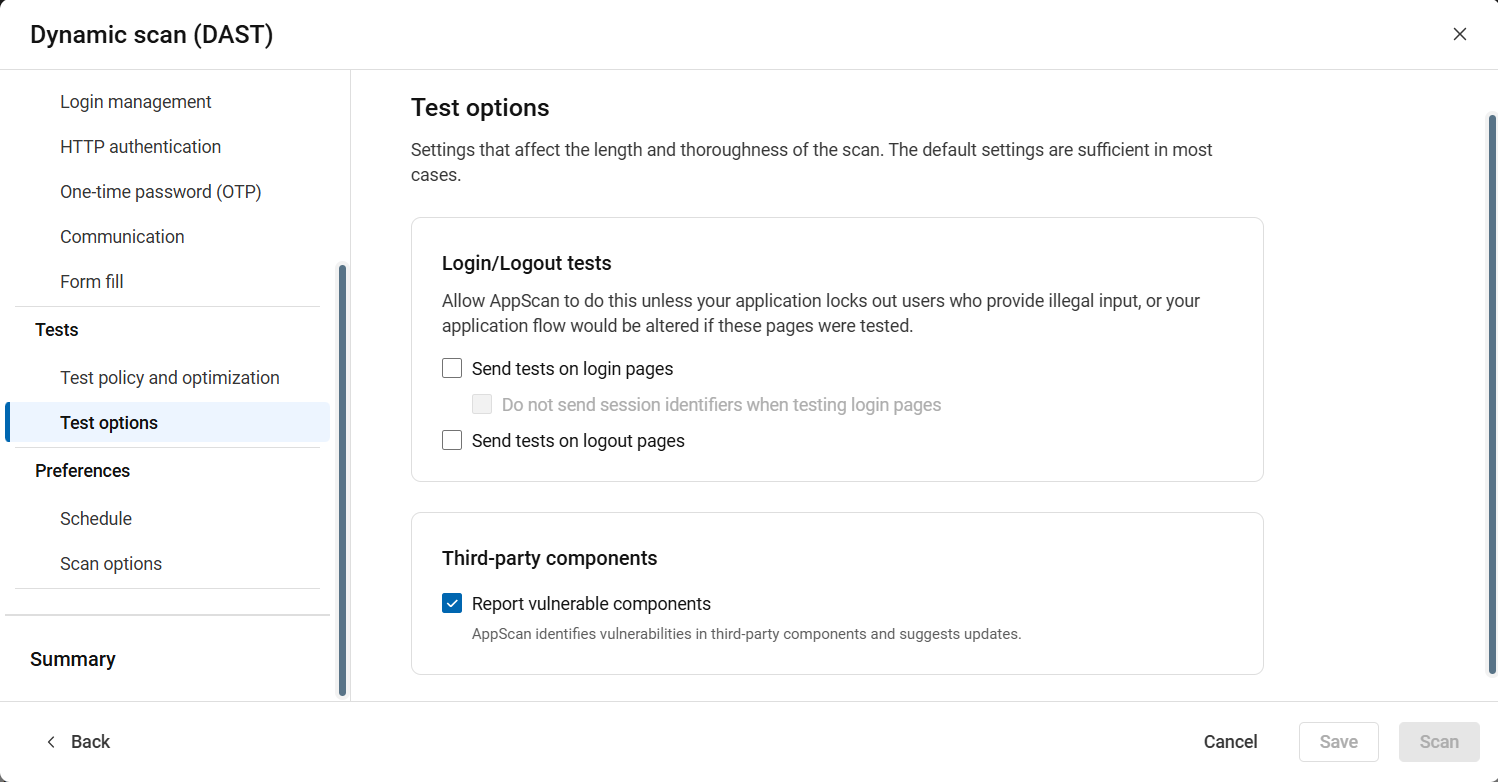

  14. Tests: Test options
    Choose whether to send tests on login and logout pages. If you choose to send tests on login pages, specify whether to send session identifiers.
    Setting
    Options
    Login/Logout tests Choose whether to send tests on login and logout pages. If you choose to send tests on login pages, specify whether to send session identifiers.
    Report vulnerable components AppScan finds vulnerabilities in third-party components and recommends updates.

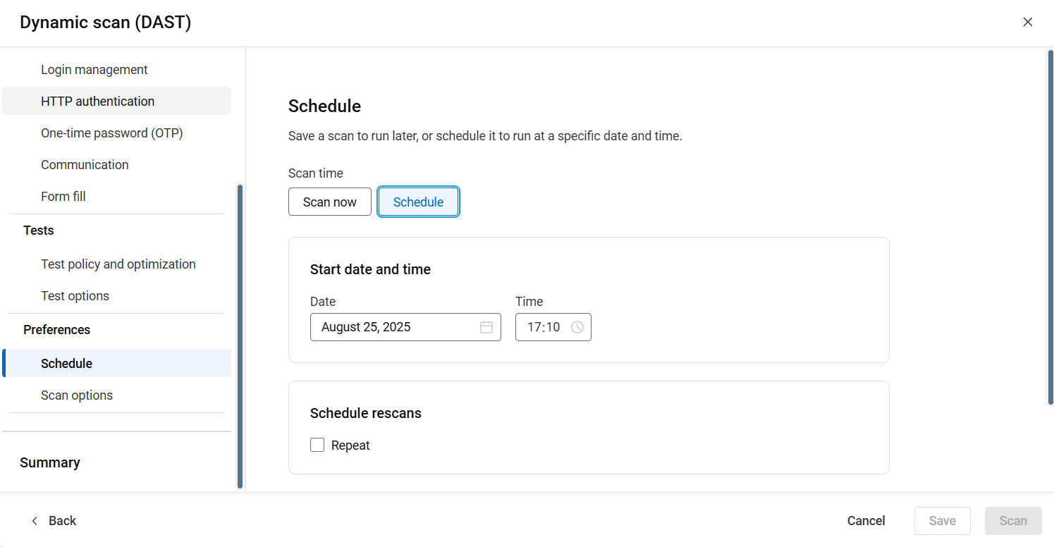

  15. Preferences: Schedule
    Specify when the scan runs: now, later, or on a schedule.
    Setting
    Options
    Scan now
    Your scan runs as soon as set up and review are complete.
    Save for later
    Your configuration is saved when completed. You can run the scan later.
    Schedule
    Your configuration is saved, and one or more scans run as configured:
    1. Select a date and time. Enter these according to the time zone configured on your machine, but note that times will be converted to UTC when displayed in the user interface.
    2. To run the scan more than once, select the Repeat, and then choose:
      • Daily, and select a daily interval (1-30 days)
      • Weekly, and select which day, or
      • Monthly, select a monthly interval, and then select which numerical day of the month, or which weekday of the month (first, second, third, fourth, last).
      If the maximum number of concurrent scans are running when the scheduled time arrives, the scan starts as soon as allowed by your subscription.
    3. Set the End date (the last date a scan will run), or click Remove end date to have the schedule run indefinitely.

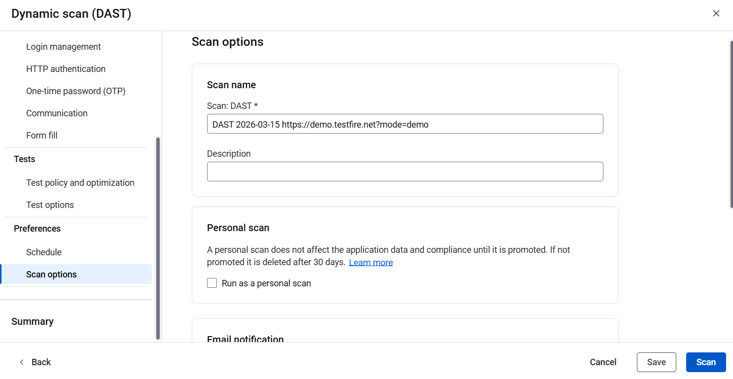

  16. Preferences: scan options
    In the Scan options panel, you can:
    • Update the Scan name if required.
    • Add a Description to add more context to your scans.
    • Elect to run the scan as a Personal scan.
    • Specify Scan enablement. By default, the Allow intervention check box is selected. This means that if ASoC detects that the scan may produce poor results with the current settings, it alerts the Scan Enablement Team to review them. The scan status changes to Under Review and resumes when review is complete (see Scan status).
      • If you do not want to allow intervention by the Scan Enablement Team, clear the check box.
      • If you allow intervention, you can include a message to the team if you think they might need specific information to resolve an issue. Optional.

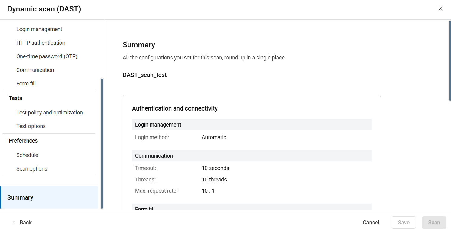

  17. Summary
    Edit the name of the scan, if desired, and review the settings selected for the scan. Click back to previous panels to make adjustments if needed.
  18. Click Scan.
The new scan is added to the Scans view with its starting time, and a progress bar indicates that the scan is running. When the scan is complete the progress bar closes, and the results are summarized in a graph. See Results.
