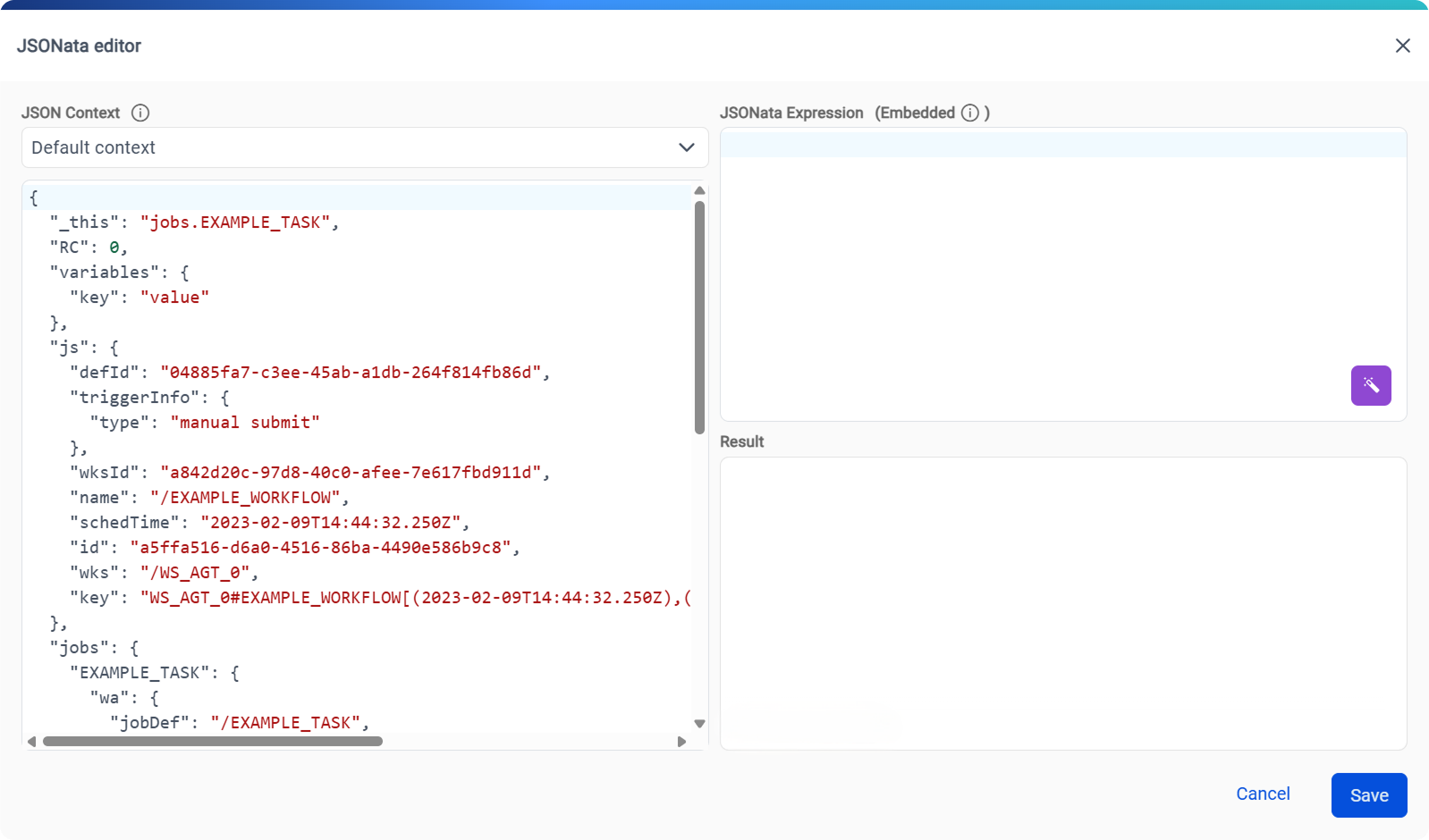

JSONata expressions power output conditions, output properties, pre-conditions, and task input fields in the Graphical Designer. Writing them without feedback — and only discovering errors when the workflow ran — meant debugging under production conditions. The JSONata editor removes that constraint: validate expressions against real data before a single run is submitted. The dialog provides a JSON Context pane for loading run data alongside an Expression pane for writing and evaluating expressions in real time.

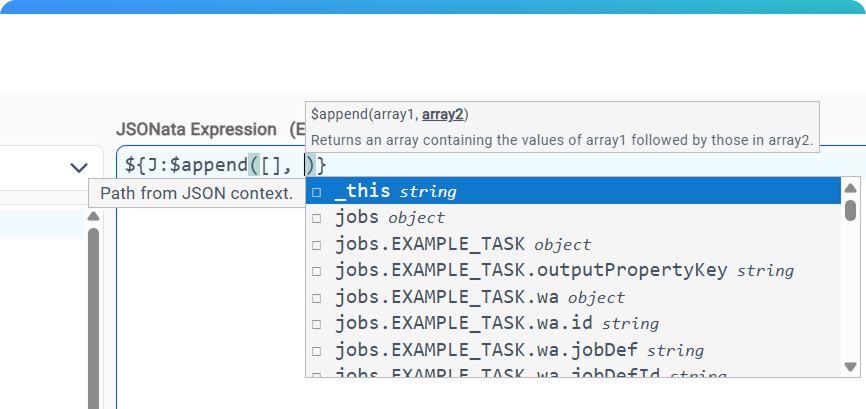

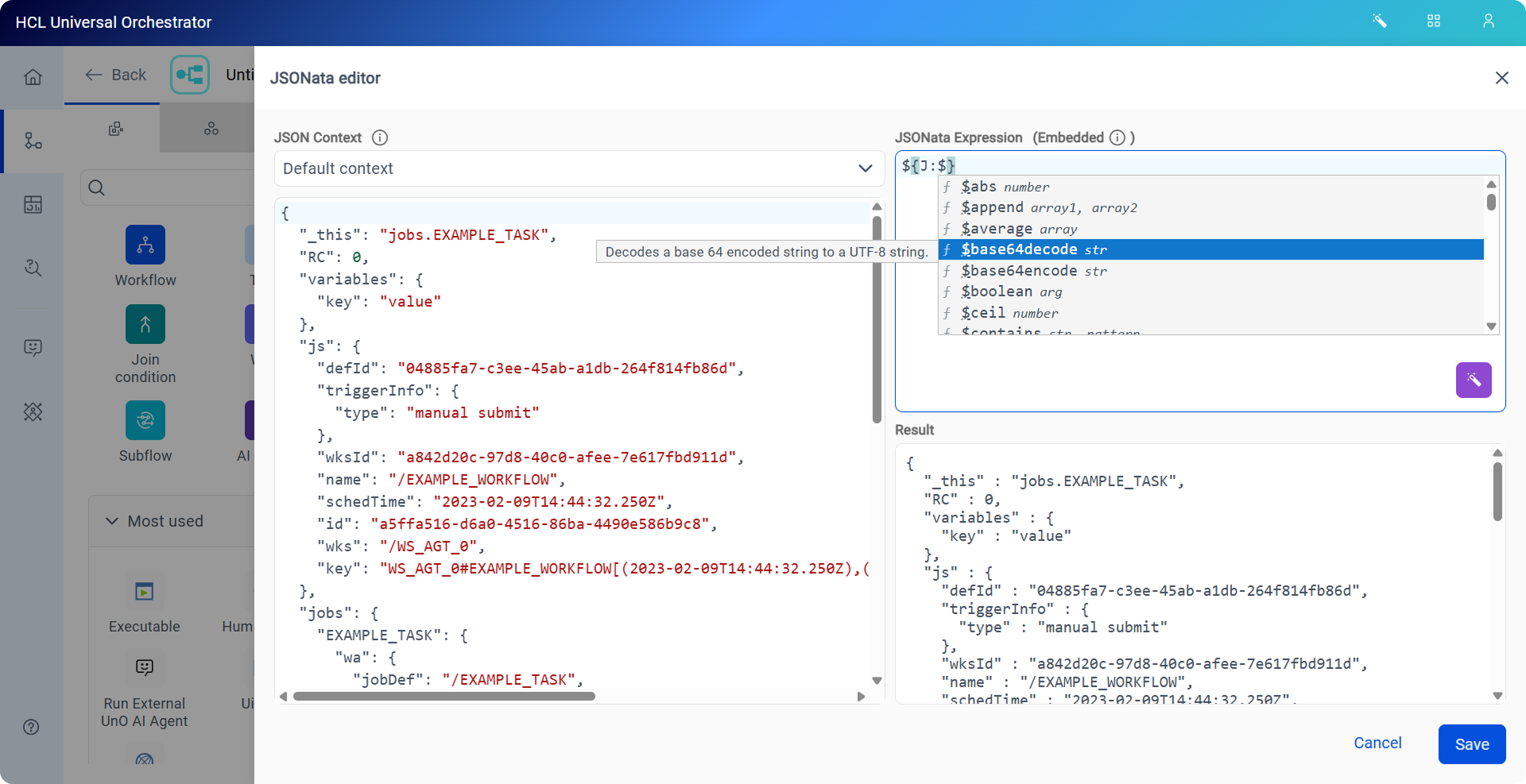

The evaluation result updates as you type: no button to click, no round trip to wait for. Load the JSON context directly from a previous production run and you are testing against the same data your workflow will actually encounter. Syntax errors and type-validation warnings appear inline, so you can fix them before they reach a live deployment. Function autocomplete lists built-in JSONata functions with a tooltip describing each one, so you can write correct expressions without switching to external reference material.

Every evaluation is performed by the HCL Universal Orchestrator engine, the same runtime that runs your workflows in production. An expression that evaluates correctly in the editor will behave identically when the workflow runs. Both Boolean mode, for conditions that must resolve to true or false, and Embedded mode, for template strings that combine static text with dynamic values, are supported. Autocomplete suggestions include both function signatures and JSON path completions derived from the loaded run data, so every suggestion reflects the actual data structure your workflow will encounter.

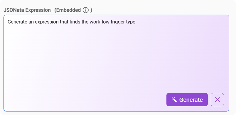

Not sure how to express a complex transformation in JSONata? Click Generate Expression, describe what you want in plain language, and the editor proposes a complete expression you can immediately evaluate, refine, and save. Even experienced users find it faster to generate a starting point for complex logic than to write it from scratch.
