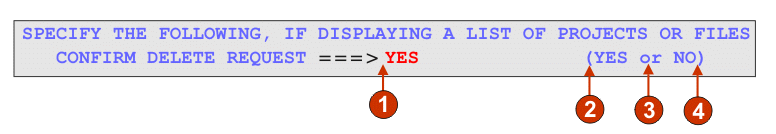

Product code: [ ] (Valid codes: A, B, C, D)
In this example, the start of the hints is Valid codes:, the end of the hints is a close parenthesis [)], the separator is a comma (,), and the leading token type is None.
- Delimiter: position of delimiter, but leading token type was set to None.
- Start of hints: open parenthesis (
- Separator: or
- End of hints: close parenthesis )
