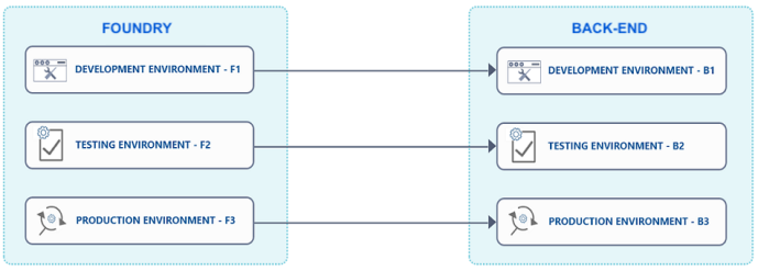

With service configurations, you can redefine the endpoints to which your Foundry application connects per environment.
Consider a scenario in which your app uses different back-end environments for different Foundry environments. For example: If your app runs on Foundry environment F1, it must connect to the back-end environment B1; and if the app runs on Foundry environment F2, it must connect to back-end environment B2.
This is useful because you typically want a development Foundry environment to connect to a development back-end environment, and so on for higher environments such as testing, UAT, or Production.
To avoid manually reconfiguring the endpoints every time you publish the app, you can create a service profile file, which contains the set of different back-end endpoints for a specific Foundry environment. You can then import the service profile when you publish the app. For example: You can import the service configuration for Foundry environment F3 to configure the endpoints for back-end environment B3.

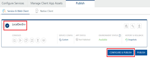

  1. In the Publish > Service & Web Client page, select the required environment.
  2. Click CONFIGURE & PUBLISH.

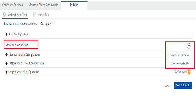

  3. In Service Configuration, click the More Options button. The Import Service Profile and Export Service Profile options are shown in the list.
    • To export the service profile, click the Export Service Profile option. The service profile details are downloaded in a JSON file.
      Note: The Export Service Profile option downloads the format version 2.0 with level as Delta. This reconfig file is in simplified JSON file structure.
  4. To import the service profile, click the Import Service Profile option and navigate to the required JSON file of a service profile.
