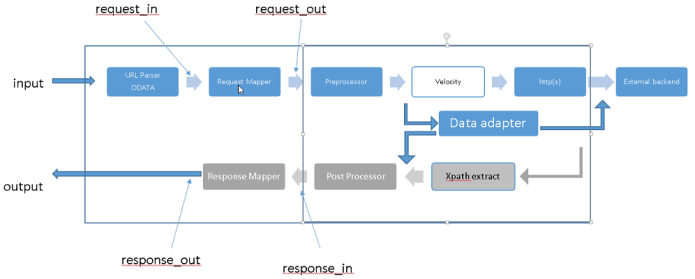

The following diagram shows the Object Services pipeline.
Request Mapper
On the input, when the mapper is applied, it is equivalent to the following.
mapper("input mapper xml", $current_input = data)
The $data is logically a blob with all the context made available to the mapper. You are passing in transformational XML to run on the current input. The mapper input can access any of the data that is passed to it.
request_in : Read-only, input payload JSON from API request.
request_out : Read-write, (a copy of input payload), transformed JSON that is sent to next stage.
vars : Empty. This is referenced using $vars and is used by mapper XML as a global variable store

On the output, when the mapper is applied, it is equivalent to the following.
mapper("output mapper xml", $current_input = data)
response_in : Response from back end logically represented as JSON.
response_out : Transformed JSON using the XML mapper sent in the "records" field of the API response.
vars : Empty. This is referenced using $vars and is used by mapper XML as a global variable store.
