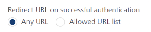

  • In the login options, you can pass the Success URL parameter (which is the web app URL) as part of the "customQueryParamsForOAuth" key.
  • In the Identity console, under Advanced → Redirect URL on successful authentication
    • If you have selected Allowed URL list, make sure that the specified Success URL is whitelisted.
    • If you have selected Any URL, you do not need to whitelist any URLs.
