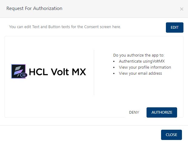

    Disable Consent Screen Specifies whether the consent screen must be disabled.You can also configure the consent screen by clicking Configure.This parameter is applicable only if one of the Supported Grant Type is Authorization Code.
    For more information about configuring the consent screen, refer to Editing the consent screen.

      A consent screen displays the details of resources to which access is granted.
    5. After you authorize access to th resources, an authorization code is generated and the screen is redirected to a new URL with the code as the query parameter.

    While configuring the OAuth Provider identity service, you can also configure the consent screen. The option to configure the consent screen is available in the Advanced section of the service configuration page.
    To edit the consent screen, click EDIT.
    You can edit the following elements of the consent screen:
    • Screen title: The title of the window that displays the consent screen.
      The default value is Request for Authorization.
    • Permissions: The set of permissions that require authorization of consent.
      You can use the HTML tags that are specified on the edit screen to format the content.
    • Button Text: The text that is displayed on the DENY and AUTHORIZE buttons
    From V9 ServicePack 2, the consent screen contains a Remember Consent option. If the user enables the option and provides their consent for the app, the OAuth provider does not display the consent screen for subsequent sign-ins. Therefore, the user does not have to provide consent every time they sign-in to the app.
    Note: The OAuth Provider uses cookies that specify whether the user has provided consent for the app. Cookies are specific to a browser, therefore, if the user signs-in to the app from a different browser, the consent screen is displayed, and they need to provide consent for the app.
