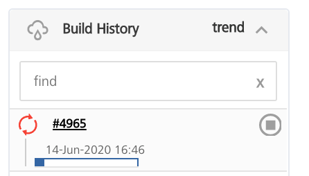

  4. After you configure the parameters for the buildFoundryApp job, click BUILD.
After a Build is successfully triggered, you can check the status of the build in the Build History panel. The following screenshot displays a build that is in progress (#4965) with the progress indicator icon.
You can click the icon to see the detailed output of the current build, or click the progress bar to open the build page of the job. From the build page, you can click Console Output to display the detailed output of the running build.
