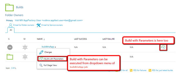

To run a build flow navigate to the buildIrisApp job under new App Factory project folder, click Build with Parameters in the menu on the left side of the screen. If it is the first time you perform a build, you need to configure the build job. For future builds, the App Factory stores the settings from the previous build to make configurations of the future builds easy. The following steps and screenshots show how to access the Build with Parameters for the job.
Open an app project folder and navigate to Iris/Builds/buildIrisApp.
You can access the Build with parameters option for a job in the following ways.
- On the right of job list, you can select the icon which represents Build with Parameters action.
- You can open drop-down menu at the buildIrisApp job and choose Build with Parameters action from the list.
- You can open the buildIrisApp job and execute Build with Parameters action on the left panel of the job.

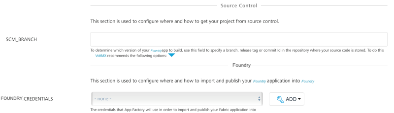

Source control related
- PROJECT_SOURCE_CODE_BRANCH - branch required to point Git client to the branch you push your application code. Git is supported only.
PROJECT_SOURCE_CODE_REPOSITORY_CREDENTIALS_ID is required for access to repository where your Iris project is stored.
Important: Provide Git credentials depending on git URL format. If https link is provided, then user credentials (Username and password) are sufficient. In case of ssh link - ssh key needs to be added.
Note: If your repository is protected with 2FA (two-factor authentication) in GitHub, you need to add the GitHub credentials to your project. For more information, refer to GitHub 2FA. If you want to add SSH credentials, refer to Add SSH Key Credentials.

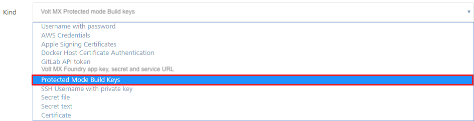

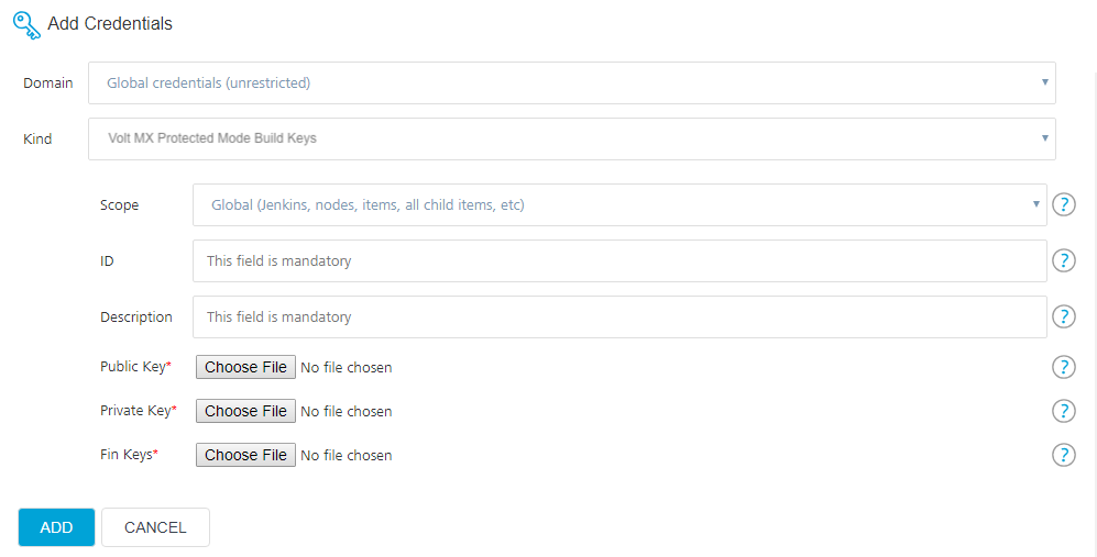

Perform the following steps to add a new build keys for the buildIrisApp job.
Click Add drop-down list displayed across PROTECTED_KEYS.
The drop-down list displays the list of Credential Providers.
Select a Credential Provider from the list.
The Add Credentials window displays.
Enter the following details to add a new protected keys.
- Domain: Displays the domain name as Global Credentials (Unrestricted).
Choose Kind as Volt MX Protected Mode Build Keys from the drop-down list.
Scope: Determines where the build keys are used. The Global credential is available to the object on which the credential is associated and on all the child objects of the object. Typically, you must use the global-scoped credentials for jobs.
- Enter ID. It is an internal unique ID used to identify the credentials from jobs and other configuration.
- Enter Description.

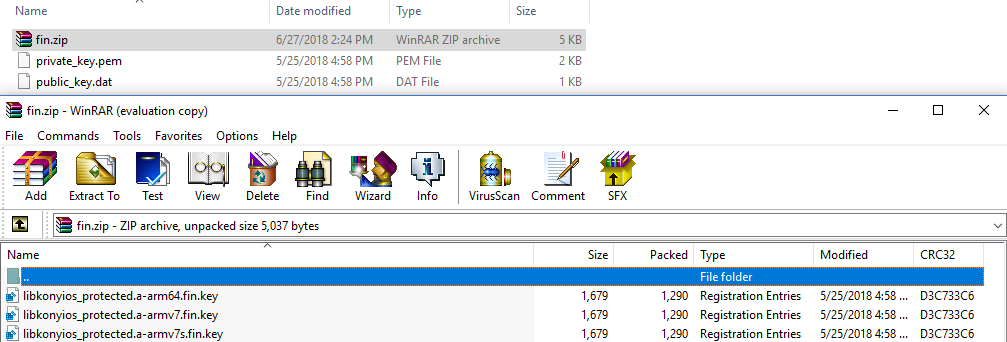

Upload Public Key, Private Key, and Fin Keys files.
Fin Keys must be provided as a zip file. It should not have any sub-folder within the zip.
Click Add. The new Volt MX Protected buildIrisAppMode Build Keys is added in project. 3. Click PROTECTED_KEYS drop-down list.
You can find the new build keys in the drop-down list.
Select the new build keys.

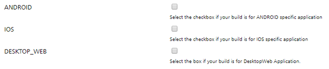

Builds
In order to run the tests, you must select any of the following channels listed.
- ANDROID - Select the checkbox if your build is for ANDROID specific application. All the android related parameters appear once you select the checkbox.
IOS - Select the checkbox if your build is for IOS specific application.
Note: App ID must be registered prior to the build of any Apple artifacts! Please refer to: Maintaining Identifiers, Devices, and Profiles.
DESKTOP_WEB - Select the checkbox if your build is for DesktopWeb specific application.

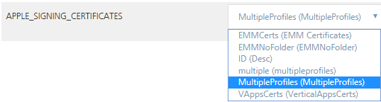

APPLE_SIGNING_CERTIFICATES - Upload an Apple Signing Certificate to App Factory to sign your app for iOS native channels.

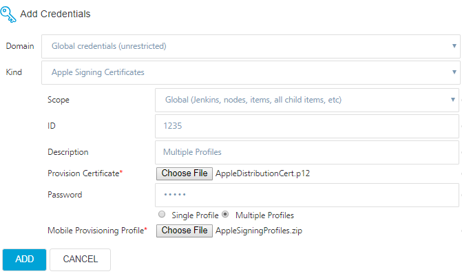

Adding a new signing certificate: To add a new signing certificate, follow these steps:
- Click Add drop-down list that displays the list of Credential Providers across APPLE_SIGNING_CERTIFICATES.

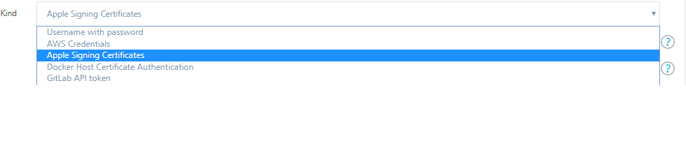

The Add Credentials window displays. Enter the following details to add a new signing certificate:
Choose Kind as Apple Signing Certificates from the drop-down list.
Scope: Determines where the signing certificate is used. The Global credential is available to the object on which the credential is associated and on all the child objects of the object. Typically, you must use the global-scoped credentials for jobs.
- Enter Description for the signing certificate.
- Upload the Provision Certificate to sign the IPA.
- Enter a password for the uploaded provision certificate.
- Upload a Mobile Provisioning Profile.
- For single profile, upload a mobile provision file.
- For multiple profiles, you must upload a zip that contains multiple mobile provision profiles.
Click Add. The new signing certificate is added in buildIrisApp project.
Click APPLE_SIGNING_CERTIFICATES drop-down list to find the new certificate.
Select the certificate.

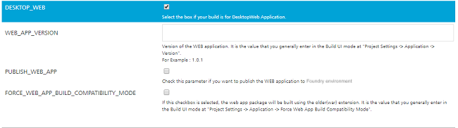

PUBLISH_WEB_APP enabled if user want to publish the App to Volt MX Foundry Cloud/OnPrem.
If you are building both DesktopWeb and SPA channels and the checkbox is selected, a combined archive is generated and published to the selected Volt MX Foundry environment.
WEB_APP_VERSION: App version of the Web (DesktopWeb and SPA) application. The app version value is entered in the Build UI mode at Project Settings>> Application>> Version.
Example: Version 1.0.1
FORCE_WEB_APP_BUILD_COMPATABILITY_MODE: Enable the checkbox to build the web app package using the older (war) extension. It is the value that you generally enter in the Build UI mode at Project Settings>> Application>> Force Web App Build Compatibility Mode.
.war extension is not supported with multi-tenant environment in Volt MX Foundry.
Newer extension (zip) is only supported with V8 service pack 2 on Volt MX Cloud. If your app is using a lower set of plugins, keep the checkbox enabled.

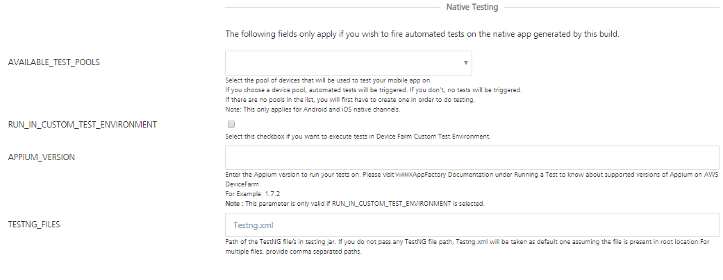

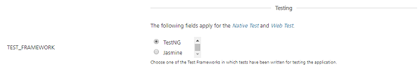

Testing
Note: Make sure that you have selected appropriate channels to build in order to run the tests.
TEST_FRAMEWORK- Choose one of the Test Frameworks in which tests have been written for testing the application.
RUN_NATIVE_TESTS - Select this checkbox if you want to execute Native tests. If you select this checkbox, the following fields appear depending on the type of test framework selected:
TestNG
- TEST_ENVIRONMENT - Select the environment to run the tests. The options available are Standard and Custom.
APPIUM_VERSION- Enter the appium version to run your tests. New version such as 1.9.0 will be installed on the environment as a part of AWS run. This field is applicable for Custom test environment.
For more information on supported versions of Appium on AWS DeviceFarm, refer Custom Test Environment Run.
For information on artifacts available in the notification mail for AWS Custom Environment Run, refer Building an App in AWS Custom Environment.
TESTNG_FILES Path of the TestNG file(s) in your testing JAR. Testng.xml located in the root of the JAR is selected by default. You can specify the path of your TestNG file. This field is applicable for Custom test environment.
To specify multiple TestNG file paths, use comma separated path values such as
voltmx/Testng.xml,voltmx/appfactory/Testng.xml,testng.xmlhas three TestNG files at different locations to be rendered.
Jasmine
- NATIVE_TEST_PLAN - Enter the relative path of test plan (ex: testRunner.js) that you would like to execute. This path should be relative to the "/testresources/Jasmine/Mobile/Test Plans" or "/testresources/Jasmine/Tablet/Test Plans" folder. If no value is provided, the default plan(testPlan.js) will be executed.
AVAILABLE_TEST_POOLS enables tests on selected device pool.
For more information about device pools, refer to Configuring Device Pools.
Native Testing related Parameters - The following parameters are applicable only if you want to fire automated tests on native app generated by this build.
RUN_IN_CUSTOM_TEST_ENVIRONMENT click the checkbox to execute tests in Device Farm on Custom Test Environment. For more information on refer Custom Test Environment Run.
If the checkbox is not selected, the tests are executed in Standard mode.

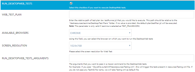

Web Testing related Parameters: The following parameters are applicable only if you want to fire automated tests on web app generated by this build.
RUN_DESKTOPWEB_TESTS - select the checkbox to execute DesktopWeb tests. The following fields appear:
Note: Prerequisites for testing:
Appium tests must be placed under/test/testNG folder.
Selenium tests (DesktopWeb tests) must be placed under/test/testNG/DesktopWeb. - WEB_TEST_PLAN - Type the relative path of test plan (ex: testRunner.js) that you would like to execute. This path should be relative to the "/testresources/Jasmine/Desktop/Test Plans" folder. If no value is provided, the default plan(testPlan.js) will be executed. This is applicable only for Jasmine test framework.
RUN_DESKTOPWEB_TESTS_ARGUMENTS - allows you to pass arguments in Maven command to the DesktopWeb tests.
Example: If you pass -Dsurefire.suiteXmlFiles=resources/Testng.xml, the argument will trigger the tests present in resources/Testng.xml file. If you do not pass TestNG file, Testng.xml is selected as a default file.
AVAILABLE_BROWSERS - allows you to select the browser to run the DesktopWeb tests.
Currently, App Factory supports only Google Chrome version 68.0.3419.0 for DesktopWeb testing.
SCREEN_RESOLUTION - Select the screen resolution from the list.

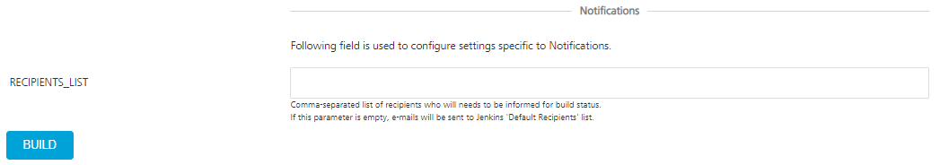

- Notifications - The following parameter is used to configure settings specific to notifications.
RECIPIENTS_LIST is comma-separated list of recipients e-mails.
Click Build to build the Iris app.
