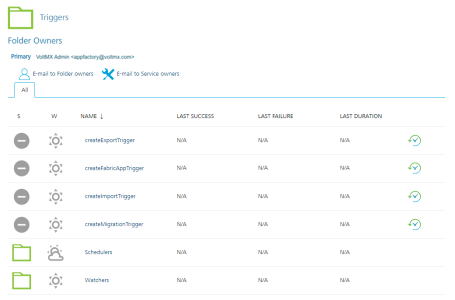

Every project contains a sub-folder called Triggers in the Foundry folder. The Triggers folder contains a job called createFoundryAppTrigger (to create auto-triggered jobs), and two sub-folders called watchers and schedulers (to store the created jobs).

  1. From the Foundry folder of your project, navigate to Triggers.
  2. In the Triggers folder, click the build icon for the createFoundryAppTrigger job.

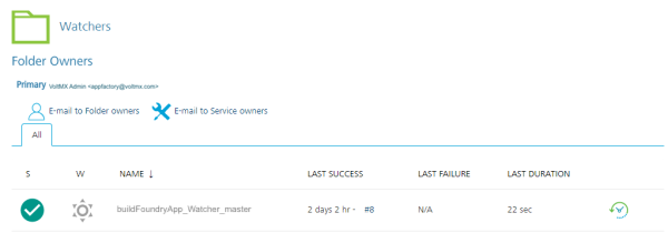

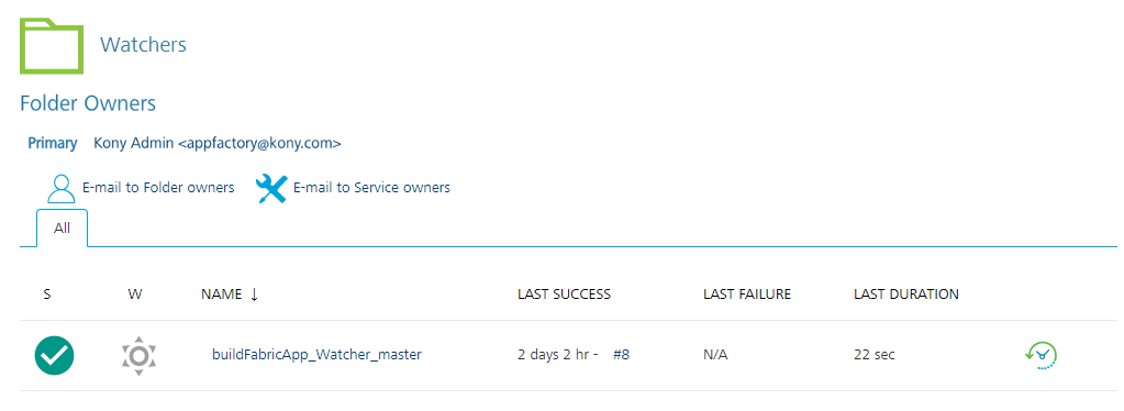

Jobs that are triggered by a push to the SCM are stored in the watchers folder. Every Watcher includes the branch in the name of Job to simplify searches.
