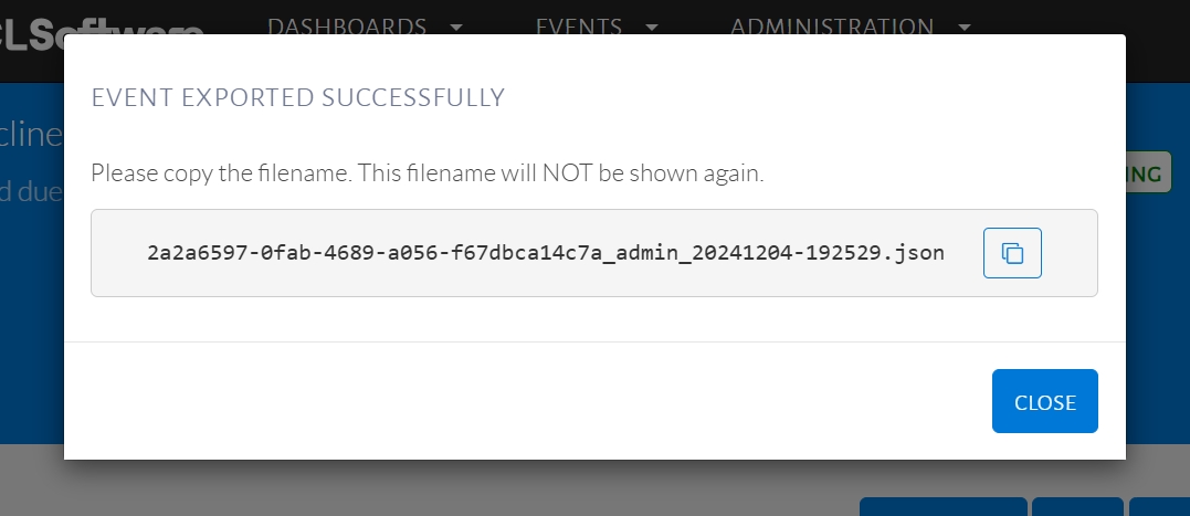

- VIA FILE: To export the existing event as file in the server
instance. Click OK in the confirmation popup, and copy the file name
for further usage. The exported event .json file will be stored in the
"<Installation_Location>/Instance_Home/export" server
location. A popup with file name is shown as below.

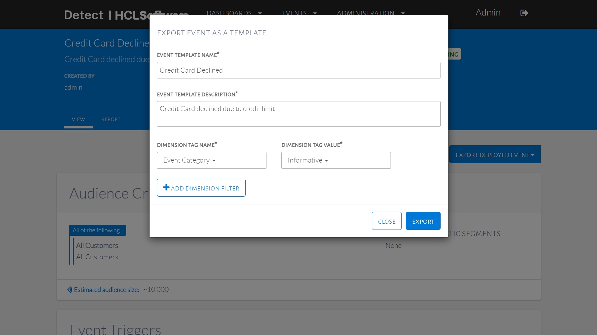

- VIA TEMPLATE: To export the existing event as a template. If this
option is selected, enter Template name and description. Also, make sure to
select the dimension tag and value as shown below.
- Click Export. As a result, the deployed event will be stored in the server instance and displays the file if the VIA FILE option is selected and will be listed as template if the VIA TEMPLATE option is selected.
