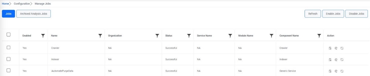

  1. On the main menu bar, click Configuration.
  2. Click Manage Jobs.
  3. The Manage Jobs page appears.
    Figure 1. Manage Jobs
  4. It lists the job name, organization, and status, assigned service type, module name, and component name in a tabular view. Users can view the job log, modify the properties of jobs and can change the status of the job.
  5. There are two tabs on this screen-
    1. Jobs tab lists the job name and status, assigned service type, module name, and component name of all the jobs except successfully completed analysis jobs in a tabular view. Users can view the job log, change the status of the job or edit the job properties.
    2. Archived Analysis Jobs that list the job name and status, assigned service type, module name, and component name of all the analysis jobs that are completed successfully in a tabular view. Users can only view the job log.

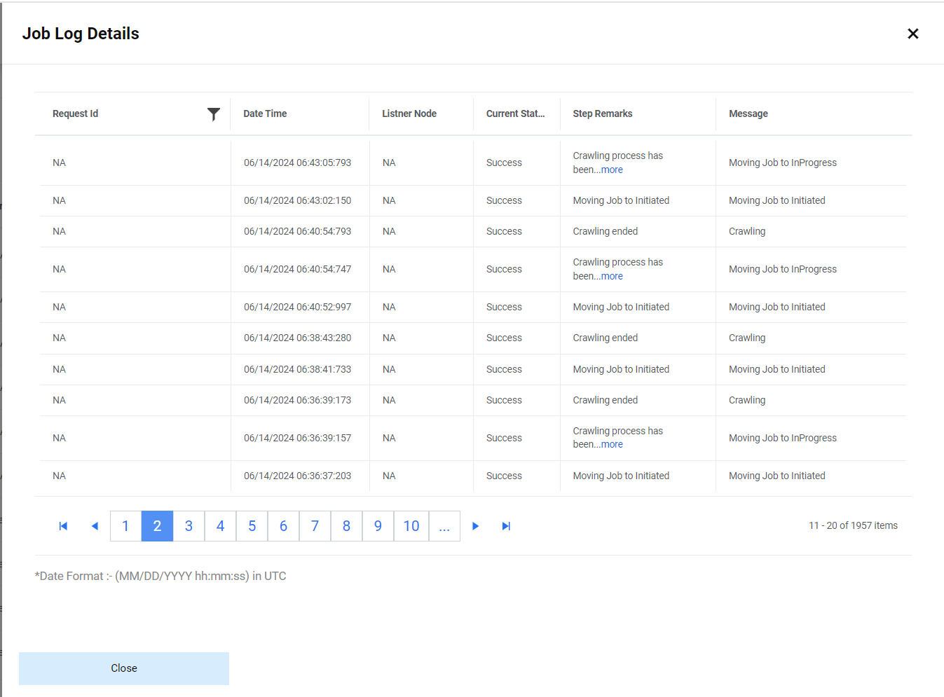

View Job Log
The job log displays information about job execution. In the Job Log Details view, every row provides details of the job execution. The number of log entries kept depends on the configuration of the scheduled procedure responsible for clearing old log entries. It creates separate log files for each job.
To view the job log details, perform the following steps:
  1. On the Manage Jobs screen, click in the Action column next to the job user wants to review in the job log.
    Figure 2. View Job Log
  2. The Job Log Details page appears.
    Figure 3. View Job Logs
The log contains information about specific job execution, which includes the following:
  • The request Id for the job and the user can filter the data based on the request Id
  • The date and time when the job was run.
  • The listener node that has picked the job for processing.
  • The status of each job is displayed with the help of system generated messages relevant to the job execution in the Message column.
  • Step Remarks which show the step wise processing of the job.
  • Messages that apply to each step in the Step Remarks column.

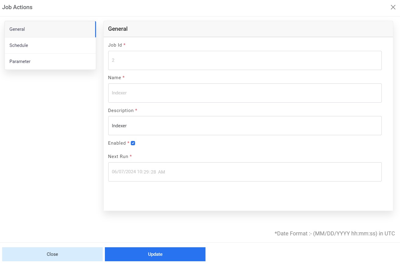

  3. Click General to configure the general details of a parameter by filling in the following attributes.
    1. Type the unique parameter name within the job in the Name field and then type the parameter description in the Description field.
    2. If the user wants to enable the added parameter for execution, select Enabled.

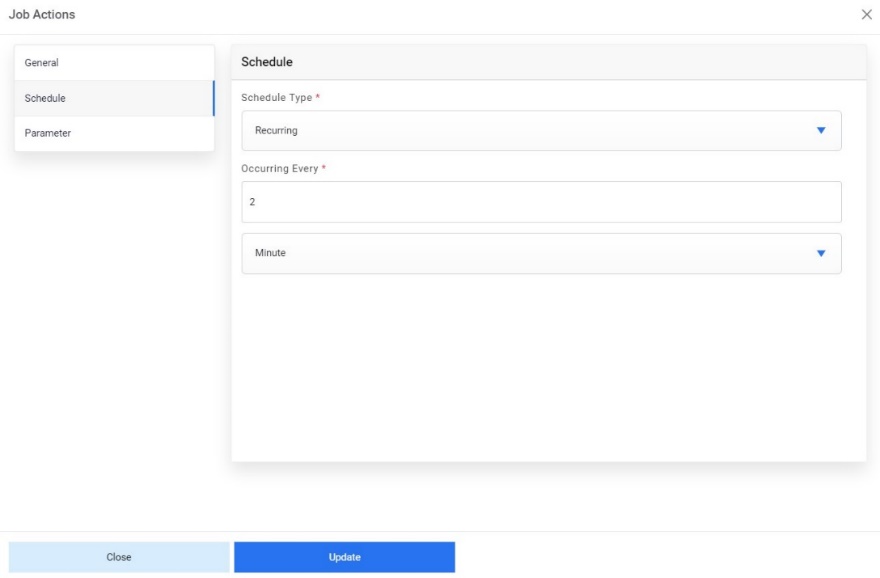

  4. Click Schedule to provide parameter details to schedule a job. The user can schedule jobs to automatically run at a particular date or time and/or on a recurring basis.
    • Schedule Type: This allows the user (Organization Admin) to schedule job updates. The drop-down menu lists the following options:
    • Select One Time, if you want to schedule the job update only once, then select the Date and Time to schedule and then click Save to update the schedule.
      Figure 7. Manage Job Parameters (Cont.)
    • Select Recurring, to schedule a recurring job update, then type the numerical value for the schedule next to the Occurrence Every field, and then click the drop-down list to select the duration in seconds, minutes, hours, monthly, or daily.
      Figure 8. Manage Job Parameters (Cont.)

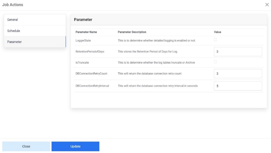

  5. Click Parameter to enable the added parameter. Switch the value button to Enable the parameter value.
    Figure 10. Manage Job Parameters (Cont.)

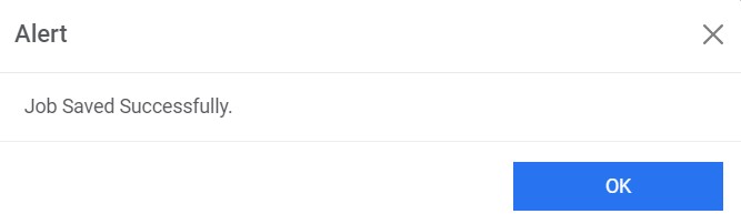

  6. Click Save.
    User can click Save after updating General, Schedule, or Parameter tabs and save the updates.
  7. A confirmation dialog box appears.
    Figure 11. Manage Job Parameters (Cont.)
    There are few parameters that have significance in ticket execution.
    For DataCollector job, there’s a parameter ‘ReassignCount’ which is a number to determine the number of times reassigned ticket will come to queue.
    For RunRecommendation job, there’s a parameter ‘IsOrderByPriority’ which on enablement sorts the tickets based on their priority on Tickets screen.
    For RunParsing job, there’s a parameter ‘IsReleasedBasedOnNullValue’ which on enablement releases the ticket if any of the runbook parameter value is null.

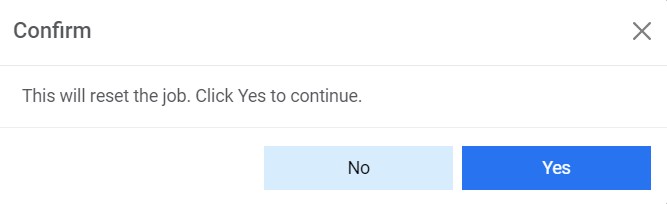

Reset Jobs
This section describes how to reset a job definition before an execution or resubmission.
To reset a job, perform the following steps:
  1. On the Manage Jobs page, click in the Action column next to the job user wants to reset.
    Figure 12. Reset Jobs
  2. Click Yes to confirm.
    Figure 13. Reset Jobs (Cont.)
    The administrator cannot reset successful jobs and jobs with schedule type selected as One Type.
