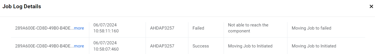

Table 1. iRecommend: Scenario 8
Issue description Failed to recommend jobs after setting configuration
Module impacted IRecommend
Probable root cause
Figure 1. Failed to Recommend Jobs
Resolution steps:
  1. Check whether the IRecommend service is running in the app server.
  2. Start the IRecommend service if not started.
  3. Go to Advance Configuration -> Load Balancer Configuration-> Check the load balancer URL
  4. Check whether the connection is successful.
