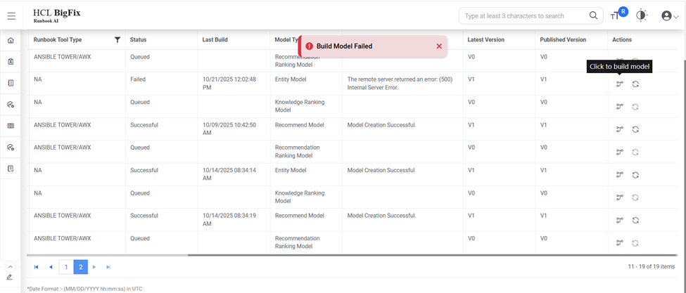

Failed to Build Model
Table 1. iRecommend: Scenario 7
Issue description Failed to build model due to incorrect URL of the server running IRecommend service.
Modules Impacted IRecommend
Probable root cause
Incorrect URL provided for the server running IRecommend service.
Figure 1. Failed to build model
Resolution Steps:
  1. Go to Advance Configuration -> Load Balancer Configuration-> Check the load balancer URL
  2. Check whether the connection is successful.
