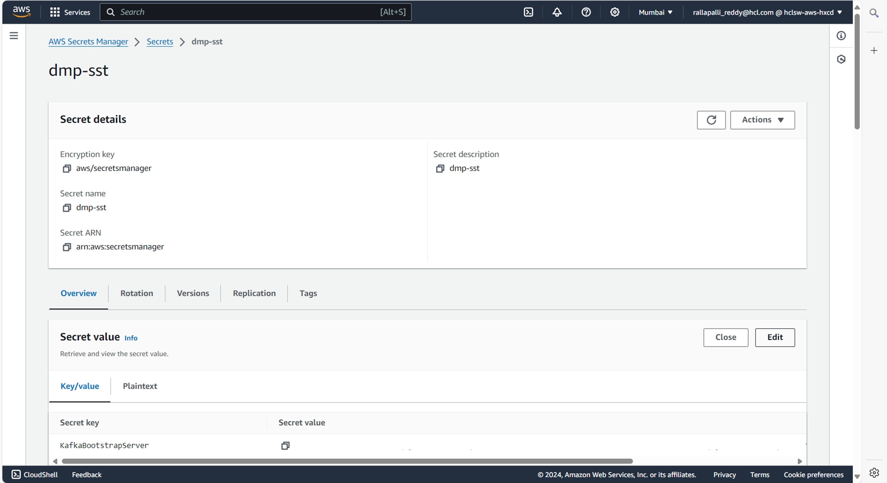

Prerequisites:
Make sure to create dmp-sst secret with required data in the AWS secret manager before deploying CDP DMP SST.
To create the dmp-sst secret in the AWS secret manager, follow the steps below:
  1. Create a dmp-sst secret sample key and value in the dmp-sst secret, and update ConfigMaps data with actual values.
      "AWSRegion": "<AWSRegion>",
      "AerospikeNamespace": "<AerospikeNamespace>",
      "AerospikeServerAddress": "<AerospikeServerAddress>",
      "AerospikeServerPort": "<AerospikeServerPort>",
      "AerospikeTTL": "15552000",
      "AerospikeTimeOut": "10000",
      "AlertEmail": "",
      "AlertFromEmail": "",
      "CookieCacheThreshold": "60",
      "DbDriver": "<DbDriver>",
      "DbHost": "<DbHost>",
      "DbPassword": "<DbPassword>",
      "DbPort": "<DbPort>",
      "DbUrl": "jdbc:mariadb://<ip:port>/dbName",
      "DbUsername": "<DbUsername>",
      "GraphDBEnable": "false",
      "GraphDBEndpoint": "<GraphDBEndpoint>",
      "GraphDBPort": "<GraphDBPort>",
      "HBaseDBEnable": "false",
      "HbaseZookeeperClientPort": "",
      "HbaseZookeeperQuorum": "",
      "KafkaBootstrapServer": "<KafkaBootstrapServer>",
      "KafkaConsumerGroup": "<dmp-sst-kafka-k8>",
      "KafkaPassword": "<KafkaPassword>",
      "KafkaProducerHostName": "<KafkaPassword>",
      "KafkaProducerTopic": "<dmp_sst_rt_profile>",
      "KafkaProfileProducerTopic": "<dmp_sst_profile>",
      "KafkaTopicConsumerBatchSize": "<10,10,10,10>",
      "KafkaTopicConsumerDefaultBatchTimeoutMS": "<5000,5000,5000,5000>",
      "KafkaTopicConsumerDefaultBatchTimeoutTrigger": "<60000,10000,10000,10000>",
      "KafkaTopicConsumers": "<6,6,6,6>",
      "KafkaTopicList": "<dmp_sst_nba,dmp_sst_nba_di_api,analyze_post,dmp_sst_data>",
      "KafkaUsername": "<KafkaUsername>",
      "SstApiAuthKeys": "<HdxDeMMHvUyrqlSBHyaCaQGA>",
      "TsdbHost": "<TsdbHost>",
      "TsdbPort": "<TsdbPort>",
      "ZookeeperClients": "<15>",
      "ZookeeperLockAddress": "<cdp-dmp-sst-zookeeper.cdp-dev-app:2181>",
      "ZookeeperLockAddressOld": "",
      "ZookeeperRetrySleepTime": "<1000>",
      "region": "<region>",
      "type": "<realtime>"

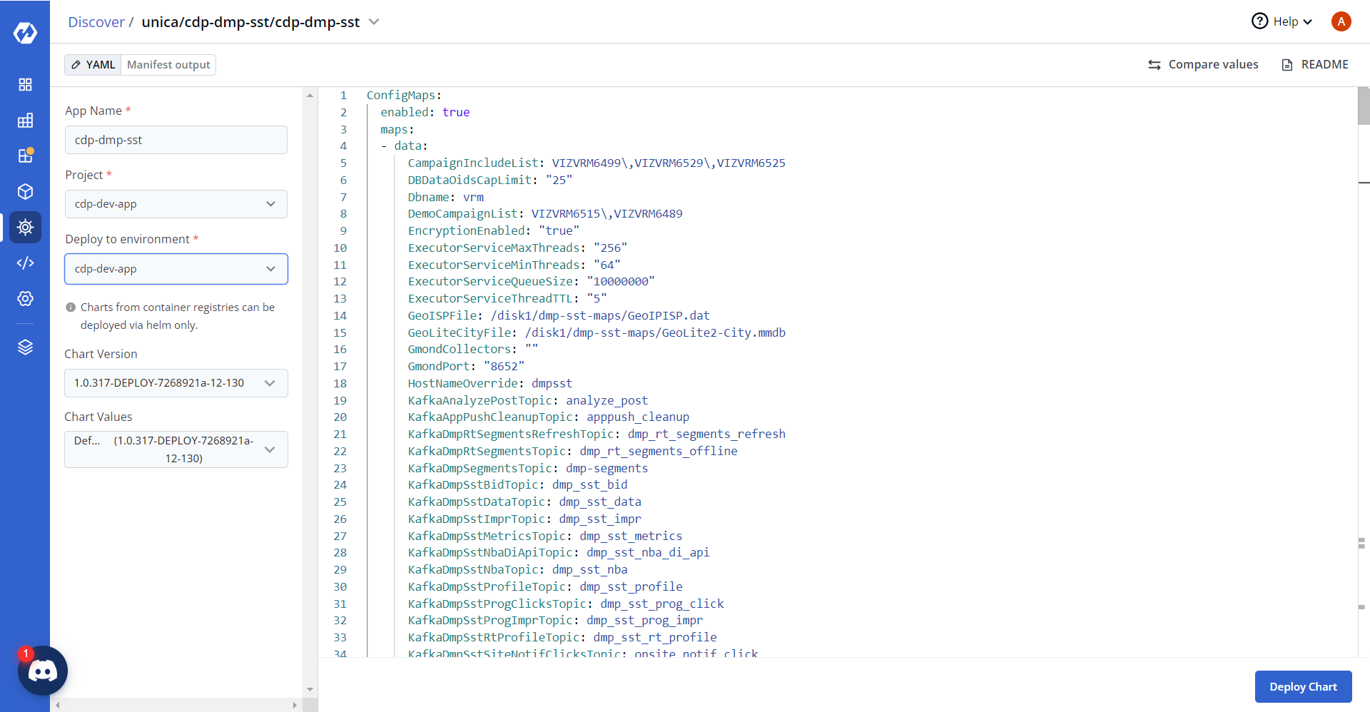

To deploy the CDP DMP SST, follow the steps below:
  1. Navigate to the Devtron Chart Store, and select the cdp-dmp-sst chart to deploy.
  2. Now, configure and deploy the CDP DMP SST charts.
  3. In the YAML section, update the ConfigMap using below details, and deploy the charts.
    SSTExecutorServiceMinThreads: "<SST_EXECUTOR_MIN_THREADS>"
    SSTExecutorServiceMaxThreads: "<SST_EXECUTOR_MAX_THREADS>"
    SSTExecutorServiceThreadTTL: "<SST_EXECUTOR_THREAD_TTL>"
    SSTExecutorServiceQueueSize: "<SST_EXECUTOR_QUEUE_SIZE>"
    SRExecutorServiceMinThreads: "<SR_EXECUTOR_MIN_THREADS>"
    SRExecutorServiceMaxThreads: "<SR_EXECUTOR_MAX_THREADS>"
    SRExecutorServiceThreadTTL: "<SR_EXECUTOR_THREAD_TTL>"
    SRExecutorServiceQueueSize: "<SR_EXECUTOR_QUEUE_SIZE>"
    ExecutorServiceMinThreads: "<EXECUTOR_MIN_THREADS>"
    ExecutorServiceMaxThreads: "<EXECUTOR_MAX_THREADS>"
    ExecutorServiceThreadTTL: "<EXECUTOR_THREAD_TTL>"
    ExecutorServiceQueueSize: "<EXECUTOR_QUEUE_SIZE>"
    MaxEventBatchLag: "<MAX_EVENT_BATCH_LAG>"
    SRMaxEventBatchLag: "<SR_MAX_EVENT_BATCH_LAG>"
    MaxBatchExecuteRetries: "<MAX_BATCH_EXECUTE_RETRIES>"
    KafkaSstEventsTopic: "<KAFKA_SST_EVENTS_TOPIC>"
    SECURITY_PROTOCOL: "<SECURITY_PROTOCOL>"
    SASL_MECHANISM: "<SASL_MECHANISM>"
    KafkaProducerEventType: "<KAFKA_PRODUCER_EVENT_TYPE>"
    KafkaProducerPoolSize: "<KAFKA_PRODUCER_POOL_SIZE>"
    KafkaDmpSstBidTopic: "<KAFKA_DMP_SST_BID_TOPIC>"
    KafkaDmpSstImprTopic: "<KAFKA_DMP_SST_IMPR_TOPIC>"
    KafkaDmpSstTaxonomyTopic: "<KAFKA_DMP_SST_TAXONOMY_TOPIC>"
    KafkaDmpSegmentsTopic: "<KAFKA_DMP_SEGMENTS_TOPIC>"
    KafkaDmpRtSegmentsRefreshTopic: "<KAFKA_DMP_RT_SEGMENTS_REFRESH_TOPIC>"
    KafkaDmpSstRtProfileTopic: "<KAFKA_DMP_SST_RT_PROFILE_TOPIC>"
    KafkaDmpSstProgImprTopic: "<KAFKA_DMP_SST_PROG_IMPR_TOPIC>"
    KafkaDmpSstProgClicksTopic: "<KAFKA_DMP_SST_PROG_CLICKS_TOPIC>"
    KafkaDmpSstSiteRecoImprTopic: "<KAFKA_DMP_SST_SITE_RECO_IMPR_TOPIC>"
    KafkaDmpSstSiteRecoClicksTopic: "<KAFKA_DMP_SST_SITE_RECO_CLICKS_TOPIC>"
    KafkaDmpSstSiteNotifImprTopic: "<KAFKA_DMP_SST_SITE_NOTIF_IMPR_TOPIC>"
    KafkaDmpSstSiteNotifClicksTopic: "<KAFKA_DMP_SST_SITE_NOTIF_CLICKS_TOPIC>"
    KafkaDmpSstWebPushMetricsTopic: "<KAFKA_DMP_SST_WEBPUSH_METRICS_TOPIC>"
    KafkaDmpSstWebPushSntMetricsTopic: "<KAFKA_DMP_SST_WEBPUSH_SENT_METRICS_TOPIC>"
    KafkaDmpSstMetricsTopic: "<KAFKA_DMP_SST_METRICS_TOPIC>"
    KafkaSMSEmailMetricsTopic: "<KAFKA_SMS_EMAIL_METRICS_TOPIC>"
    KafkaWebPushCleanupTopic: "<KAFKA_WEBPUSH_CLEANUP_TOPIC>"
    KafkaAppPushCleanupTopic: "<KAFKA_APPPUSH_CLEANUP_TOPIC>"
    KafkaGeofenceTopic: "<KAFKA_GEOFENCE_TOPIC>"
    KafkaAnalyzePostTopic: "<KAFKA_ANALYZE_POST_TOPIC>"
    KafkaWhatsappSubscriptionTopic: "<KAFKA_WHATSAPP_SUBSCRIPTION_TOPIC>"
    KafkaDmpSstProfileTopic: "<KAFKA_DMP_SST_PROFILE_TOPIC>"
    KafkaSstMergeEventTopic: "<KAFKA_SST_MERGE_EVENT_TOPIC>"
    KafkaSstBlacklistEventTopic: "<KAFKA_SST_BLACKLIST_EVENT_TOPIC>"
    KafkaDmpSstNbaDiApiTopic: "<KAFKA_DMP_SST_NBA_DI_API_TOPIC>"
    KafkaDmpSstDataTopic: "<KAFKA_DMP_SST_DATA_TOPIC>"
    KafkaDmpRtSegmentsTopic: "<KAFKA_DMP_RT_SEGMENTS_TOPIC>"
    KafkaDmpSstNbaTopic: "<KAFKA_DMP_SST_NBA_TOPIC>"
    KafkaSstDemoEventsTopic: "<KAFKA_SST_DEMO_EVENTS_TOPIC>"
    DBDataOidsCapLimit: "<DB_DATA_OIDS_CAP_LIMIT>"
    MetricLoggingFrequencyMs: "<METRIC_LOGGING_FREQUENCY_MS>"
    MaxWaitForConnectionReestablish: "<MAX_WAIT_FOR_CONNECTION_REESTABLISH>"
    TSDBHostName: "<TSDB_HOST_NAME>"
    GmondCollectors: "<GMOND_COLLECTORS>"
    GmondPort: "<GMOND_PORT>"
    HostNameOverride: "<HOSTNAME_OVERRIDE>"
    MetricPrefix: "<METRIC_PREFIX>"
    GeoLiteCityFile: "<GEOLITE_CITY_FILE_PATH>"
    GeoISPFile: "<GEOISP_FILE_PATH>"
    SSTCronTime: "<SST_CRON_EXPRESSION>"
    SSTValidValuesConfig: "<SST_VALID_VALUES_CONFIG_PATH>"
    SSTValuesMappingConfig: "<SST_VALUES_MAPPING_CONFIG_PATH>"
    ValidValuesS3Path: "<VALID_VALUES_S3_PATH>"
    ValuesMappingS3Path: "<VALUES_MAPPING_S3_PATH>"
    EncryptionEnabled: "<BOOLEAN>"
    fromEmailId: "<FROM_EMAIL_ID>"
    toEmailId: "<TO_EMAIL_ID>"
    DemoCampaignList: "<DEMO_CAMPAIGN_LIST>"
    CampaignIncludeList: "<CAMPAIGN_INCLUDE_LIST>"
    Dbname: "<DATABASE_NAME>"
    mapsGenLocation: "<MAPS_GEN_LOCATION>"
    ValidValuesConfig: "<VALID_VALUES_CONFIG_PATH>"
    ValuesMappingConfig: "<VALUES_MAPPING_CONFIG_PATH>"
    mapsCronTime: "<MAPS_CRON_EXPRESSION>"
    deleteOlderBackupIntervalInDays: "<BACKUP_RETENTION_DAYS>"
    KMS_IMPLEMENTATION: "<KMS_IMPLEMENTATION>"
    LOG_LEVEL_APP: "<LOG_LEVEL_APP>"
    LOG_LEVEL_ROOT: "<LOG_LEVEL_ROOT>"
    ArrayDefaultLimit: "<ARRAY_DEFAULT_LIMIT>"
    ArrayMaxLimit: "<ARRAY_MAX_LIMIT>"

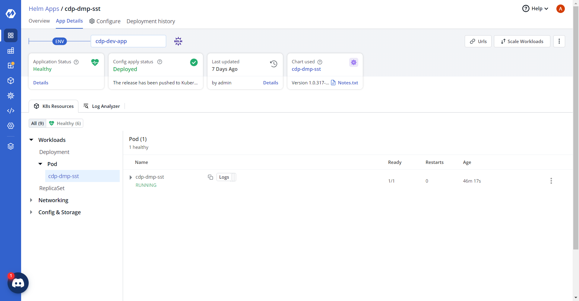

  4. On successful deployment, validate the deployment as shown below.
