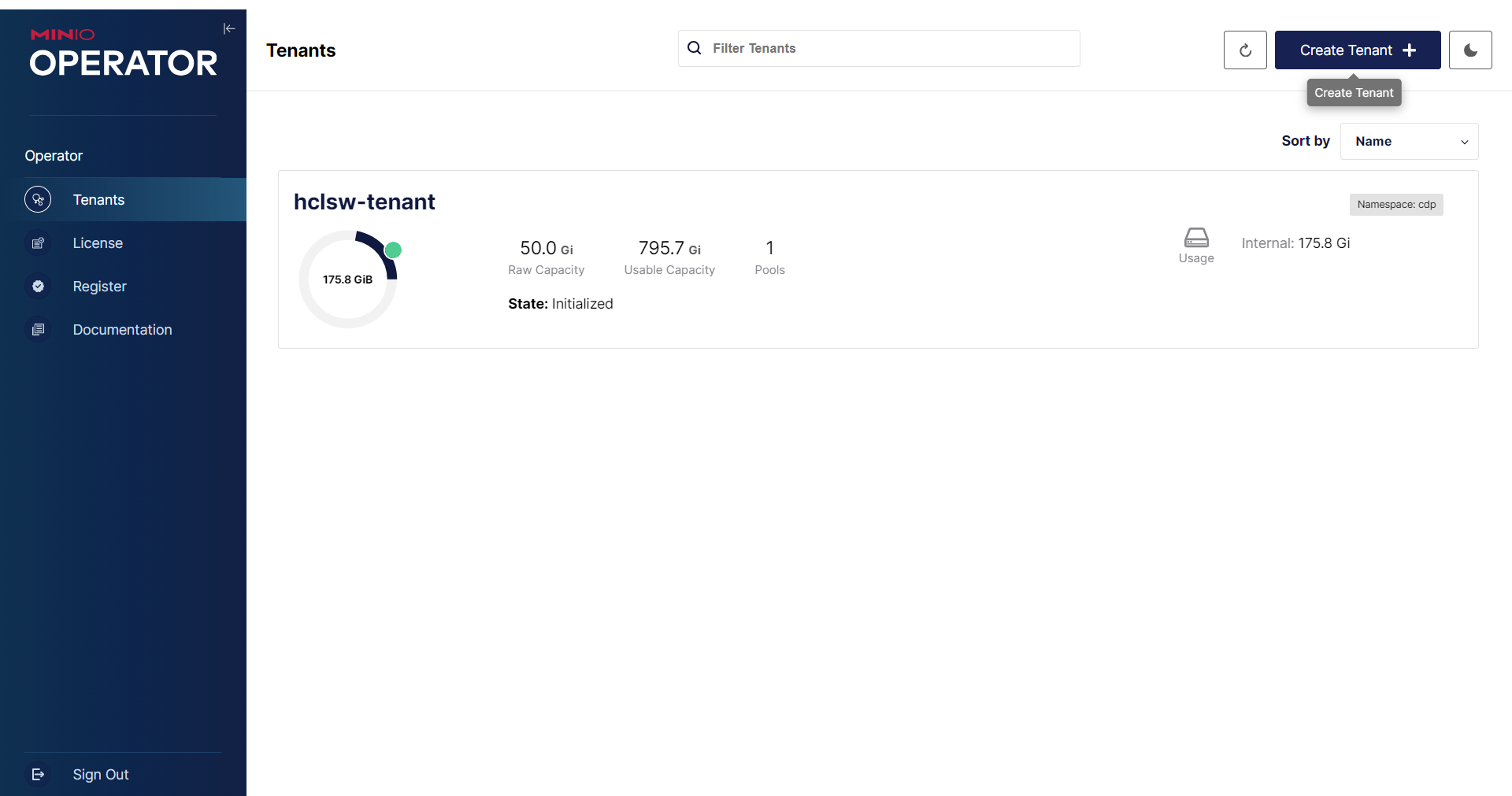

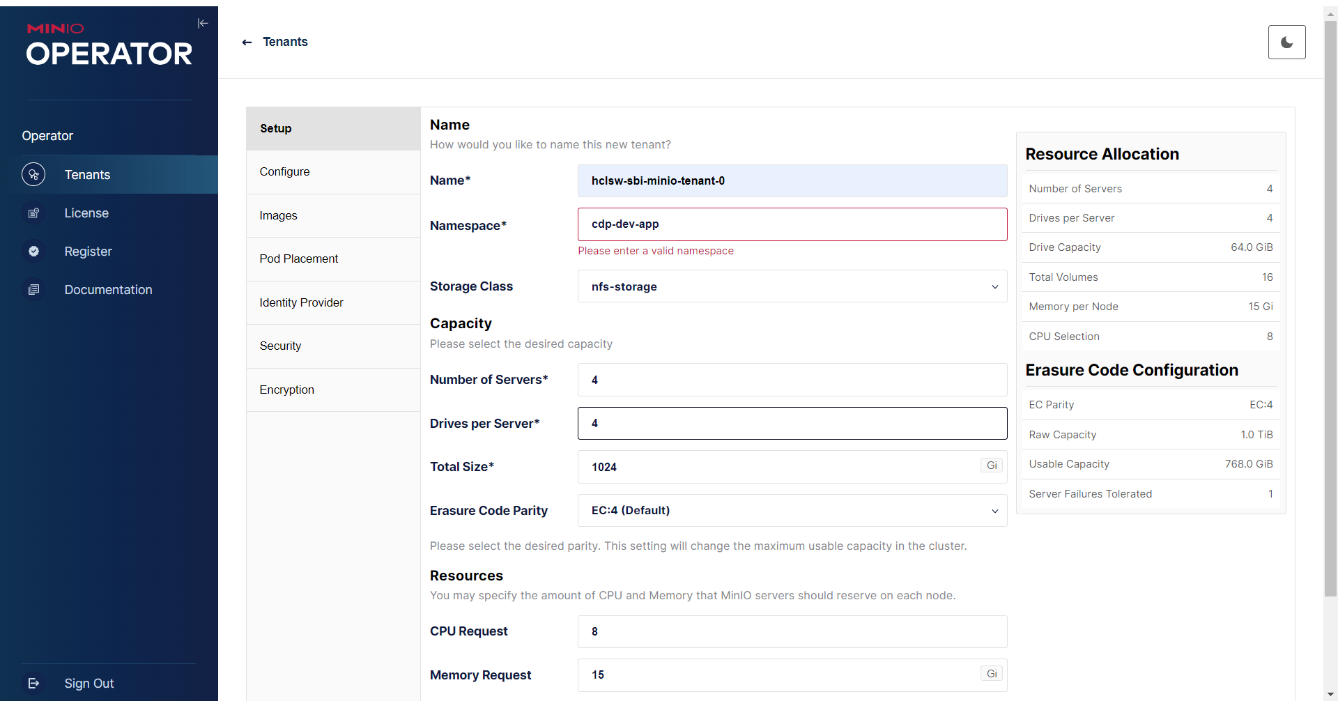

- In the MinIO portal, select Tenant, and click Create Tenant.
- In the Tenants page, click Setup, and enter tenant name and other
details.

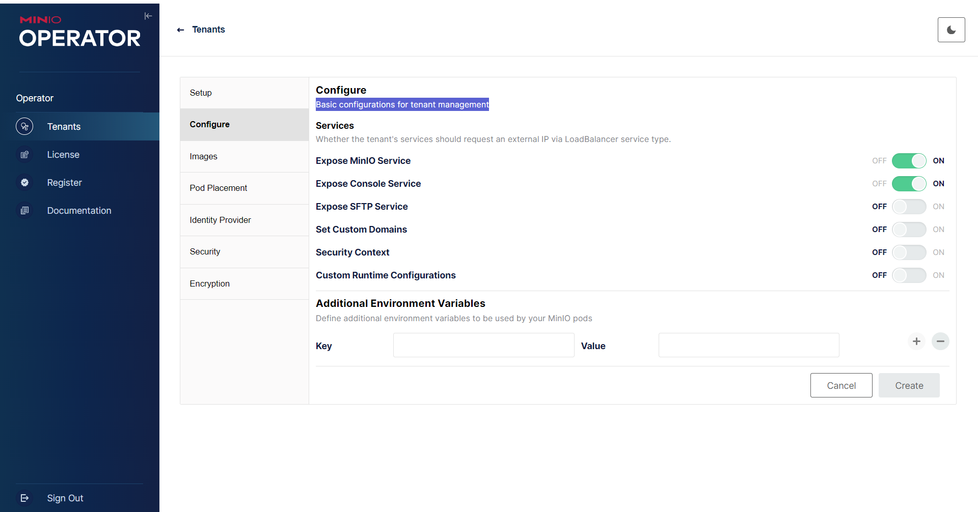

- Now, click Configure, and set the basic configurations.

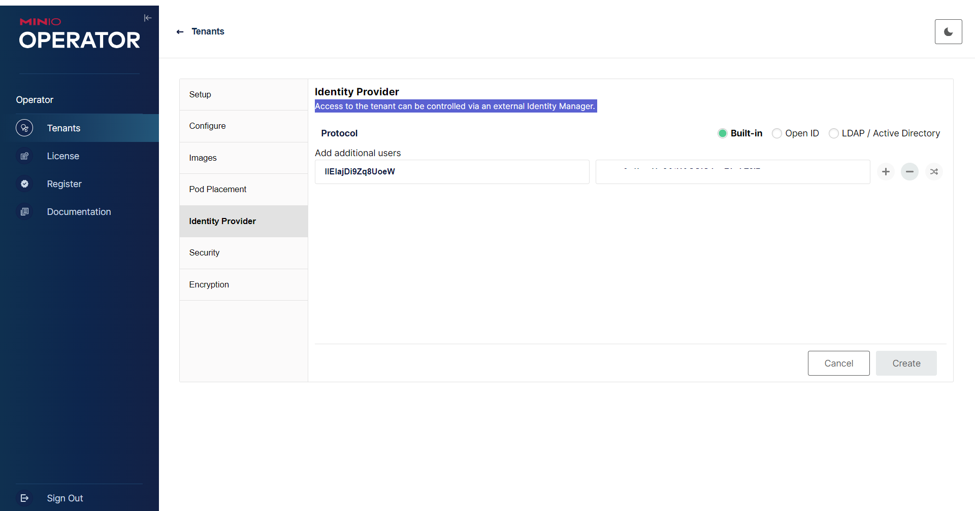

- Similarly, configure Identity Provider, Security and Encryption.

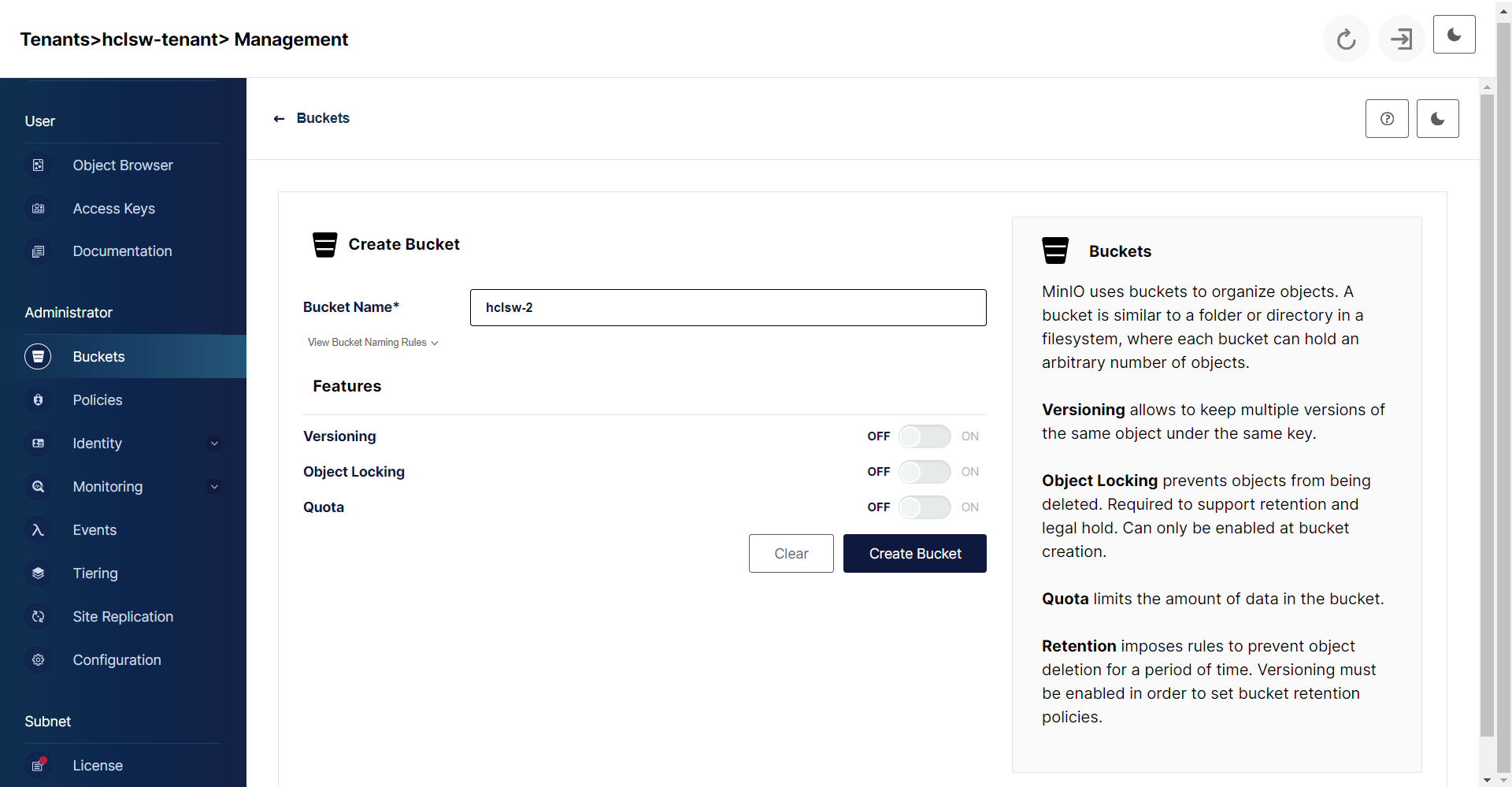

Creating Bucket in Management Console
- Open the Management console using console URL.
- In the console, Under Administrator section, click Buckets and enter bucket details.
Click Create Bucket to create the new bucket.

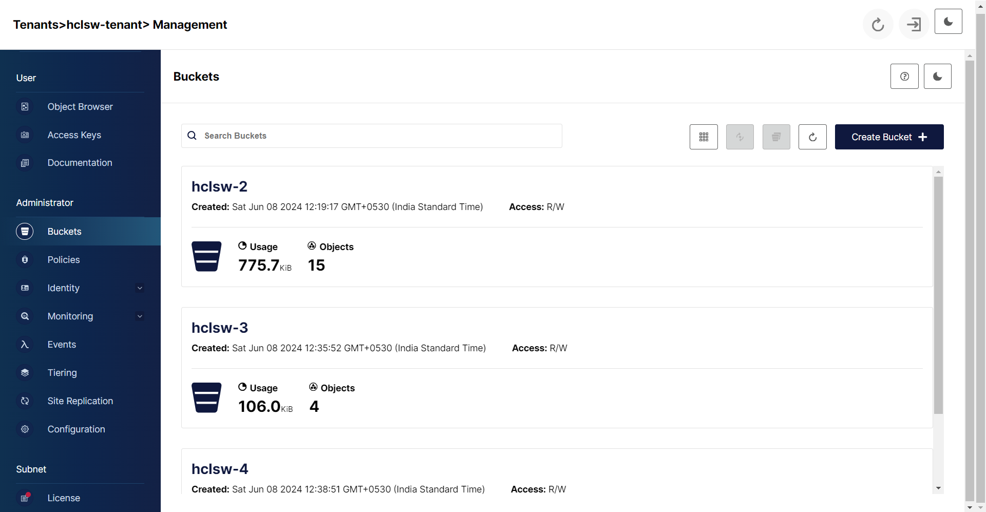

- You search for the existing buckets in the search bucket option as shown below.
