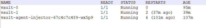

helm upgrade --install vault hashicorp/vault --namespace vault --set "global.openshift=true" --set "server.image.repository=docker.io/hashicorp/vault" --set "injector.image.repository=docker.io/hashicorp/vault-k8s" -f /<path-to-your-vault-override-values-file>/vault-override-values.yaml --debug - On successful installation of the vault, you can verify the installation using the below
command.
oc get pods --namespace vaultNote: After installation, make sure to unseal the vault as shown below. Otherwise, the pods will keep restart.
