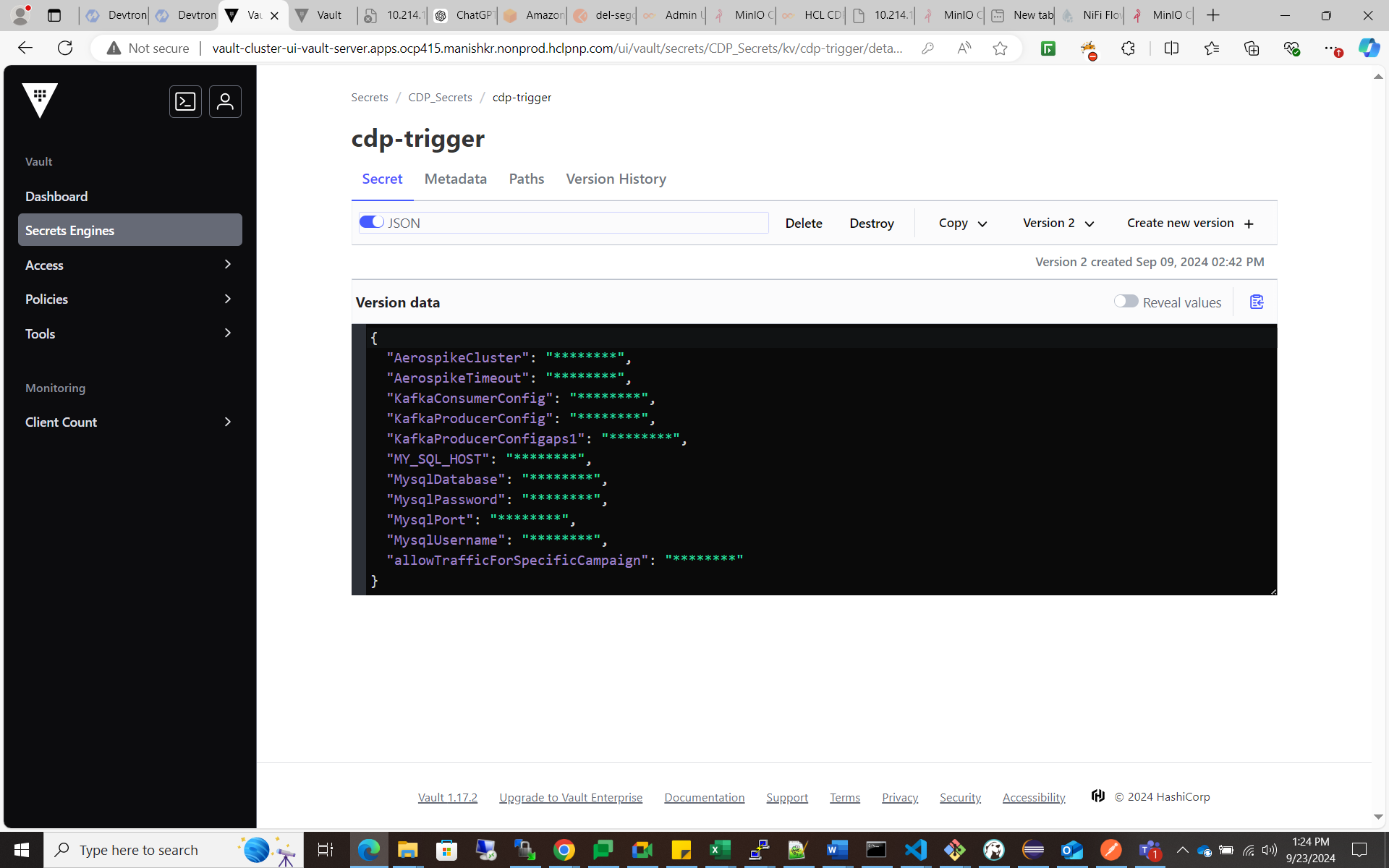

Make sure to create cdp-trigger secret in HashiCorp vault before deploying CDP Trigger.
To create CDP Trigger secret in the HashiCorp vault, follow the steps below:
- Create a cdp-trigger secret sample key and value, and update the actual values as shown
below.
{ "AerospikeCluster": "<AerospikeCluster>", "AerospikeTimeout": "10000", "KafkaConsumerConfig": "<KafkaConsumerConfig>", "KafkaProducerConfig": "<KafkaProducerConfig>", "KafkaProducerConfigaps1": "<KafkaProducerConfigaps1>", "MY_SQL_HOST": "<MY_SQL_HOST>", "MysqlDatabase": "<MysqlDatabase>", "MysqlPassword": "<MysqlPassword>", "MysqlPort": "<MysqlPort>", "MysqlUsername": "<MysqlUsername>", "allowTrafficForSpecificCampaign": "false" } - Create a Kubernetes Secret with Vault credentials to fetch the secrets from the

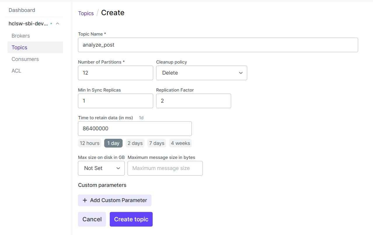

- Create required Kafka topics before deployment. A sample Kafka topic configuration is
shown below.

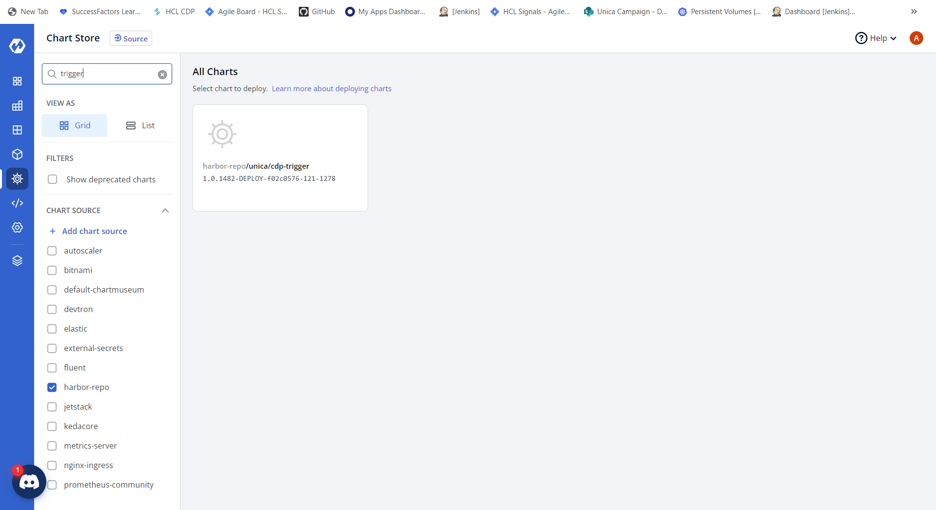

- Navigate to the Devtron Chart Store, and select cdp-trigger chart to deploy.
- Now, configure and deploy the cdp-trigger charts.

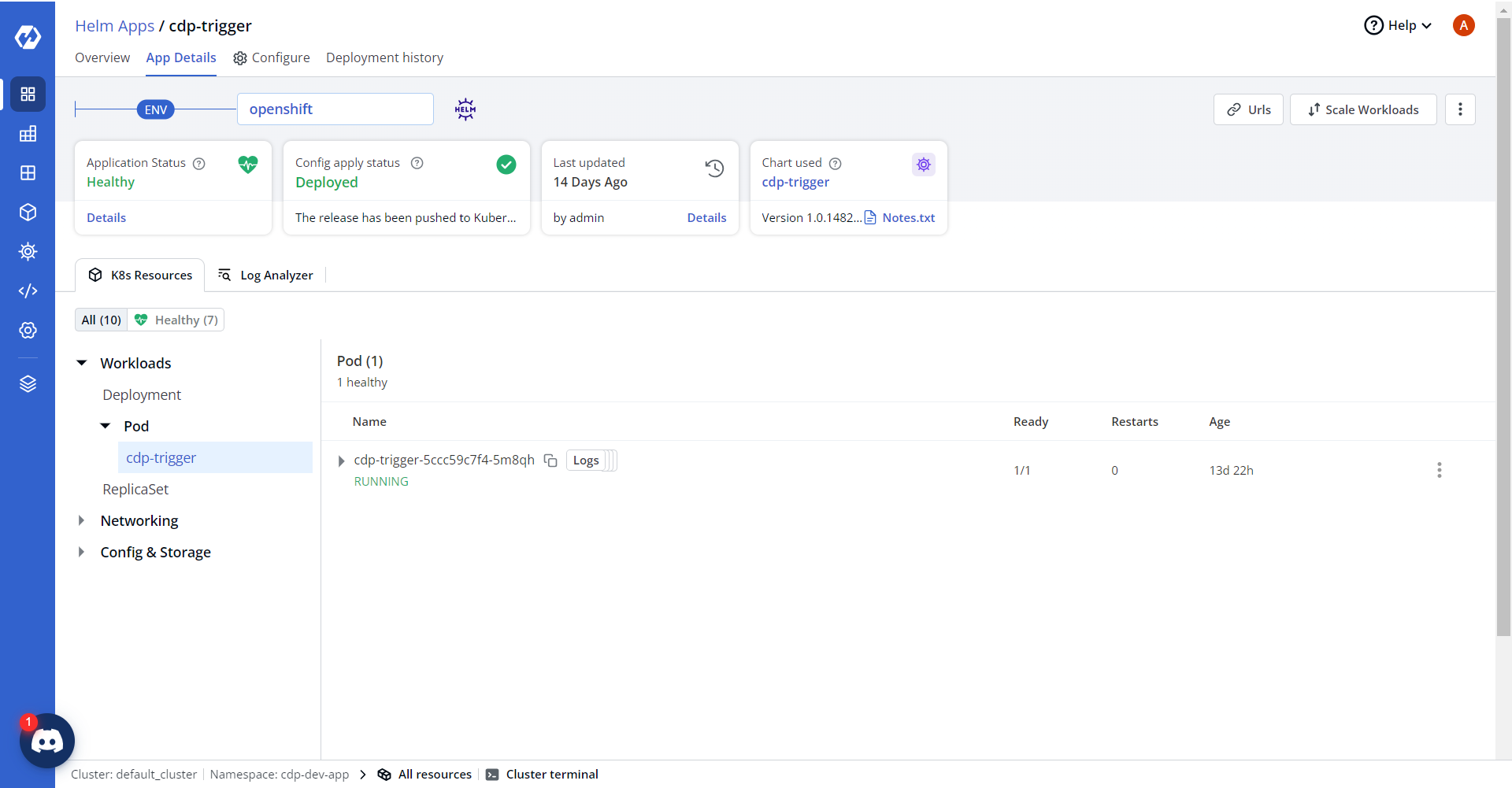

- On successful deployment, validate the deployment as shown below.
