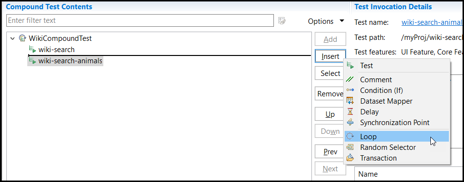

Select the wiki-search-animals test in the Compound Test
Contents panel, and then click .
The New Loop dialog is displayed.
Click Yes to move the wiki-search-animals
test to a new loop.
The wiki-search-animals test is displayed within a loop in the Compound Test Contents panel.

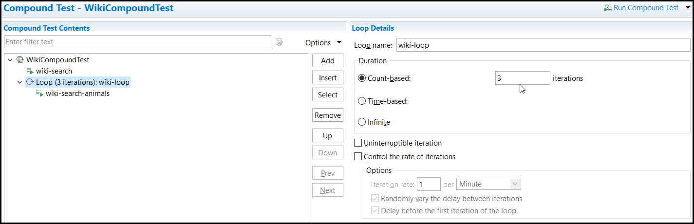

- Enter wiki-loop as the loop name in the Loop Details panel.
Select the Count-based option, and then enter 3
in the iterations field.
- Click to save the changes.

The compound test run begins. The wiki-search-animals test runs three times while fetching the data from the AnimalsDataset dataset.
