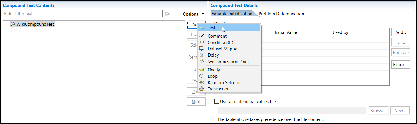

  3. Click Add in the Compound Test Contents panel, and then click Test.
    Image of the Compound Test Contents panel

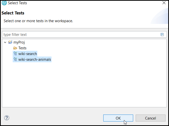

    The Select Tests dialog is displayed.
  4. Select the wiki-search and wiki-search-animals tests from the myProj folder, and then click OK.
    image of the Select Tests dialog

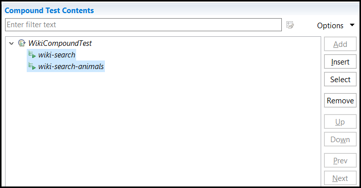

    The wiki-search and wiki-search-animals tests are displayed within the WikiCompoundTest test in the Compound Test Contents panel.
  5. Click File > Save to save the changes.
