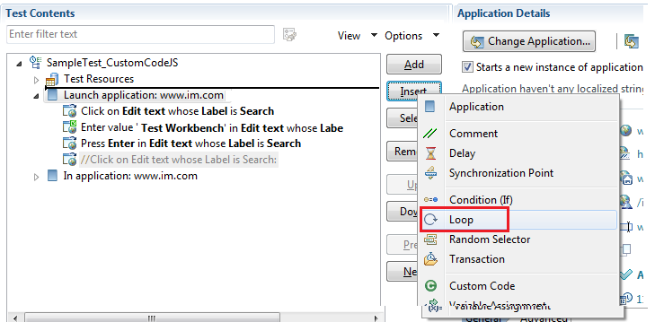

To add a loop to the Launch App or In App nodes:
  1. In the Test editor, click the Launch Application or In Application node.
  2. Click Insert > Loop.
    Add a Loop
    In the confirmation dialog, click Yes.
