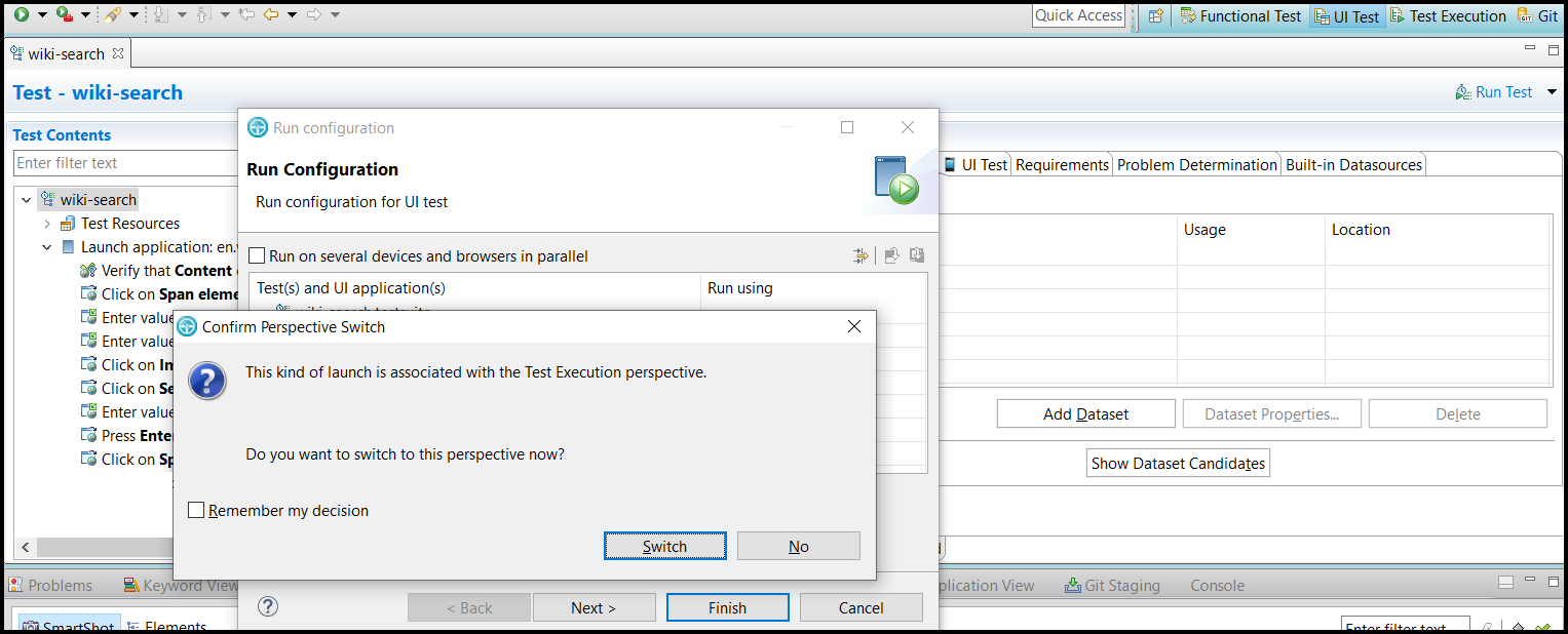

Click Run Test in the test editor window of the UI
Test perspective.
The Confirm Perspective Switch dialog is displayed.
- Click Switch to run the test in the Test Execution perspective.

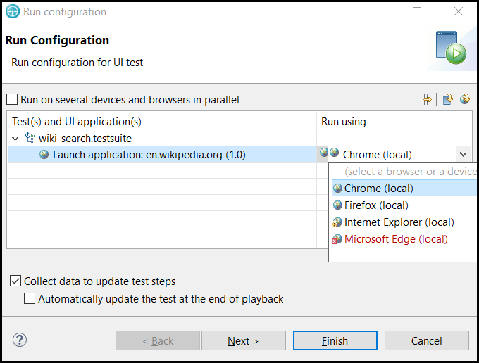

Select Chrome in the Run Configuration
dialog.
Click Finish.
The test run begins.
