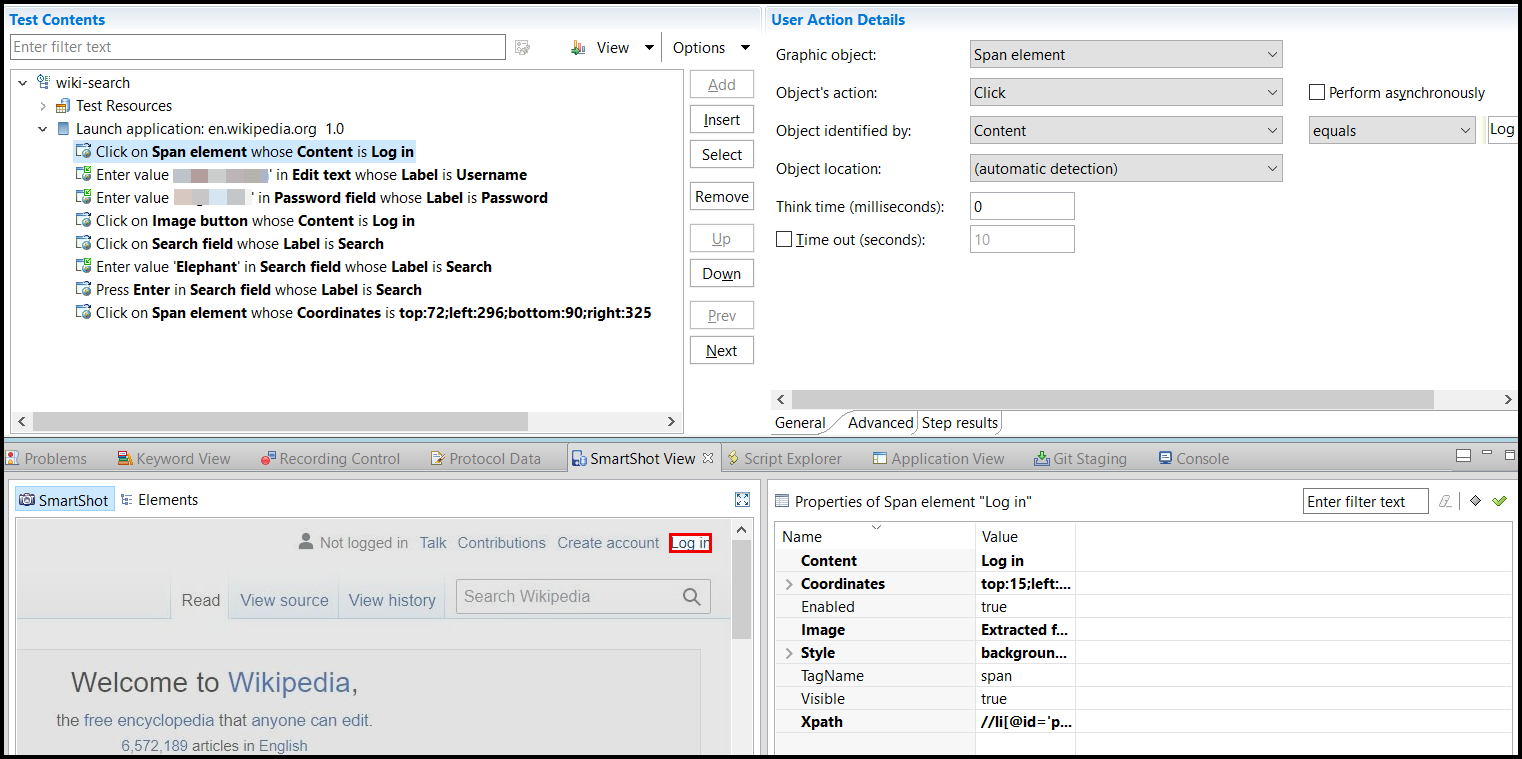

  1. Select the test step that corresponds to the first click action that you performed on the Log in link on the Wikipedia website.
    The screen capture and properties for the click action are displayed in the SmartShot View tab.
    Verify whether the click action is highlighted in the screen capture that is displayed in the SmartShot subtab.

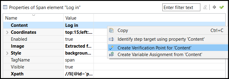

  2. Right-click the row with Log in in the Properties panel of the SmartShot View tab.
    Test Editor Properties
  3. Select Create verification point for ‘Content'.

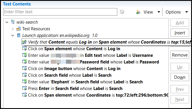

    A verification point is created for the selected click action and the verification step is added in the Test Contents panel with the icon.
    VP step
  4. Click File > Save to save the changes.
