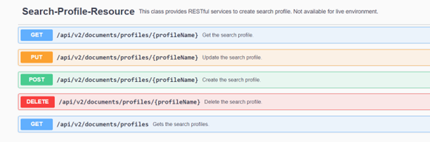

    ZooKeeper stores named profiles in one of its nodes. You can create, update, delete the profiles, and get profiles using the profiles endpoint of the Query service. The endpoint for the profile is:
    https://data_environment_hostname:30921/search/resources/api/v2/documents/profiles/profileName
    No container needs to be restarted after you add a profile using this endpoint.
    For the full REST API specification, see the Query REST API.
