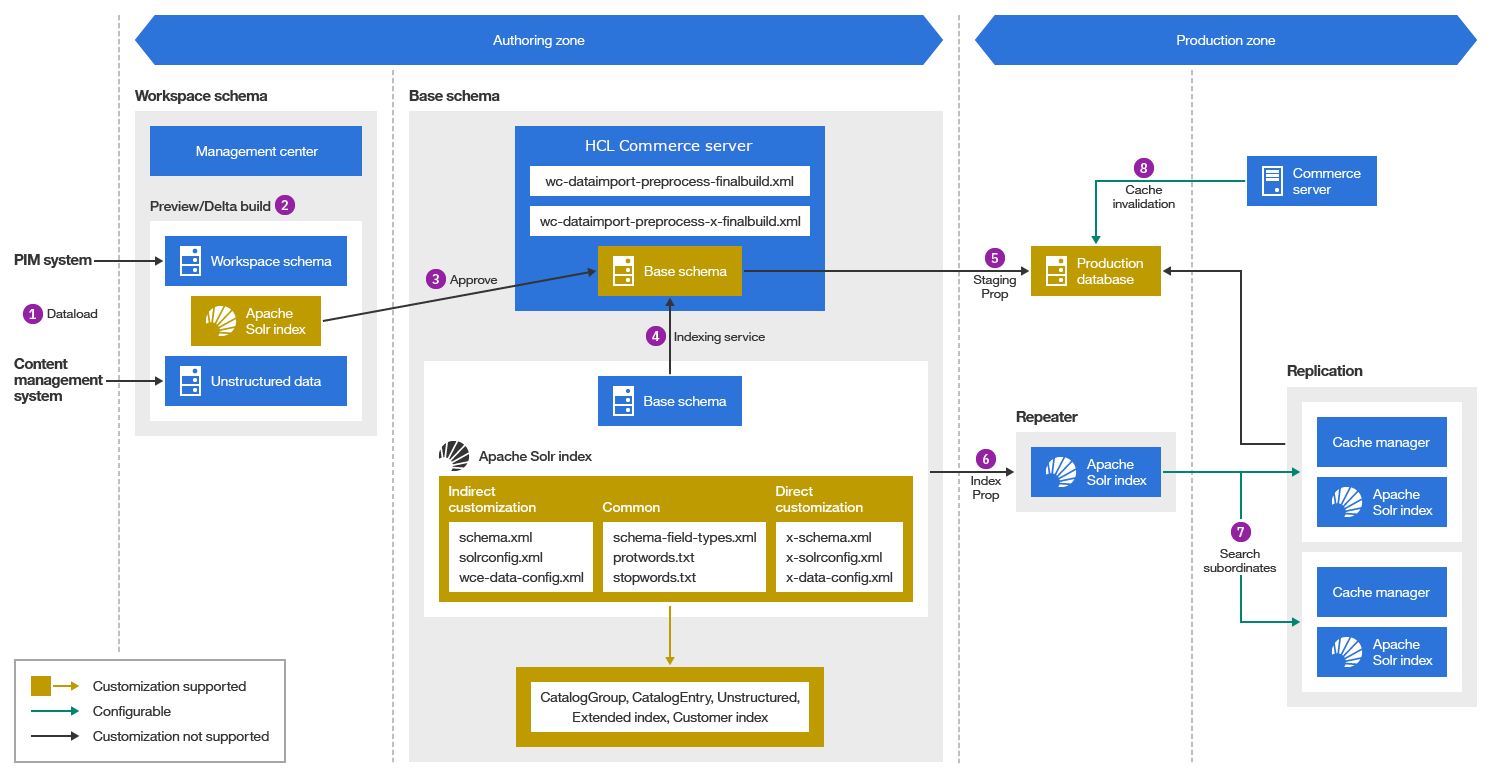

There are eight steps to the indexing lifecycle itself, as indicated in the following figure.
1. Data Load - External system
PIM: Product Information Management or CMS: A Content Management System, usually Websphere Content Hub is used to load data into the Commerce authoring database.
While Data Load saves, for example, a new season's products into the workspace schema database, it also records the new season's products' primary key into search specific delta tables. Later, when buildIndex is running, it will check which data was added, changed or deleted in the workspace schema from this specific delta table. It will then build the new season's products from the workspace database into workspace index.
You can customize Data Load by defining a new mediator. buildIndex can also be customized to build additional information into the workspace index.
2. Preview
After the workspace index core has synchronized with the workspace schema database, your workspace administrators can make changes to the new season products. They can preview new as-yet unapproved data, categories and content on the storefront. The event consumer analyzer built into each catalog will add the data changes coming from the Management Center into each search-specific delta table. The buildIndex process again reads from each delta table and builds the data into a workspace index core.
3. Approve
When the workspace administrator is satisfied with the catalog data, they approve and publish the workspace. The workspace schema data will be committed into the base schema database, and the workspace index will be committed into the base index.
4. Indexing service
The indexing service will first run the preprocess script located in the Transaction server to flatten the data into a temporary table or view. Then, the service runs DataImportHandler to import data from the temporary table or view into the index.
In the base schema, by default there are four types of index: CatalogEntry, CatalogGroup, Unstructured index, and extended index (for Price and Inventory). The index can be customized by adding a new index. You can influence the behaviors of these indexes by customizing x-schema.xml, x-solrconfig.xml, and x-data-config.xml. Additional configuration files such as passwords.txt permit fine-grained control over the indexing of search terms. If you require deeper level customization, for example complete replacement of schema.xml, solrconfig.xml or data-config.xml, this could be achieved by leveraging the SRCHCONF and SRCHCONFEXT tables.
5. Stagingprop
When everything is ready in the authoring environment, the database is propagated to the live instance.
6. Indexprop
Data replication is done by the Search administration service.
7. Replication
After the index is ready on the repeater, the Solr engine's built-in replication process will replicate the index from the repeater to subordinate nodes. You can configure whether to replicate an external file or schema file, or whether to force a health check after replication. You can also customize on top of the Search-provided replication handler.
8. Cache Invalidation
A data cache is enabled on the Search server. It is used mainly to cache three types of data: database centralized operations, such as B2B entitlement information or facet configuration; search rule lookups that need a callback to the Transaction server; and category hierarchy information that is created by centralized index access. When a facet or entitlement related database, search rule or index is changed, invalidation is triggered to invalidate the data cache and storefront fragment cache. Normally entitlement, facet and search rule cache invalidation is triggered by defining a database trigger; category hierarchies are invalidated by leveraging the CACHEIVL table. Normally IndexProp will register cache invalidation events into the database in the CACHEIVL table. Later, every search REST call will call the cache manager in the Search server to read CACHEIVL and issue invalidation.
Note: While the Search and Transaction servers do invalidation using the CACHEIVL table, the Store server issues invalidations by subscribing to a Kafka message.
