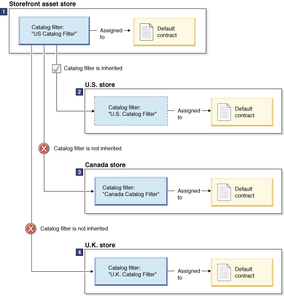

Extended Site Catalog Filter scenario
1 Storefront Asset Store
Initially, the sales manager creates a catalog filter called US Catalog Filter and assigns it to the default contract for the storefront asset store. Any extended site stores that do not have their own catalog filter inherit this US Catalog Filter catalog filter. The steps that are used to achieve this goal:
  1. In Commerce+ Accelerator:
    • Assign the US Catalog Filter catalog filter to the storefront asset store contract.
  2. On the storefront:
    • Verify that all products are shown.
2 US Store
The US store inherits the US Catalog Filter catalog filter from the storefront asset store, so the US store does not require its own catalog filter. In this case, there is no catalog filter that is assigned to the default contract for the US store. When customers view catalog entries on the US store, the US Catalog Filter catalog filter determines the catalog entries that they can see and purchase.
3 Canada Store
The catalog entries in the Master Cylinders category are unavailable in Canada, so the sales manager must exclude the category from the Canada store. This means that the default contract for the Canada store must be assigned its own catalog filter, rather than inheriting the US Catalog Filter catalog filter from the storefront asset store. The steps that are used to achieve this goal:
  1. In the Catalog Filter and Pricing tool:
    • Include the entire catalog in the catalog filter.
    • Exclude the Master Cylinders category from the catalog filter.
  2. From Commerce+ Accelerator:
    • Assign the Canada Catalog Filter catalog filter to the default contract for the Canada store.
  3. On the storefront:
    • Verify that the Master Cylinders category is not displayed.
    • Verify that all other products are still shown.
4 UK Store
Catalog entries from Manufacturer A and Manufacturer B are unavailable in the UK, so the sales manager wants to exclude all the catalog entries that belong to Manufacturer A and Manufacturer B from the UK store. To do so, the sales manager creates a catalog filter called UK Catalog Filter that adds property conditions to exclude catalog entries from both manufacturers. The sales manager then assigns the UK Catalog Filter catalog filter to the default contract for the UK store. When customers view catalog entries on the UK store, the UK Catalog Filter catalog filter determines the catalog entries that they can see and purchase. The steps that are used to achieve this goal:
    • Create a condition group against the entire catalog.
    • In the condition group, create a property condition that excludes Manufacturer A and Manufacturer B.
    • Assign the UK Catalog Filter catalog filter to the default contract for the UK store.
    • Verify that none of the catalog entries from Manufacturer A or Manufacturer B are displayed.
