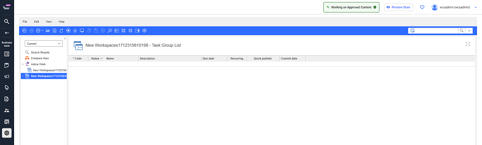

Holiday Season Promotions workspace view in the Workspace Management tool

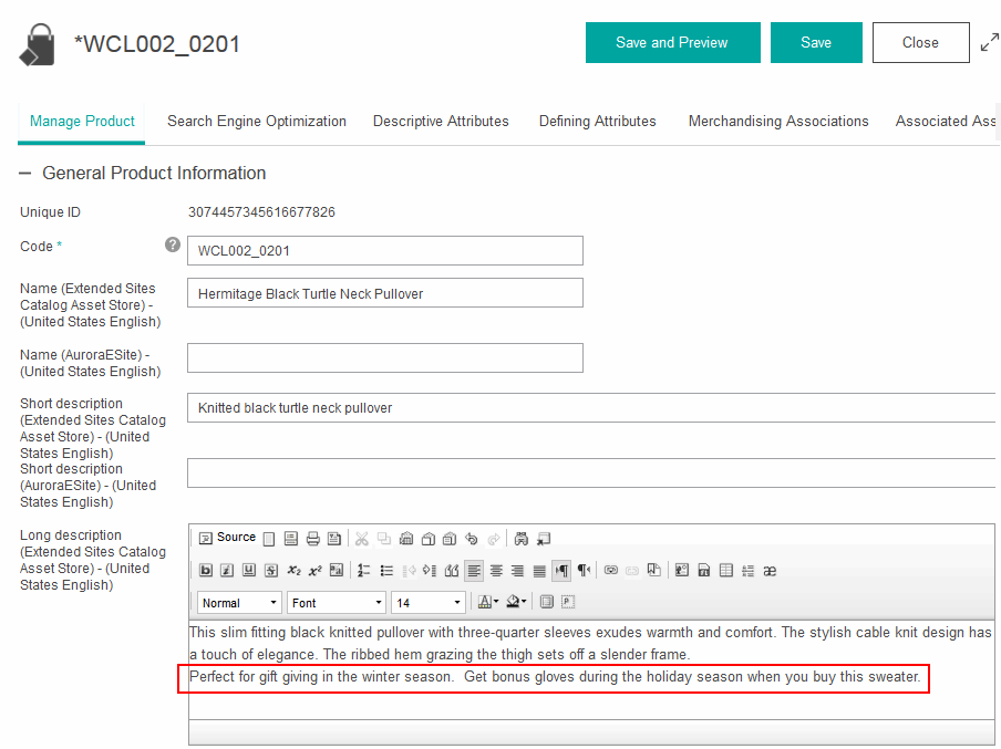

While you are working on the "Product update" task within the "Holiday Season Promotions" workspace, the description of product "WCL002_0201" is updated to highlight the holiday promotional information.
Editing the product for holiday season changes

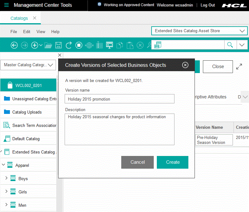

The Task Group Approver receives an email that indicates that the "Holiday product updates" task group is ready for approval. Before granting approval, the Task Group Approver reviews the changes that are made and confirms that they are correct. The Task Group Approver uses the store preview function to check the store. When the Task Group Approver is satisfied that the changes are correct, the Approver creates a version of product "A0000552" that contains the holiday changes for future reference.
New version created that includes holiday season changes

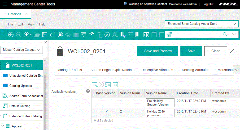

Once the holiday season changes are in place, the Workspace Content Contributor can begin the process to roll back these changes in the "Rollback product information" task that is targeted for a future date. The Contributor can display the versions available and view details of each version of the object within the workspace. All versions of the object are shown within the workspace regardless of where the version was created (either workspace or approved content).
List of available versions for product "A0000552":
Available versions of product "A0000552"

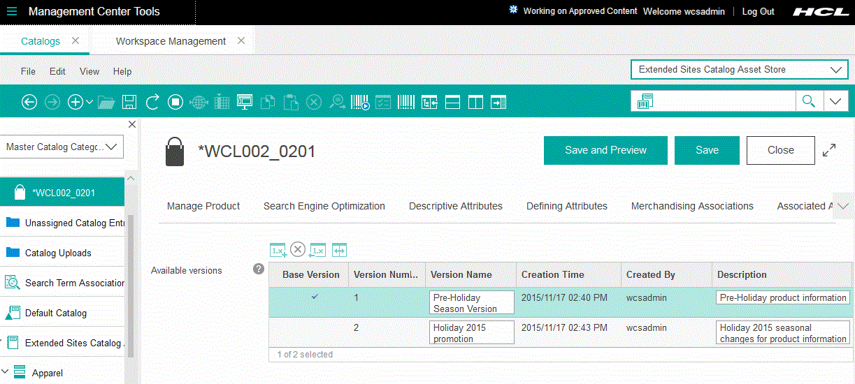

Version details of pre-holiday season changes:
Details of pre-holiday season version within the workspace
Since the product "WCL002_0201" is not locked, the Workspace Content Contributor restores the pre-holiday season version in the "Rollback product information" task. Once the version is restored, the workspace approval can be completed to move object to the approved content area. The following screen capture shows the list of versions after restore:
List of versions after restore
